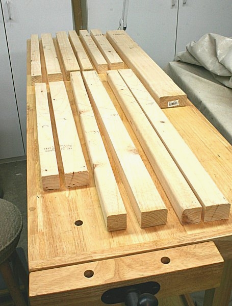

Managed to get my 2 x 4's rough cut to length and finish rip cut. First time cutting softwood. Like Heath said when he cut softwood for the first time, it was like 'cutting through warm butter'.
[ATTACH]9094[/ATTACH]
The plan called of 1-1/2" wide and 2" wide boards but since the 2x4 is only 3-1/2", I split the different to account for the kerf and ripped the boards 1-7/16" wide and 1-15/16" wide. That will work fine.
Next step.....final length cuts, and cut all the lap joints.

Good Start! Do NOT lose track of which side is narrower(1 7/16) in the subsequent process(es)! It is the face opposite the sawn face ya need to keep track of(the saw tracks are obvious on the sawn face).mickyd wrote:Managed to get my 2 x 4's rough cut to length and finish rip cut. First time cutting softwood. Like Heath said when he cut softwood for the first time, it was like 'cutting through warm butter'.

Agree. With all the stock that is now 1-7/16" x 1-1/2" (vs. spec of 1-1/2 square) , I thought of getting some more reps on on my Pro-Planer and making them all 1-7/16" square. They are used for the stiles and rails on the doors. That way, I don't have to keep track of orientation.JPG40504 wrote:Good Start! Do NOT lose track of which side is narrower(1 7/16) in the subsequent process(es)! It is the face opposite the sawn face ya need to keep track of(the saw tracks are obvious on the sawn face).

Did you notice how clean those 2 by's are? I must have sorted through 30 or 40 to get those 2. Only a few small knots and relatively straight.JPG40504 wrote:Ya gonna rip them with a laser??? I do not see kerf waste. If yer thinking bandsaw, go slow and watch(closely) for blade 'drift'.
BTW yer gonna buy 2-2x4-8' at 5 1/3 bf each = 10 2/3 bf @ 0.56 = $5.97 You may/should consider a more gooder grade of 2x4!

Good decision! Alter the 'plans' accordingly!!!!:Dmickyd wrote:Agree. With all the stock that is now 1-7/16" x 1-1/2" (vs. spec of 1-1/2 square) , I thought of getting some more reps on on my Pro-Planer and making them all 1-7/16" square. They are used for the stiles and rails on the doors. That way, I don't have to keep track of orientation.
