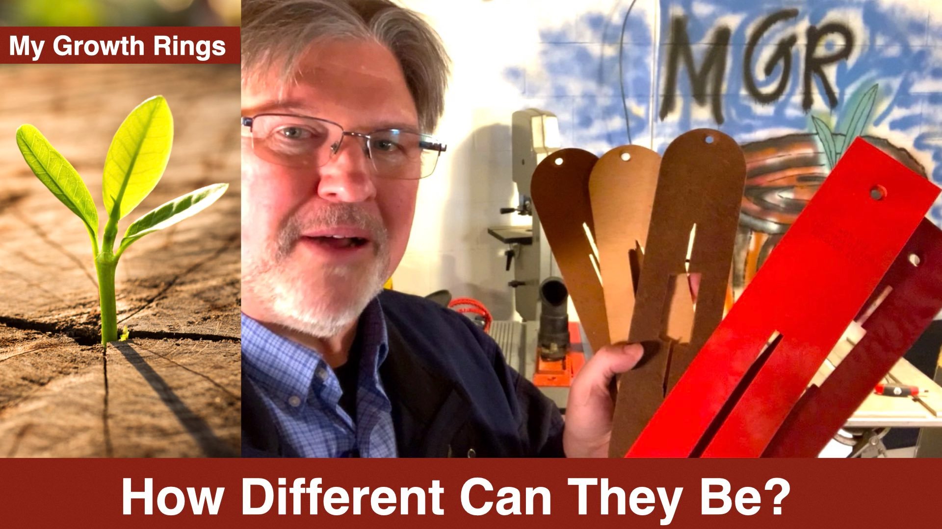

Since 1954 insets in the main table of Shopsmith multipurpose tools have had a unique shape that allows them to be quickly adjusted flush with the transition from and to the table itself. Why don't other table saws have this feature? Because you only feed stock one direction on a table saw (Unless you are Izzy Swan!) and it's an expensive feature to produce.
Check it out here: https://youtu.be/zlKGj35DEVk

Scott,
A great overview of how the Table Inserts have been designed. Also, a good reminder of how to properly install them since I know I don't always think about that when changing Inserts on the Table.
Was the Table Insert for the 510/505 having been designed to go to the end of the table an idea borrowed from the Mark 2 or simply a coincidence? Surprisingly even the Mark 2 Table Insert is bowed and the nubs are actually in the Table recess. Just some things I noticed since I am in the process of restoring the two Mark 2's I have.
Re: My Growth Rings with Scott Markwood
I think it is a matter of $$$ since it only requires rounding the leading end.

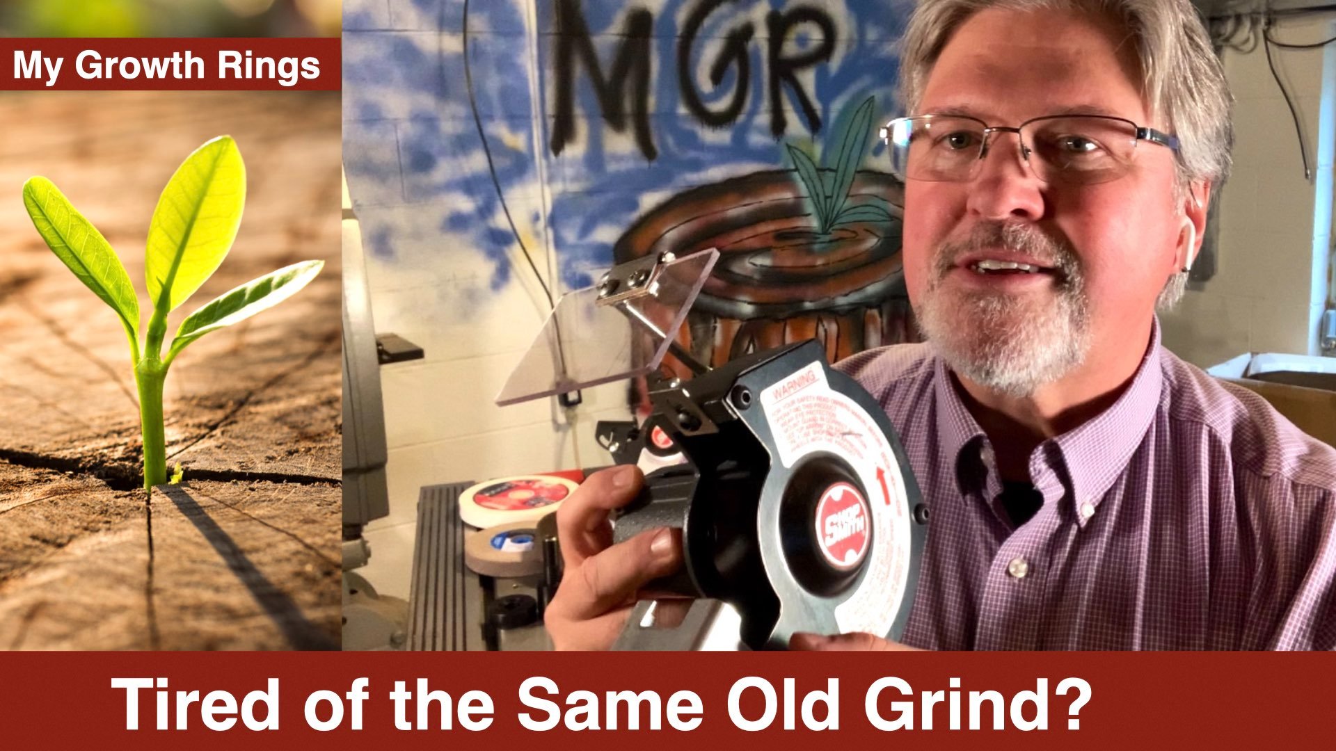

Grinding Wheels on your Shopsmith? SURE! Grinding Wheel Guard 1 & 2
Shopsmith Inc. marketed two different versions of the "Grinding Wheel Guard" (GWGI & GWGII) and for quick stock removal a bonded abrasive wheel (grinding wheel) is tough to beat. In this video I'll show you the difference between the two guards and show you how to set them up.
I have the Grinding Wheel Guard II so I didn't know what the difference was between the two. Thanks Scott.
Buy the way I couldn't find the link for the video in the post above and had to look for it. I found it at
https://www.youtube.com/watch?v=4NrOdwiAqnQ

How did I miss that?!! Thanks, Russ!chapmanruss wrote: Tue Jun 07, 2022 12:17 pm Buy the way I couldn't find the link for the video in the post above and had to look for it. I found it at
I no longer have a bench grinder but occasionally need the use of one. The GWG would be a good option for me and what I need. I did look on Ebay and also Shopsmith's website, but no luck there. Maybe I missed it in the video, but how long has it been since SS stopped selling these?
Nice video, Scott, and quite an interesting attachment for the Mark V.
- Posts: 4538
I wasn't that long ago they discontinued it. In June of 2015 I ordered one. That part of the order ended up on back order for several months. I had inquired as to the delay and they said they were having trouble getting parts made for it. Finally I cancelled that part of the order and found a used Grinding Wheed Guard II that I purchased. I haven't seen them available in the Shopsmith catalog since.
I did a little poking around on the cached version of the Shopsmith site on the Wayback Machine and noted that the last occurrence of this page, which featured the Grinding Wheel Guard II was cached on Jan 25, 2021: https://web.archive.org/web/20210125142 ... lguard.htm I don't know if they actually fulfilled orders placed during that time, but the next time they crawled the site, that page was deleted. I'd be curious to know if anyone received one during this period. Scott
