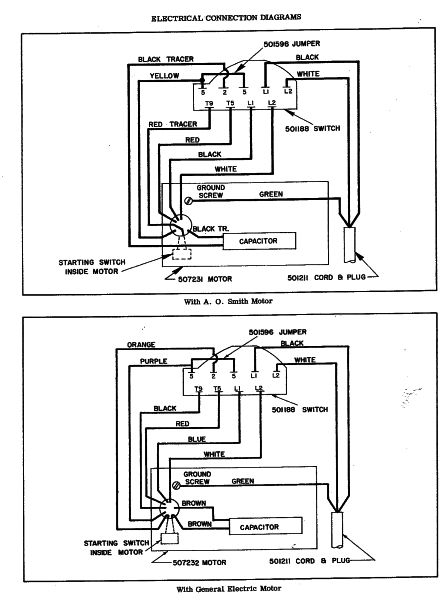

billmayo wrote:The Mark VII AO Smith motor have 6 wires coming out of the motor casing. The capacitor and start switch was still connected to one of the leads. I did a ohm reading on each set of leads for two motors which was the same. The one set going to the capacitor had 1 ohm, another set had 1 ohm and the third set had 6 ohm resistance. Now, I always found the start windings had twice or more resistance then the run windings. I believe that the motor will still start and run with the start and one run windings in parallel but I have to question what I found on these 2 motors. I did not find any references in my files as to what which set of wires goes to the start and run windings for the Mark VII AO Smith motor. Does anyone have any diagrams or material as to what wires are connected to the run and start windings? Thanks.

Mark VII motor wireing diagram
Looky what I found when I finally looked at the parts manual!:)
[ATTACH]18836[/ATTACH]
MVII MOTOR WIRING DIAGRAM.jpg (42.43 KiB) Viewed 2728 times
