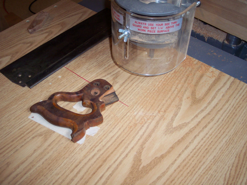

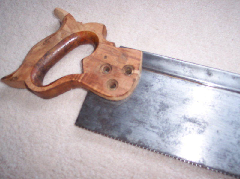

I've come into an old 14" E.C. Atkins backsaw, made in Indianapolis -- I love finding local stuff. One cheek of the original applewood tote is cracked off, plus other problems. Here goes a repair:
I have double-side-taped the Tote to a fore/aft sled I had made for my Overarm Router table a few years ago. With the piece aligned and a stop-point established, I milled out a slot to my desired depth successively:
[ATTACH]22224[/ATTACH]

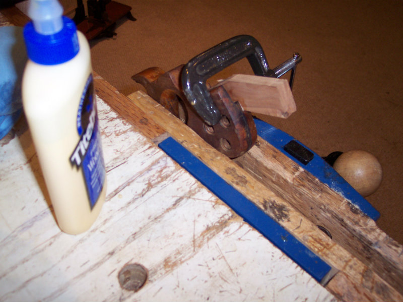

In the upper-left corner of the picture above you could also see a small wedge of applewood cut to the proper angles, with a 1/4"-radius on the vertex. That piece fits right into the slot I milled, gluing with a few faces under pressure, to be cut to flushness later on:
[ATTACH]22225[/ATTACH]

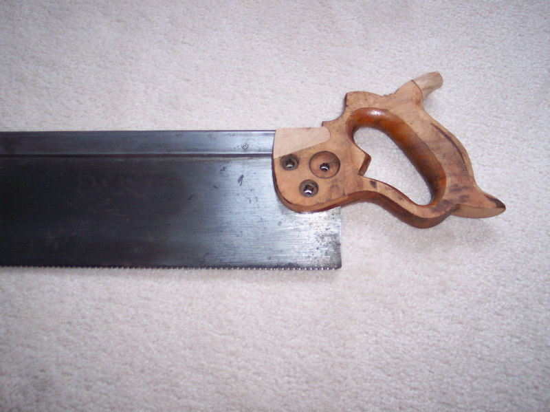

Inlays flushed
Post by nuhobby »
Just to complete that thought.... more work on finishing at another time. The left inlay was the result of a 1/2" router bit, and the right side inlay was from a 1/8" router bit. This is a lot easier than making a new tote!
[ATTACH]22247[/ATTACH]
[ATTACH]22248[/ATTACH]

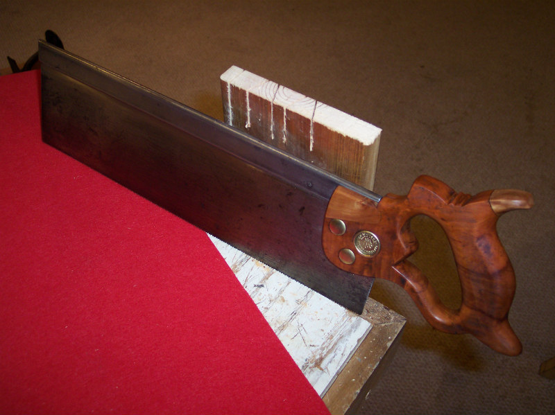

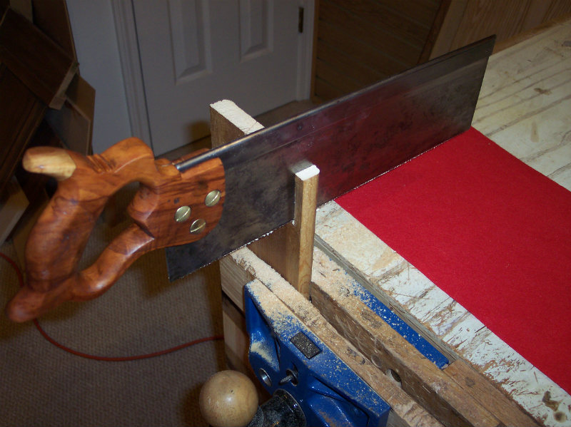

I added some finish oil and sharpened this baby. It works pretty nice! It's spoken for:
[ATTACH]22298[/ATTACH]
[ATTACH]22297[/ATTACH]
