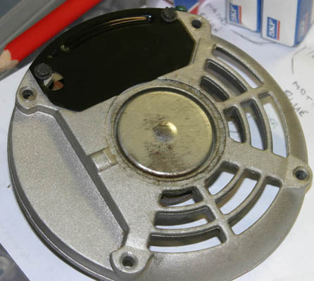

There is no outside way to oil this Emerson motor. I like to think grease is just very heavy oil. I would believe when heated when operating, the grease will somewhat ooze into the bushing/shaft space and provide some cooling effect for the bushing. Just my opinion.JPG40504 wrote:Now I be bamboozled.
Methinks a bushing(oiltight bronze) needs oil. That is why oil holes are usually included.
I see the end cap casting in Danscot's pix has a shape the resembles an oil hole tunnel. The pix does not show the 'outside' of the casting so I do not know if one is there. I would almost 'bet' that there is!
Using heavy grease with a bushing bearing just is counter to my experience.

Your wish is my command:JPG40504 wrote: I see the end cap casting in Danscot's pix has a shape the resembles an oil hole tunnel. The pix does not show the 'outside' of the casting so I do not know if one is there. I would almost 'bet' that there is!
[ATTACH]18020[/ATTACH]
No oil hole
Although I must admit that I thought it might be too - until I turned it over (don't laugh, it had been sitting that way up for about a week & my memory is not what it was!).
During that week I had scratched my head & trawled the web looking for info - I found something about feeding oil into bushings through oil holes...
It's now well past midnight here so tomorrow I'll check what the grease spec is & post that if it's of interest.
- end plate.jpg (53.25 KiB) Viewed 828 times
danscot wrote:Your wish is my command:
No oil hole![]()
It is!
Hmmmmm That looks just like the end cap(the 'no oil hole' part) on an Emerson planer motor that the tag states has ball bearings.
