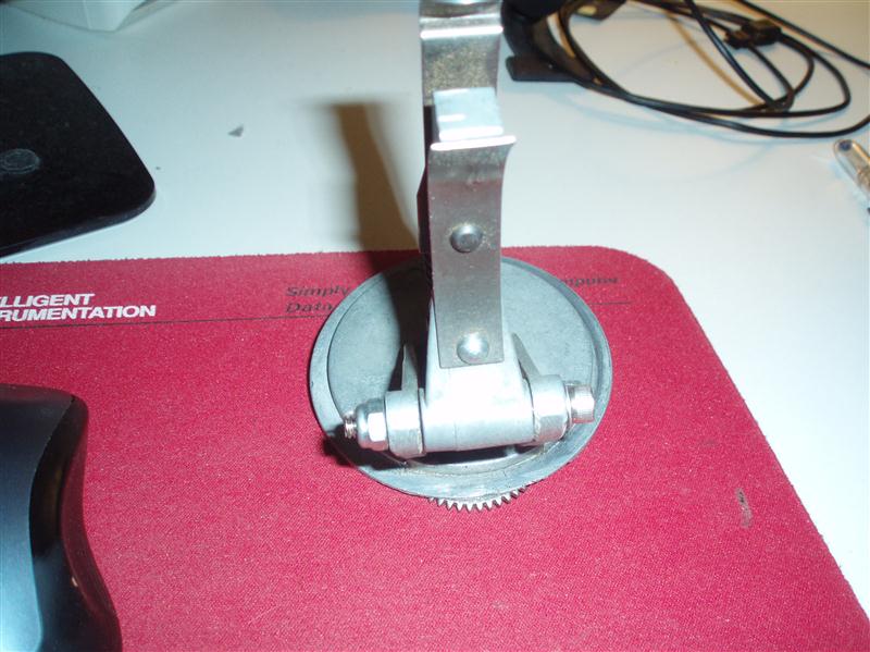

The wear shown in your pix shows that the worm gear no longer aligns with the center of the porkchop. One of the arms that the roll pin passes through has moved thus allowing the skewed alignment. The arm usually opens up the spacing and allows the porkchop to slide to one end.
The arm needs to be restored to its original position. This usually requires squeezing the arm back towards the other arm(the arm spacing = the porkchop width at the roll pin).
I prefer doing the squeezing with a vise so as to not 'slip' and over stress the arm. The amount of 'motion' is tightly controlled with a vise.

I know about the fix Dusty. The problem is that the Allen screws are not available in the 2 1/2 length just anywhere, I've done my looking around. As I stated in my previous post the screws can be bought but only by a hundred. That can be pretty costly when you only need a few. And my question again: is why does not Shopsmith offer this fix it kit for the quadrant?
Bill's quadrant fix and the parts that he uses are ideal. The reason why the bolt is hard to find in a hardware store I believe is because it is shouldered.
A shouldered bolt is not absolutely necessary. Here is a photo image of the quadrant in one of my machines. It works fine with hardware available at Ace. Also, it does not need to be done with an "allen head bolt. There is plenty of room for a hex head bolt

godavid2 wrote:I know about the fix Dusty. The problem is that the Allen screws are not available in the 2 1/2 length just anywhere, I've done my looking around. As I stated in my previous post the screws can be bought but only by a hundred. That can be pretty costly when you only need a few. And my question again: is why does not Shopsmith offer this fix it kit for the quadrant?
I believe they do not because like bearing replacement, 'they' consider it beyond the typical mechanical skill level(tools) of their customers.
Within this forum(and some others?) you will discover 'alterations' or 'fixes' that attest to the fact that that assumption is not applicable to all who frequent here.
The unavailibility of the screw attests to the slow demise of true hardware stores. A shoulder screw is 'better', but full thread will work as Ed mentioned. I prefer two nuts(jammed) to the lock washers. The nylock nut in Ed's pix is another good way to ensure they stay tight.(the nut(s) - the porkchop must be free to pivot between the arms).
