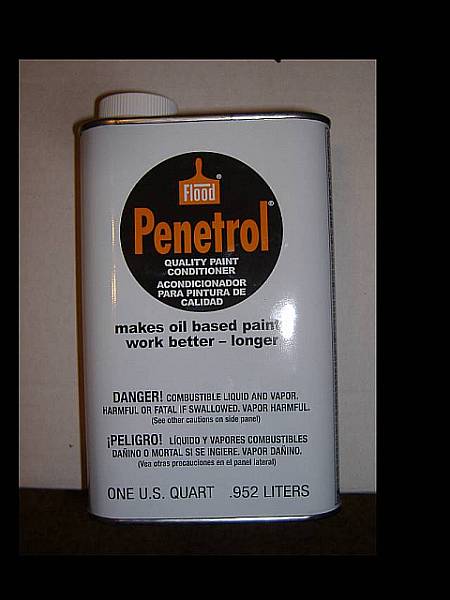

On the sage advice of Ed I got a can, 1 qt size at Ace but it wasn't cheap. Since I was there and wanted a can I spent the money but it may be a good idea to shop around, the Lowes price is about $2 less then I paid.
Here is a picture of the can... I had to ask for it, couldn't seem to see the writing on the can???
