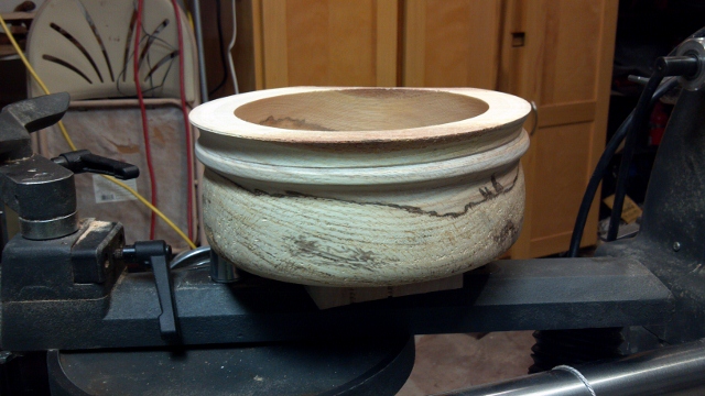

Ok, it's into the bag and stored away for a few months now. Not much to look at when green. It will be interestering to see how it turns out after drying. I still need to finish turning the lip of the bowl but wanted to wait until it drys in case it decides to crack. The thinner brown paper seems to hold the 3 inch face plate much better this time. I will implement some of the suggestions provided here on my next bowl. Like leaving the live center on the tailstock in place as I begin turning the interior of the bowl. And to turn from the outside towards the center as suggested.

Just remember to cut going down hill. On your next bowl practice the "hero cut" once you cut down the pillar.
Hero Cut - going from the outer edge to center in one pass of a push stroke or center to edge in a pull stroke (some people prefer the pull stroke which technically is an uphill cut but ultimately it's safety and the final result that counts and not how you got there.).
The hero cut produces a much nicer finish cut (Less sanding) but does take practice.
Looking good Fred! Waiting for the drying is the hardest part. I usually put a date on the outside of the bag and put the bag on a shelf some where out of my normal field of vision. If you don't have a moisture meter, weight the bowl now while it's still wet. In a couple of months weigh it again, then at regular intervals monthly, weekly. Once the weight stays the same on consecutive weighing sessions you have reached EMC.
