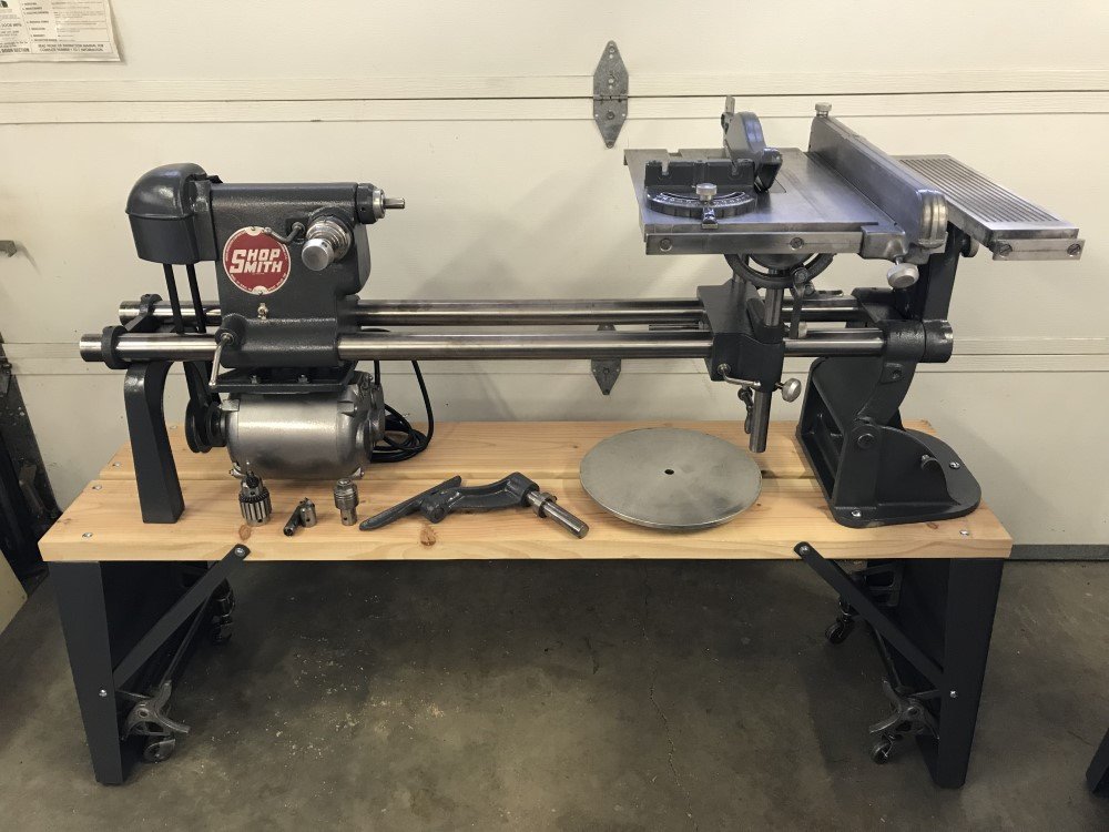

Below is a Western Plant made restored Model 10ER from mid 1951. It is complete as it came from the factory plus it is mounted on a bench made with the Shopsmith Metal Bench Ends and has the Retractable Casters.
_ .
Pictures of what you have would be helpful in better identifying it and anything missing or needed.
_ .
Re: Serial number lookup
Thank you for your quick response. My ShopSmith does have the ER prefix. it's ER46453. I've taken pictures, but I'm not sure how to include them on this post reply. My machine looks just like the one pictured above and it is mounted on the same type of wooden table with the metal frame and castor system.
