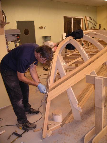

3) Epoxy needs not be messy and while pot life can be an issue, it is easy to work quickly once you become familiar with the material. This is how you apply it to the edges of strips. There should be little or no "squeeze out" and as it's not runny , it can be cleaned on the spot and reused, leaving very little sanding later.
Here is a blog I did on some epoxy handling tips.
Again, I don't want to start an argument. These are my opinions, based on my experience. I'm just trying to help.
[ATTACH]23156[/ATTACH]
