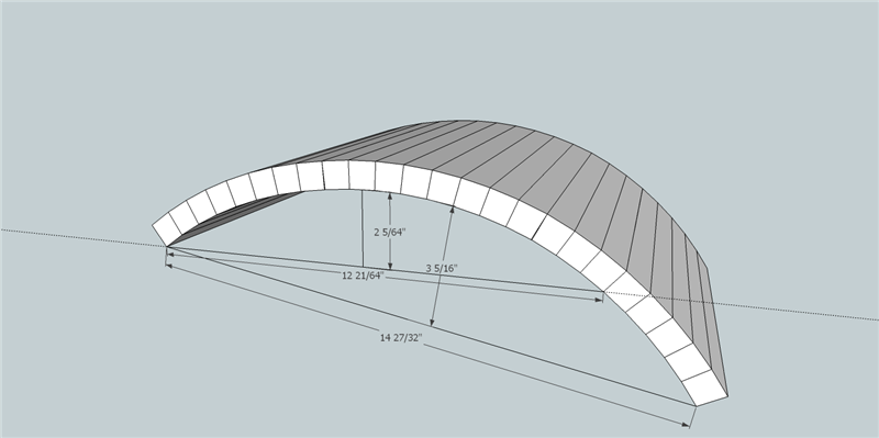

The radius of part D is 10".
But don't push the arc down! Take out all of the extra slats and all will be well. I used 24 slats because the author said he needed 24. It turns out that the arch requires only 19.
With those changes, the dimensions are close to the original plan.
[ATTACH]24120[/ATTACH]
This was another fun project that has reaffirmed that I should have paid more attention in math classes. If only teachers would have given good reasons for learning all of this stuff. I also learned, again, that assumptions are often wrong.
Wedding Chest #2 Top CORRECTED ARCH (Custom).png (65.71 KiB) Viewed 946 times
