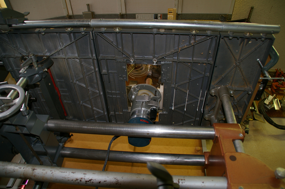

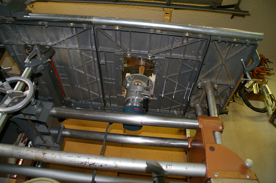

Did you have to do any stiffening to the underside of the table after making the hole? Maybe a pic of the underside would be instructive. :)

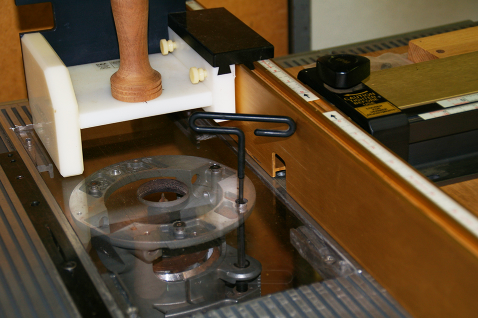

Pics from the bottom and one more showing adjustment key to raise or lower the router. No, I did not do anything to the under side as I don't think it's necessary. The SS table is stiff as it is.

Thank you, very nice job. I see you used pieces of the cut out table at the corners under the lexan router plate. Ingenious!

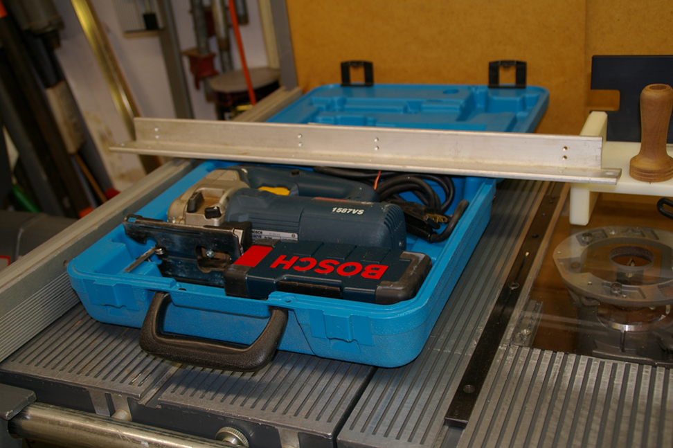

Excellent work. I have been considering doing the same thing. How did you cut the table?

I used a piece of Aluminum angle iron for a straight edge clamped to table with C-clamps. I used the existing lines on the table for width 6 1/2" and 13 3/4" long. Used a piece of 1/4" Lexan to fill where the SS table insert was.
Used my 1587 Bosch jig saw to make the cuts. Also used some old miter slot steel for filler. I am on the look out for some bar stock the right size.
