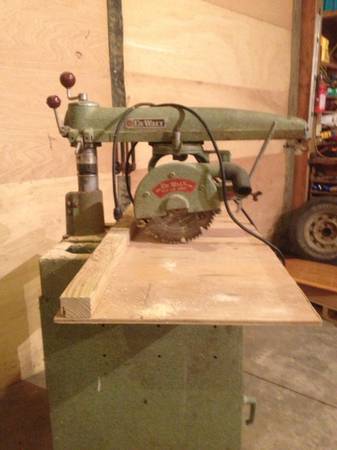

So a search on Craigslist turned up this listing right here in town. Here's a photo from the CL ad.
[ATTACH]24273[/ATTACH]
It's a DeWalt model MBF, as near as I can tell, from the late 1950's. The asking price is $75, and I just might be able to shoehorn it into my shop. Any words of wisdom for me? If I go check it out, what should I look for in particular?

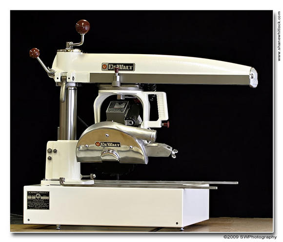

Now for some real eye candy. While researching the DeWalt RAS's, I found this photo of a gorgeous restored model MBC. I don't think I'll go that far on a restoration! The design aesthetics remind me of Heath's mixer project.
[ATTACH]24274[/ATTACH]
This machine is still listed for sale by the restorer for only $350. :confused:

I've always been told the old DeWalts were good saws - I imagine all the saws made back then were good quality and made to last. The restored version above is beautiful - hard to imagine putting that much work into something and then trying to sell for $350…as we all know, restoring old woodworking tools is not something to be undertaken with the intention of seeing a return anywhere the investment.
As for advice if you do buy this saw, as I noted above, make sure to get the correct type of blade for it - one with a negative hook angle. Here are a couple links with more details and online options for purchase:

I used to have one of the green DeWalt RAS. One of the things to watch for is cracked stops for the saw arm that stops the rotation at specific angles. Also make sure that it locks firmly in position when the arm is not in one of the predetermined angles. They sometimes developed play in the clamping system. The clamp that holds the motor carrier to the radial arm should also hold the motor firmly at the odd angles. I think that there is a stop for 90 and maybe 45 but I don't know for sure. The bearings on the motor carriage should show no play when the carriage lock loose. The motor should roll easily along the arm. The bearings are adjustable to take up some slack. (IIRC). I believe that they used an 8" or 8& 1/4 inch blade
Looks like there is a lot of life left in that one.

Bill, I'm going to print your post out for a "cheat sheet", and take it with me when I look at the machine. Greatly appreciated!
Judging from the closeup sawblade photo, the teeth appear to have quite a lot of positive rake. That, plus the comment in the ad mentioning that a new blade or sharpening would be needed, has me wondering if the current owner experienced one of the hazards discussed earlier in this thread.
