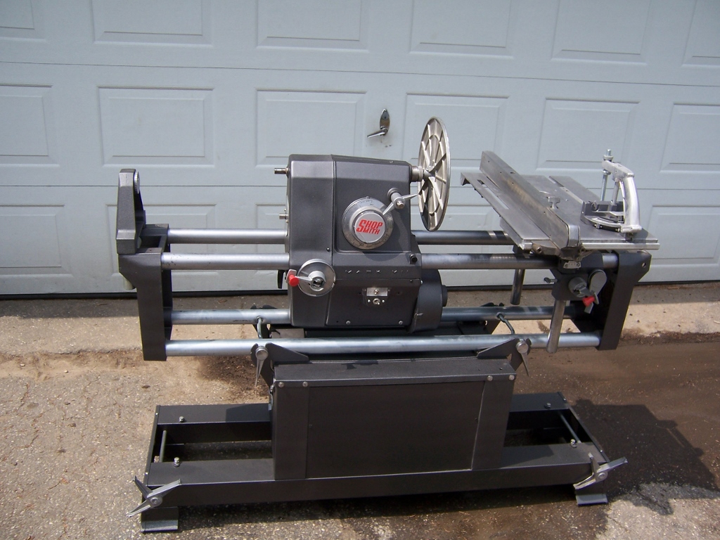

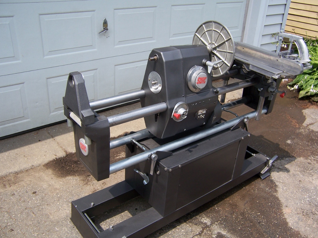

Almost finished restoration of my first Mark VII.

r_mack1969 wrote:Almost finished restoration of my first Mark VII.
Beautiful job!
That might just provide the motivation that JPG needs, to actually finish up his 'VII. :D
