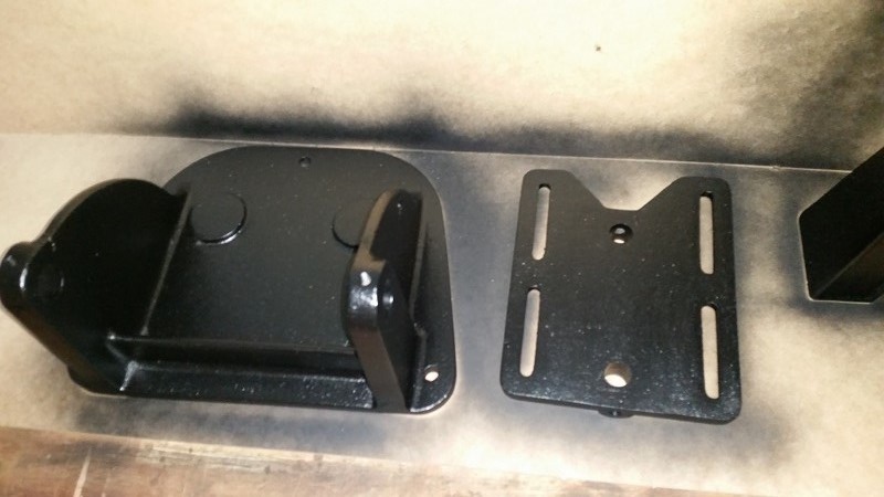

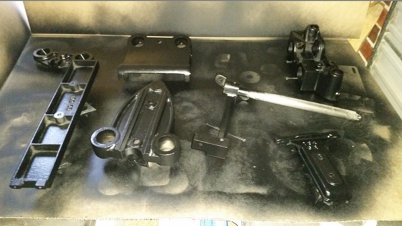

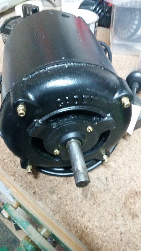

Well well its been some time since I stripped all the paint off and removed 60 years of grease and oil buildup. I finally had some time on the weekend to start painting it. I still cant decide if I'm going to paint everything black and polish all the chrome, aluminum and brass fittings so they stand out on the black background or if i will paint the headstock silver so it has a nice contrast.
I dismantled the motor and blew all of the dust out then replaced the bearings, assembled again. It ran without smoking but still a bit rough. Then dismantled it again ready to be cleaned up and painted; after painting and polishing all the brass screws and nuts and assembly I plugged it in again. After a short run....smoke...
will have to invest in a new one or get this one repaired.

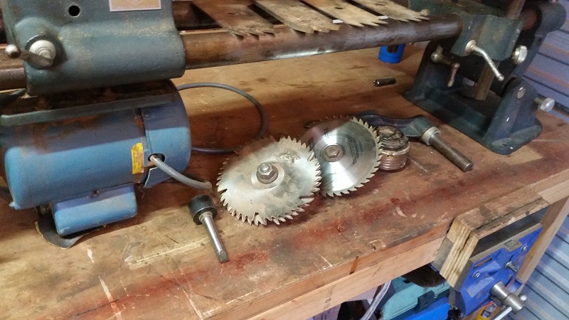

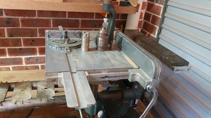

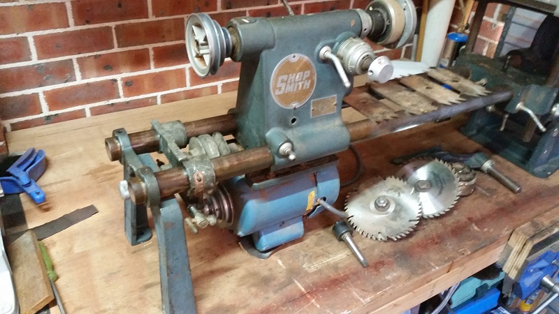

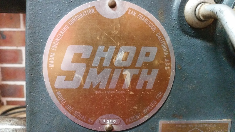

I haven't even come close to finishing this one and i have already picked up a second machine that is in working order SN1200. It has been used until earlier this year when the previous owner passed away, from the info i was given it has been owned by the same family since new. Its in fairly good condition, the bearings are a bit noisy and the spindle has a bit of damage from attachments not being tightened up properly.
This machine has the speed changer attached, there is also several arbors and spur drives, even a dado blade. There is also an attachment that i think is a mortise attachment....i think. Not too sure what parts are missing tho.
- Painted Parts.jpg (88.64 KiB) Viewed 2962 times
- Painted Parts2.jpg (132.42 KiB) Viewed 2960 times
- Motor Painted.jpg (131.86 KiB) Viewed 2956 times

Looking very good. Hopefully the speed changer will clean up, those are handy. Make sure you post your rebuild in this thread.

An interesting machine. At 1200 it is obviously a very early one. It appears the speed changer is the '8' speed one. A word of caution: avoid prolonged running above '5'. The later ones altered the center pulley sheave to restrict the range. There is some 'ER' stuff in there(miter gauge and rip fence), so the PO believed in 'improving' it over the years.
