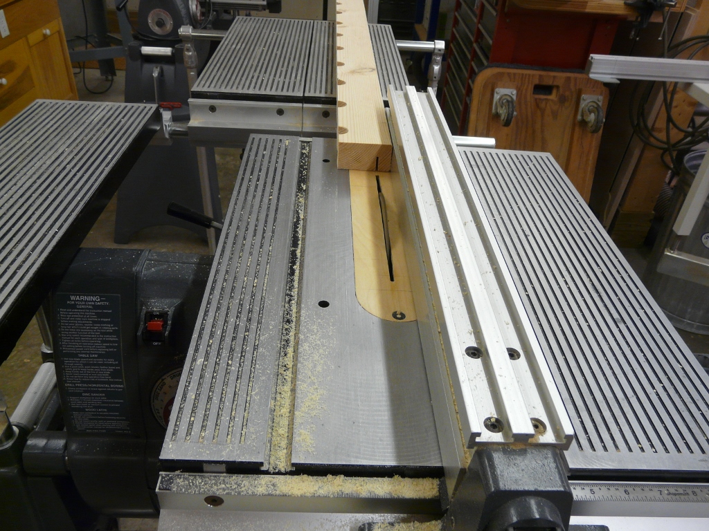

Very well thought out and demonstrated. I can see where this makes for an excellent production jig. All of my circle cutting jigs have been limited in size and did not produce that "perfect circle". I learned to cut large and take it to the belt sander.

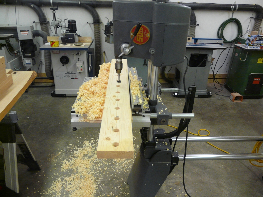

That project inspired me to do another I have been planing.

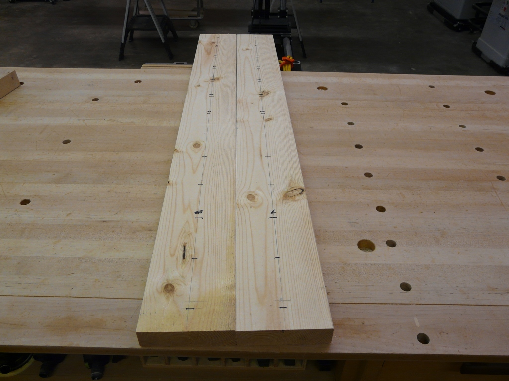

I start out with these 2x6’s with 2 sets of marks. My correct ones and the wrong ones done by the camera man.

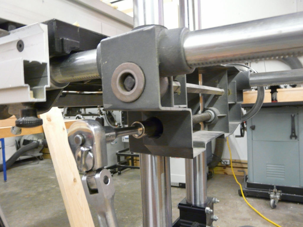

This is where things started going down hill. I thought my drill bit was slipping and I kept tightening the chuck and resetting the depth.
Turns out the table was slipping instead. Man this Shopsmith stuff must be real junk. I have only used this thing (almost daily) for 12 years. I cant believe I am having to work on it.
Oh well I guess I can stop saving up for that new Mark 7.
Never mind. About a half turn on this lock nut and we are back in business.

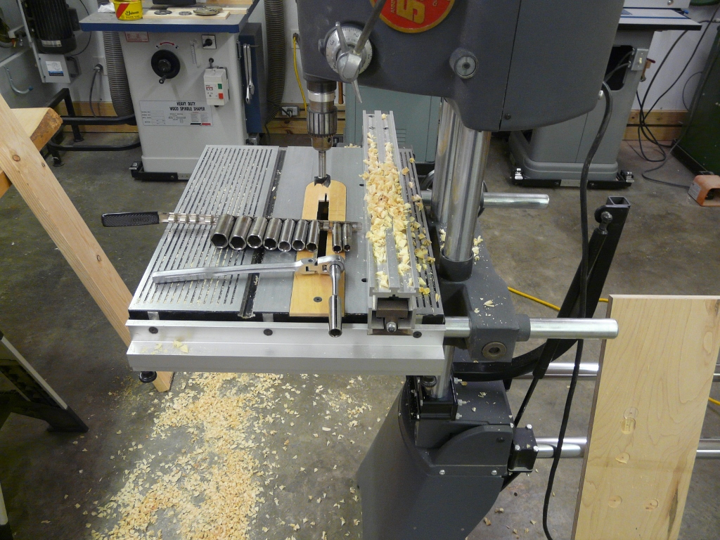

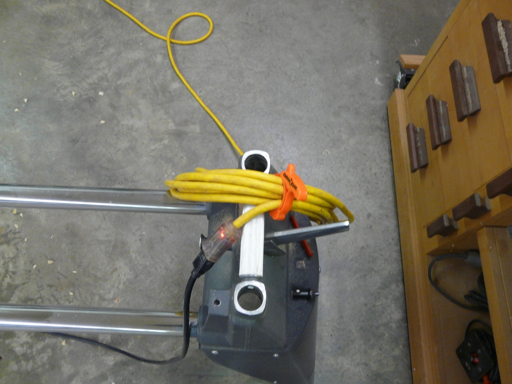

You may have noticed that I moved the 520 to the center of the shop. I knew this was going to be a messy job. Notice though I am using a 12 gauge extension cord. I point this out for those that may be new and don't realize that these machines are not designed to run on the more common light gauge extension cords. I have burned up a lot or tools over the years on job sights where there wasn't adequate power available. An then there was the time I burned up 2 battery drill chargers and an almost new hand held electric planer because some IDIOT ran 220 to all the 110 temporary service.

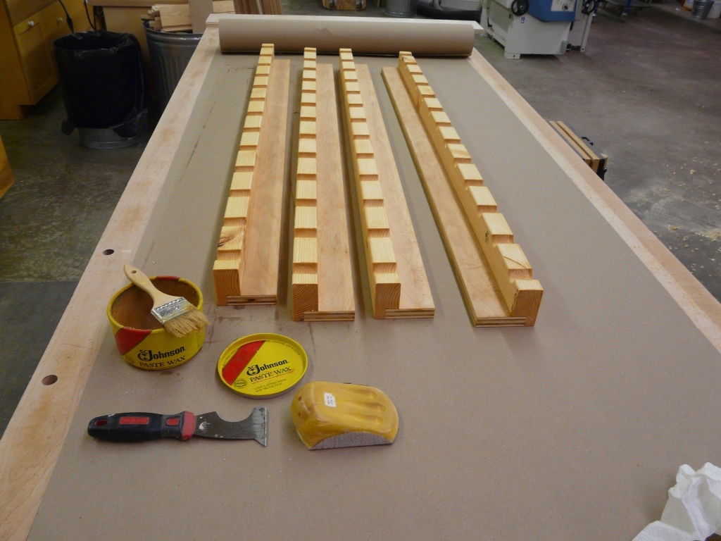

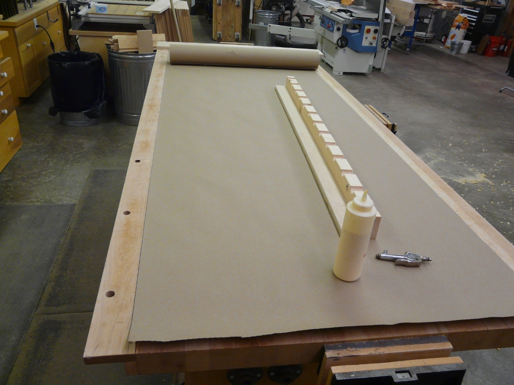

What is the purpose of the Johnson Paste Wax?
Joe
Being a VETERAN is an honor
Being a GRANDPA is priceless
Re: Occasionally In The Shop
Keeps the glue from sticking to the jigs?
Correct.Mike907 wrote:Keeps the glue from sticking to the jigs?
