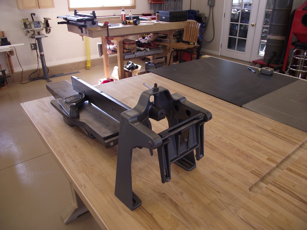

John, just so we are talking the same, is it the 2 "pins" that act like hinges in the base plate when going from horizontal to vertical?
Re: Rescued another one!!!
I don't think so. You responded to my post where I/we were discussing the 4E jointer head rest. I need the hinge piece that attaches the jointer to the head rest. I have two jointers, two headrests and only one hinge. It is the piece on the right attached to the rod on the head rest in the picture. The jointer attaches to it so it can be rotated up into operating position or down out of the way when not needed.ERLover wrote:John, just so we are talking the same, is it the 2 "pins" that act like hinges in the base plate when going from horizontal to vertical?
- DSCF0890.JPG (337.96 KiB) Viewed 1993 times

John, no unfortunately I dont have that part.
OK, no problem. I thought we were not on the same page.ERLover wrote:John, no unfortunately I dont have that part.
