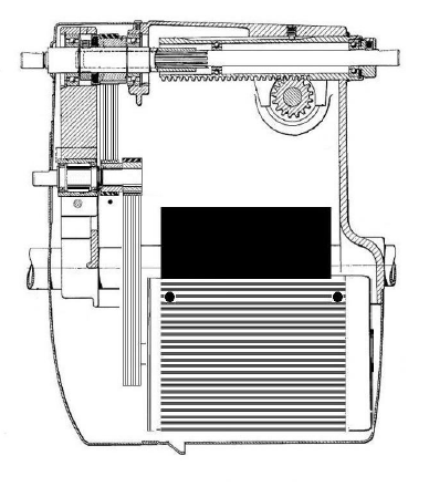

Where can it be? I would think the quill. Nothing else is changed as a result of the quill being extended.
With the quill extended and the PowerPro turned on, does holding the quill or putting lateral pressure on the quill change anything?
What if you take the quill out completely?
Capture PowerPro Headstock.PNG (78.35 KiB) Viewed 5152 times
