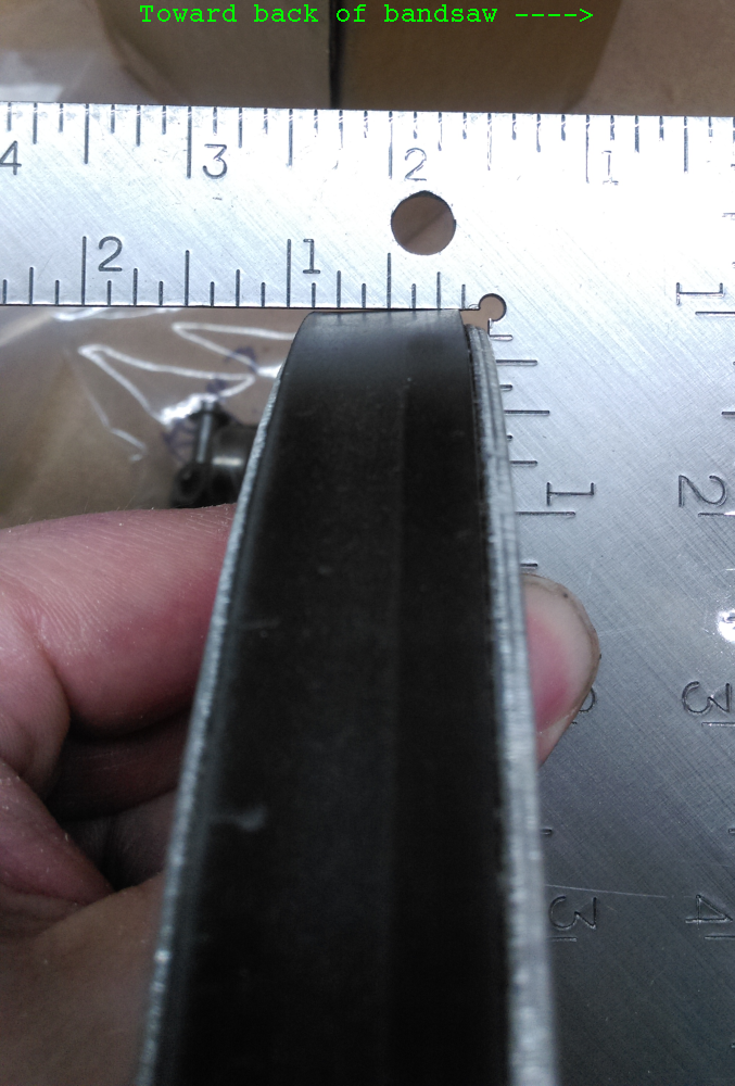

Okay, so I just got home and went out into the workshop. I loosened the tension on the blade, moved it almost to the very back of the tire, retensioned and spun the blade a few times. It almost instantly returned to somewhere between a 1/8" to 1/4" away from the edge of the tire.
The problem seems to be that the tire itself is not always in the same place across the surface of the wheel. Apparently this wasn't a 'defect' when the tire/wheel went through quality... I also noticed that this a bit out of round like the lower wheel..
Bandsaw Uppper Tire and Closeup.png (760.36 KiB) Viewed 2349 times

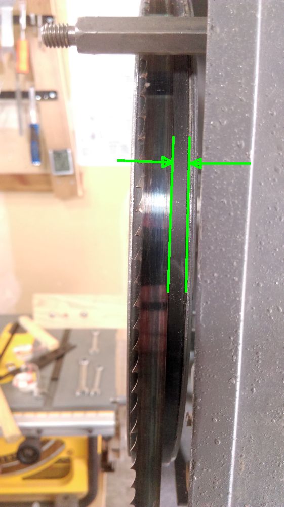

Wheel Cant.png (789.01 KiB) Viewed 2348 times

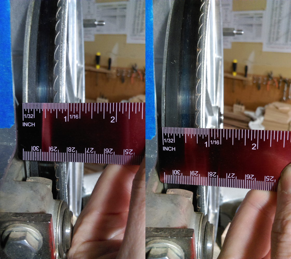

Re: Wobble in Lower Bandsaw Tire
I'm not use to looking at the 5/8" wide blade as I normally use a 1/2" wide wood slicer. I have to say it is farther out then mine is at least by looks. I'll go down and pull the cover and do a measurement.....
When I measure mine I have pretty much right on 1/8" for the distance shown below. Yours looks like more then that, is that correct?

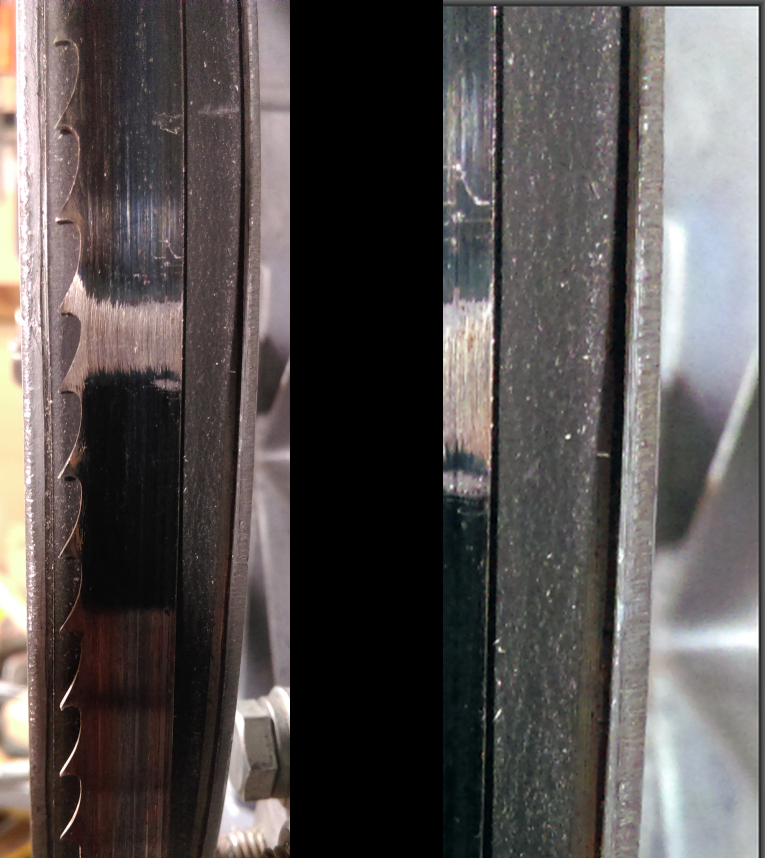

As pointed out, I found out that the tire on the wheel is skewed. I decided to choose a place I could get a pic and chose two difference locations on the wheel to illustrate this. As you can see in the following pic comparison the distance from the blade to the back of the tire varies rather significantly, from but the distance between the blade and the back of the tire only slightly varies.
Blade Position Upper Tire.png (1.61 MiB) Viewed 2334 times
With those scales in place from the machine part of the wheel to the blade looks like about 7/32" to 1/4". Mine is only 1/8" or about half that. Now I don't have any idea what that range should/could be but it is more then I see on mine.
