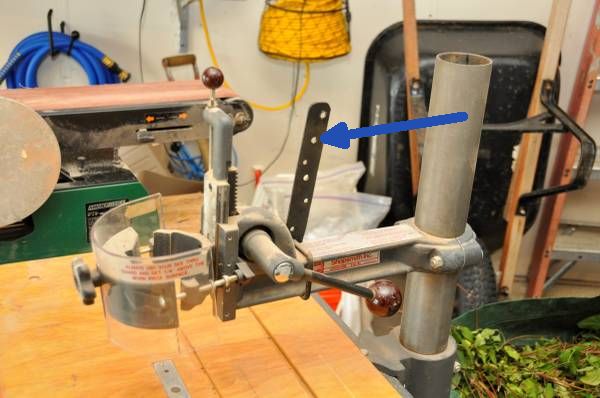

Any idea as to what this is?

reible wrote:Any idea as to what this is?
I believe this was on it when the the guy got it, from a production cabinet shop, as he never used it. It appears to have had things bolted to various holes in the past. I could take a guess and say they probably had dust collection and the router cord bolted to it to keep them out of the way. Maybe some form of safety shield as well. The black u-bolt holds it on the arm.
