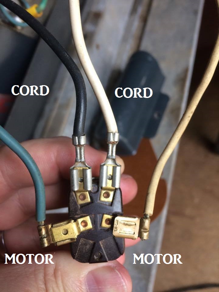

I have attached a photo of the Switch. I apologize, the "green" is apparently blue. but as you will see it looks almost green on mine now due to age.
I ran the readings again. All go to Zero, the bottom right White to Motor is the one who shows some activity then goes back to zero. the others just remain at 0

Re: tripping breaker
I have not read the entire threat but your notations on this one with the switch image indicates a bad power switch; can not turn unit off.
Pull the wires off (picture shows how to put them back on) and then measure the switch only in the same way.
With switch on, I would expect you to get the same readings. With the switch off, you should get entirely different readings. If the readings are the same, then you definitely have a bad switch.

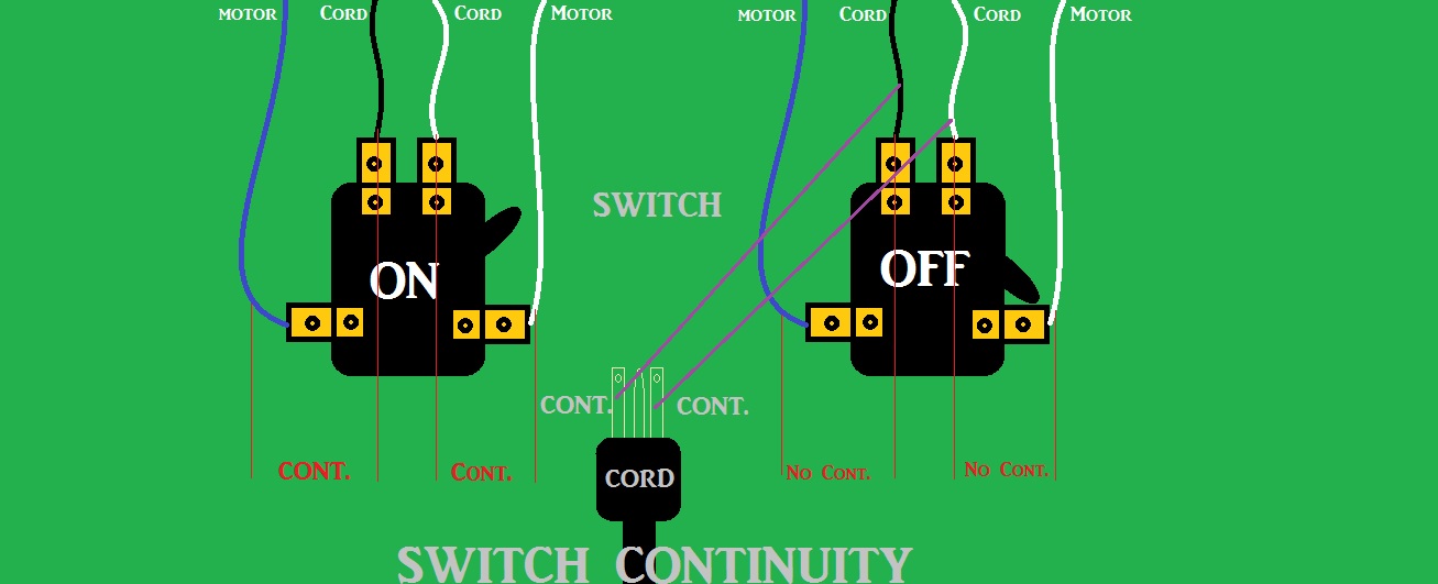

For a 'properly' operating switch the following readings should be observed.
With switch OFF:
1) No continuity between cord black and motor blue.
2) No continuity between cord white and motor white.
With switch ON:
1) Continuity between cord black and motor blue.
2) Continuity between cord white and motor white.
Neither should break continuity when switch moved/banged/wires pulled etc. i.e. both should be a solid one.
Continuity between the motor blue wire and the motor white wire should ALWAYS be near zero.
While checking the switch, also check the cord.
With switch OFF:
Continuity between the cord black wire and one of the plug flat blades.
Continuity between the cord white wire and the OTHER flat blade on the plug.
Look for any tendency for the readings to change while measuring that are not a result of probes slipping.
With switch OFF:
With switch ON:
With switch OFF:

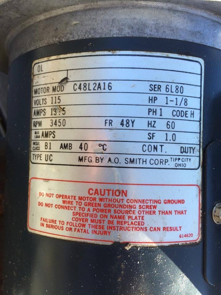

.Re: tripping breaker
I have a unit on my bench right now that has a green wire connected to the motor. It is an AO SMITH motor. The first one that I have worked on. When I pulled it apart I did not notice the wiring. I am familiar enough with wiring to figure it out. The green wire could be a faded blue but it sure looks green in the fluorescent light in my garage.
Fairly Certain that is the same motor and wiring I have in the pics.

Re: Continuity
JPG wrote:For a 'properly' operating switch the following readings should be observed.
With switch OFF:
With switch ON:
With switch OFF:
See attached Testing this now.
- continuity.jpg (95.97 KiB) Viewed 2756 times
