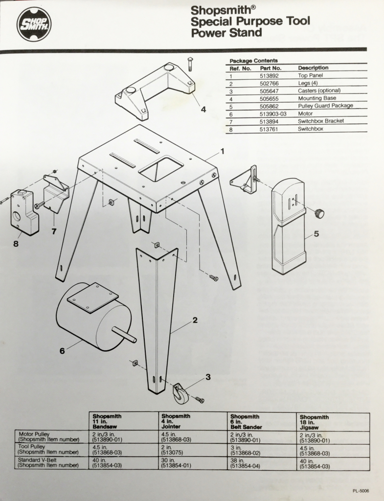

roneg wrote:Here's a question.
On the powerstands (not the Planer) how was the power switch (keyed type) mounted. I saw this of one mounted with what looked like a factory metal mounting bracket.Switch 2.JPG Any Idea where this is shown as a part # or in a diagram blow up?
Power stand manual.JPG (574.09 KiB) Viewed 3671 times
The manual above came with my used jigsaw and Power Stand -- the PO couldn't find them when I picked up the saw, but was nice enough to mail them to me when he found them later.
I have the same switch on my stand-alone overarm pin router, but the bracket is not used. It's a nice switch, but I'd be just as happy with a paddle-style safety switch like this one, which happens to be on sale right now at a very good price.
I'd never noticed the optional casters on the Power Stand drawing before, but they are interesting. They appear to be used in a "tip & roll" configuration. I bought a used set of Mark V casters for the Power Stand, but have never gotten around to installing them. I may try the tip-and-roll caster idea instead.

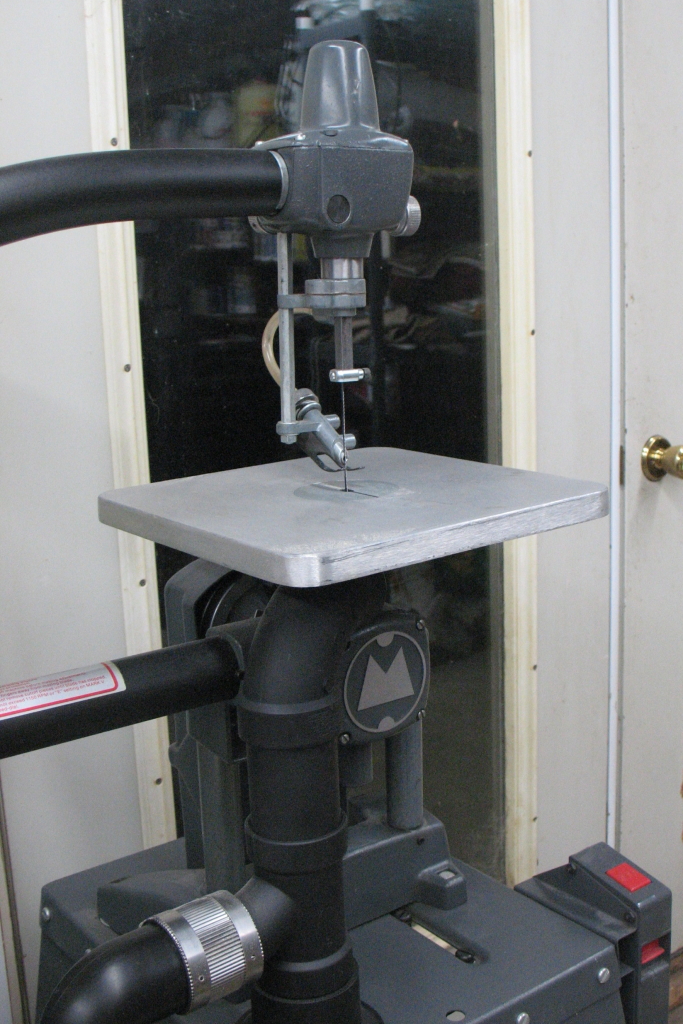

Below is my jigsaw on a Power Stand, with the switch & bracket in question.
