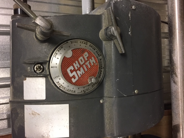

I'm sorry for keep saying things about my shop Smith but I'm not sure if it's a Goldie it is grey
My shopsmith
My shopsmith

I believe I am culpable re the confusion. Originally I misread the SN as 6 digits when it actually is 5 digits. I referred to his(Bamaguy4u) as a goldie built by Yuba in 1962. Since his has a 5 digit SN that makes it a SS Inc. (gray) made in 1979.
The Goldie being correctly referred to belongs to Chrisclan. (SN 381089)

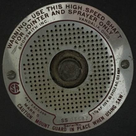

Dennis can you take a picture of the vent plate showing the serial number and post it? That would help clear things up. It should look like the one below but with your S/N.
May 1979
May 1979
