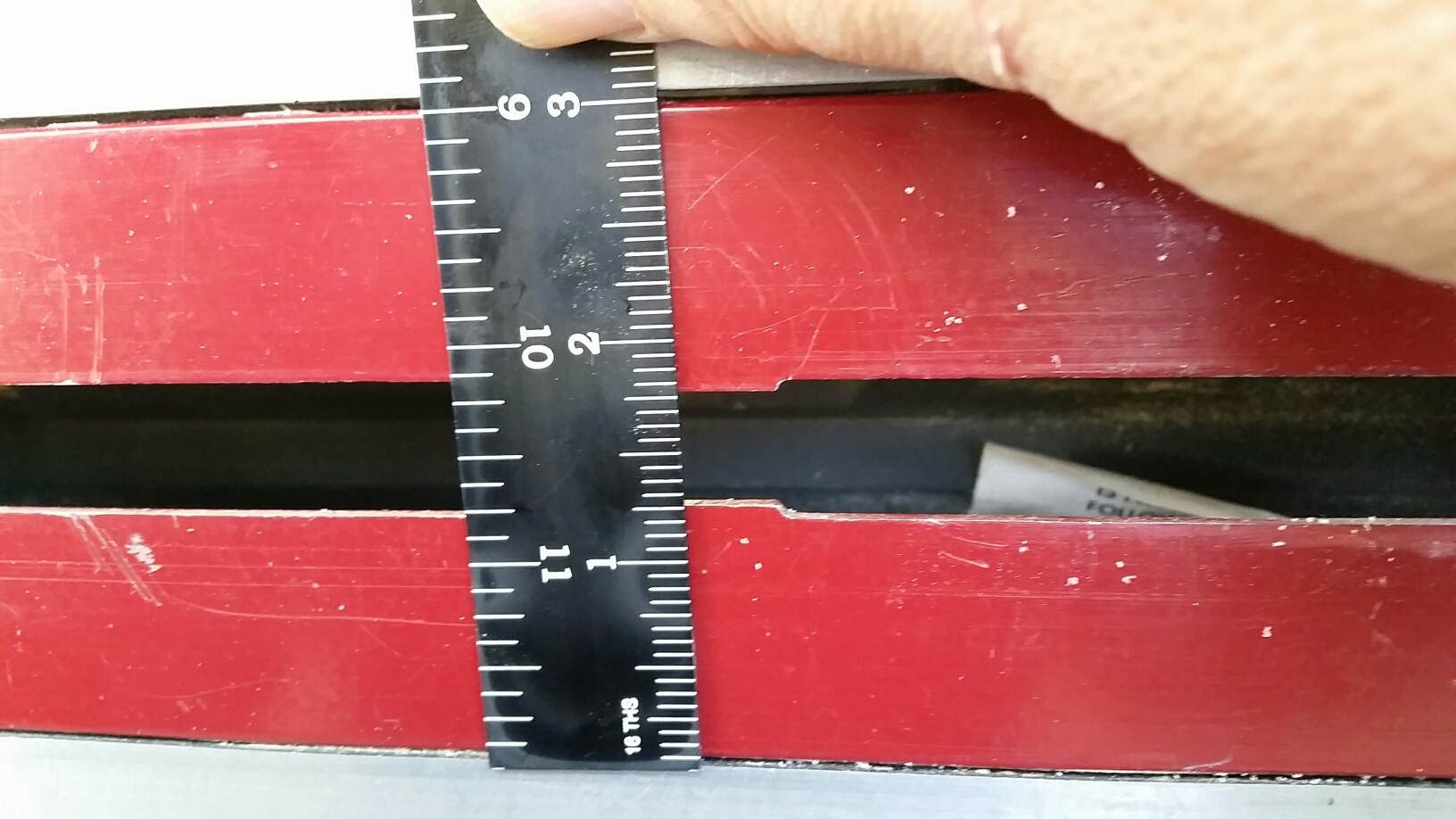

Anyway for reference this is the standard insert with a rule so we can get that checked off the possible problems.
Re: My 520 started singing today.
reible wrote:If things are unique then I don't see how they could be mis-used but it was a though.
If some of the PowerStation table inserts were used on a Mark V it would necessitate adjusting the quill or moving the carriage. Not all of the cutouts for the blade were centered.

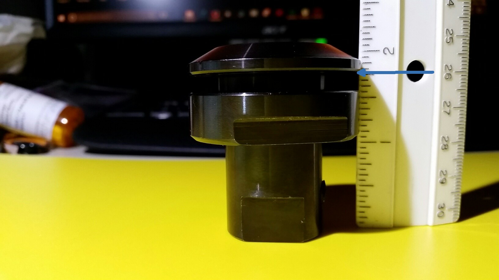

Well time for another measurement.
I've been thinking back and if I recall in the other thread I ask about mounting the upper guard and seeing if it would align with the blade........ this is normally a good way to know if the arbor is the correct one. But now I'm seeing dimensions which are not adding up......
So here is another picture of the shopsmith arbor for the 510/520 with the ruler beside. The critical dimension here is the one to the fixed lip of the arbor. Please check this dimension is 1-3/4".
