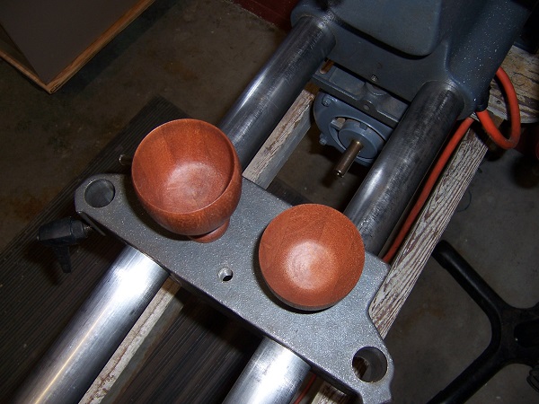

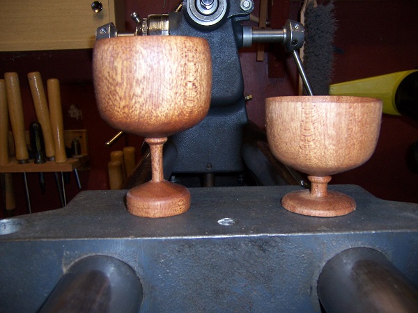

Couple of goblets (actually, my wife dubbed the shorter one an "ostrich egg holder"), made out of mohagany. The mohagany was salvaged from a larger candle holder I made in 8th grade woodshop. That's some old wood.
The base on the taller one is not sized right because I broke it off the chuck when I was starting to part it (I salvaged it with some hand sanding). The short stubby one was all the lenght I had to work with.
Loving my 10er as a lathe.
