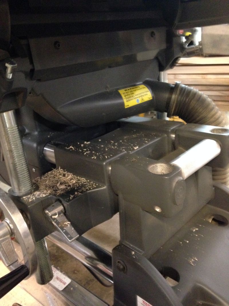

Picture posted of earlier in this thread after cutting a 1/4"x3/4" deep rabbet in a 3/4"x2' board
Picture after fixes to lower guard and cross bar of table.  This was cutting the same board with the same cut.

You won't get it much cleaner than that picture shows. I have been to that point with my fixes but I often get into a task without hooking up the dust collector. Not good but all my own doing.

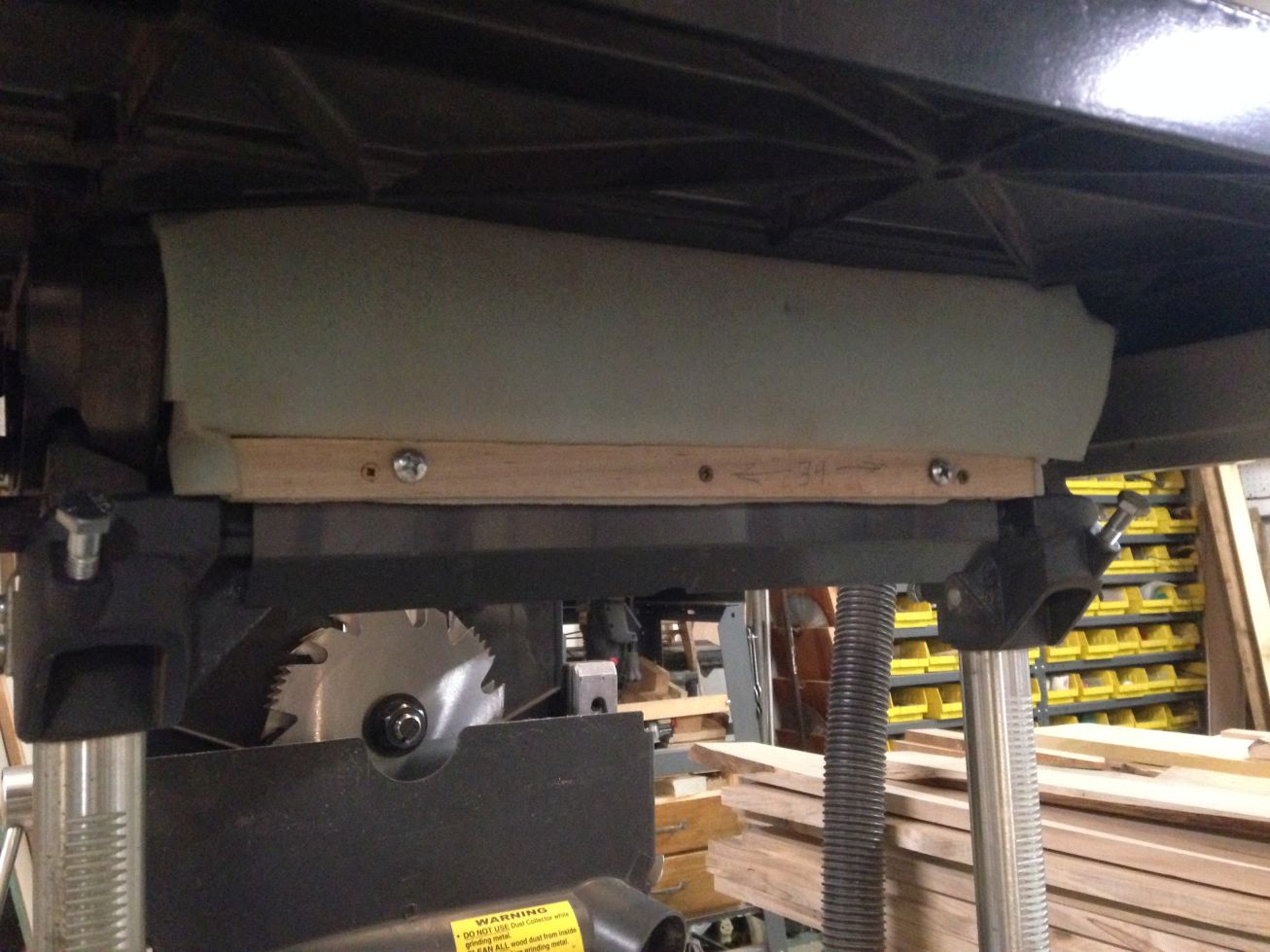

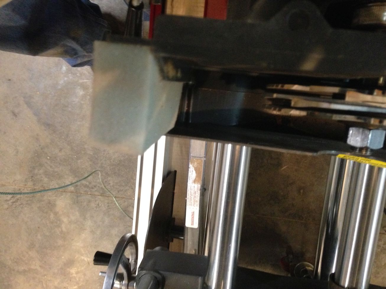

Here's a couple of the fixes I did to reduce the sawdust going everywhere. These are made from a 2" chair cushion from Walmart and cut to size with the bandsaw. They may have a 1 inch available but this is what the wife brought home.
1"x1 3/4"x4" I used spray adhesive to attach to the lower saw guard.
Two 1/4"x5/8"x 13 1/4" scraps of maple, three half inch wood screws, and foam 1"x4"x14 1/2"
Ignore the writing on the wood. I had to replace the screws on the tie bar with 1" screws. The foam is compressed between the two pieces of wood and screwed together prior to installing on the tie bar. The foam will compress when going into 45° mode. Not shown but I did this with the 10" blade also with very good results.
Edit: Note that the lower Shopsmith plastic shield is still in place on the tie bar.
Re: Holiday Catalog and NEW dust collector
The fix shown in the first picture will [rove to be useful and effective. That shown in the second picture I have doubts about based on my own approach. Your fix is better, however, because it is flexible; mine was not. Mine interfered with table tilt.
