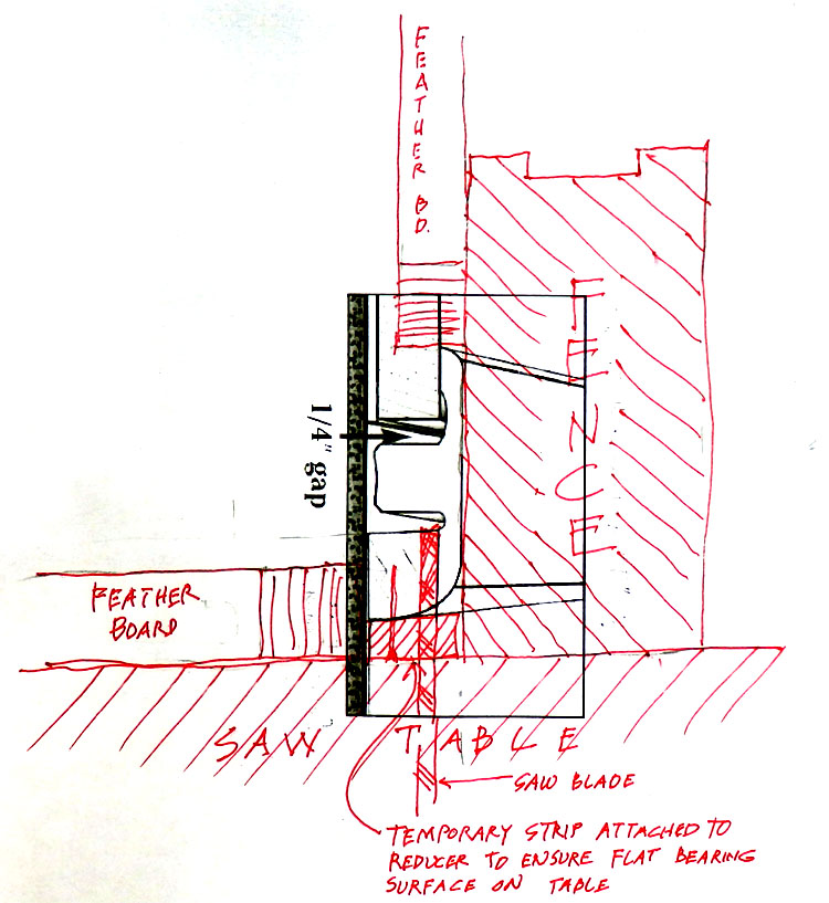

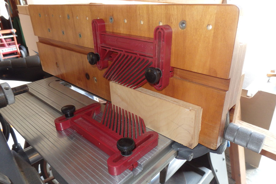

I think you're getting two completely different approaches. It seems like Brenda understood your question about modifying an existing reducer to make it into a "T". I agree with her suggestion of preferring the router. I think John on the other hand is describing how to make a "T" from scratch.BigJohn wrote:... I am looking for some suggestion on how to cut a piece of floor reducer to convert it into a "T".
If I were to try to modify it using the table saw, I would attach a small strip on the edge that is going to be removed, so as to provide a square, flat edge on which the piece could ride as pushed thru the saw. Feather boards on the top and on the side are a must. Feather board on the side should be positioned just before the work piece will contact the saw blade so that it will not cause the saw blade to bind on the piece being cut and removed.
There are a variety of feather boards on the market that you can buy or make if you don't have any. My setup is a 500, but here is a quick sketch and an equipment mock-up of how I would be set up. Imagine the table being raised and a blade being installed too. I use my plywood fence attachment with a dado in it to have a place to attach the feather boards I use.
You haven't mentioned your non-Shopsmith woodworking experience ... what ever you do, be sure you have a good understanding of the method being used, and remember it is only a piece of wood.
- Modifying a reducer to become a T.jpg (165.32 KiB) Viewed 6875 times
- Aux fence with feather board.JPG (125.75 KiB) Viewed 6875 times

Wpw!, That's perfect! It pretty much what I had planned on doing initially, but your suggestion of adding a small sacrificial strip to the edge for stability makes great sense.The new 520 fence system has featherboards that can be easily mounted as you suggest and I can probably use some small screws or brads to attach the sacrifice strip.
