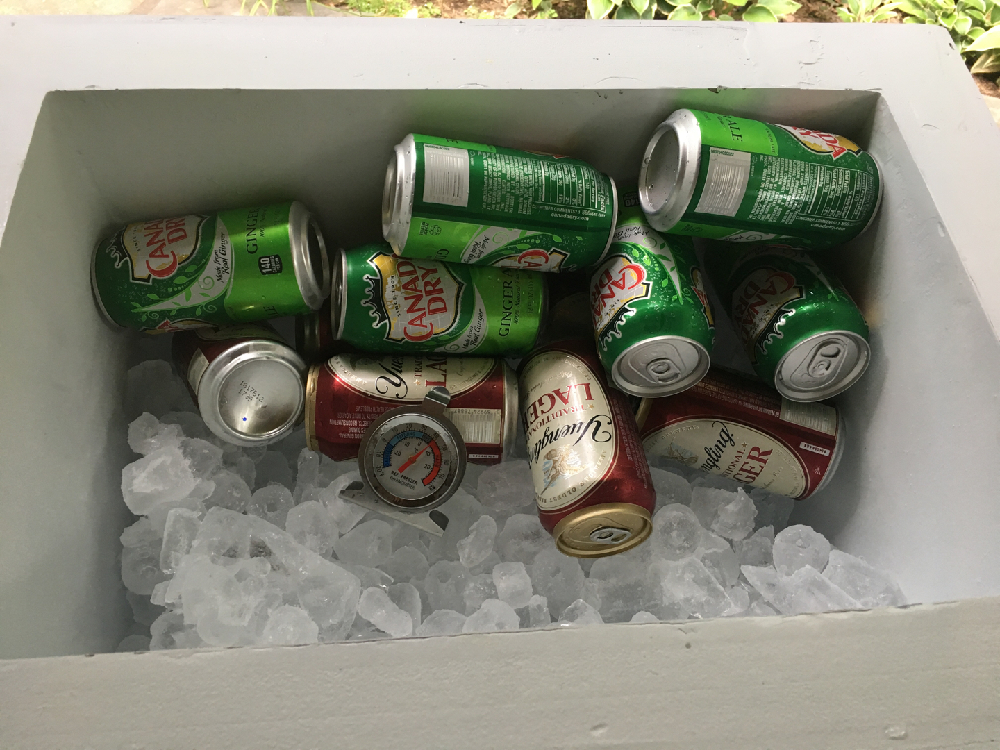

Ice retention test. The cooler was precooled in the freezer for 5 hours. I added a total of twenty pounds of cubed ice, a six pack of chilled adult beverages and a six pack of chilled ginger ales (placed on top of the adult beverages to try to keep the ginger ale from freezing solid. There's still a lot of air space in the cooler, which is suboptimal for this kind of test.
At 2:45 PM on 8/12 I closed the cooler. Ambient air temperature was 81 degrees.
The freezer thermometer in the picture was reading 43 degrees when I closed the lid, which I assume is the result of it sitting in the the cooler with the lid open. I will be interested to see what it is reading when I open it.
The cooler is mostly in the shade.

Well just two hours into the "test" at 4:45 PM my son decided he "needed" a ginger ale (and I decided to have a beer as long as we were opening the cooler). Temperature when the lid was removed was down to 37 degrees on the thermometer.

My son opened the cooler a second time last nite to retrieve another ginger ale but he didn't tell me and I didn't get a temperature read.
However, this morning at 7 AM when I opened the cooler, the thermometer read 30 degrees. Overnight temps hit a low of 68 degrees.

So far, so good. But don’t count your ice before it melts. Or something like that. I should have filled the cooler with more stuff (less air space). But if it does ok under these conditions, it should perform quite well when I need it to.rjent wrote:That is astounding! Maybe you could go work for Igloo, you could teach them a thing or two ....

Well at 7 PM temperature in the cooler had crept up to 32 degrees. Ambient air high temperature in my area was 83 degrees.

I be curious what 0700 8/14 will read. Will it again drop over night?
BTW opening it drives the air temp up.(that not fully filled thingie).

I'll keep posting morning and evening until the ice is gone.JPG wrote:I be curious what 0700 8/14 will read. Will it again drop over night?
