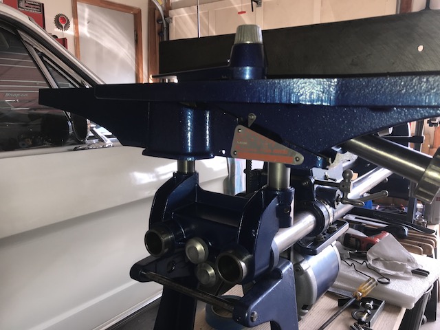

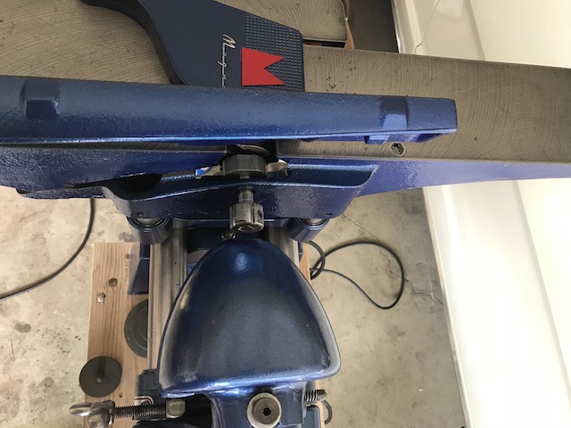

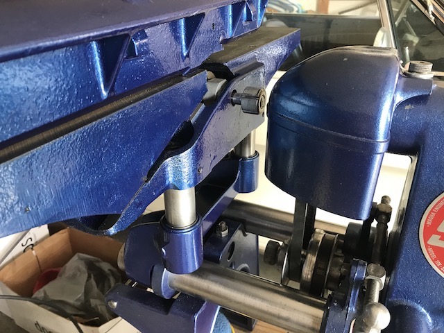

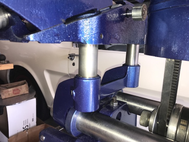

Well The SPT adapters arrived and they fit great. I just have to get two more parts and I'm in business. Here are some pictures.
- SPT "A" adapter

- SPT "A" adapter
- IMG_2480 copy.JPG (92.28 KiB) Viewed 19877 times
- SPT "A" adapter
- IMG_2479 copy.JPG (86.82 KiB) Viewed 19877 times
- SPT "A" adapter
- IMG_2481 copy.JPG (90.89 KiB) Viewed 19877 times

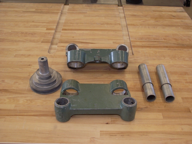

BuckeyeDennis wrote:Is that an original Magna SPT adapter?
Yes it is. That is the "A" adapter. That is the one you see most often. I don't know why since the MK 5 adapter kit for the 10ER was only sold as a complete kit as far as I know. It included the "A" and "B" adapters, the head stock pulley with the MK 5 SPT drive extension and mounting tubes.
The picture shows a complete kit.

The "A" Adapter is the most commonly seen since the first kit only had it. The "B" Adapter came later. Below is the instructions for both kits. I have the complete second kit as shown in John's picture and an additional "A" adapter. Notice that the Jig Saw and Sprayer are the only SPT's shown for use with the first kit. They are run off the Quill instead of the Headstock Pulley end. The Jointer still needed to use the Model 10 mounting kit. As more SPT's came available the "A" and "B" adapter kit came out. The Model 10 mounting kit was discontinued. Because of their design the Jig Saw, Sprayer and later the Belt Sander could be run from the quill side. With the introduction of the Band Saw and it's need to be mounted and run on the pulley side the same as the Jointer the later kit with the "A" & "B" adapters and special headstock pulley came out.That is the "A" adapter. That is the one you see most often. I don't know why since the MK 5 adapter kit for the 10ER was only sold as a complete kit as far as I know. It included the "A" and "B" adapters, the head stock pulley with the MK 5 SPT drive extension and mounting tubes.

The height collars were included with my adapters
