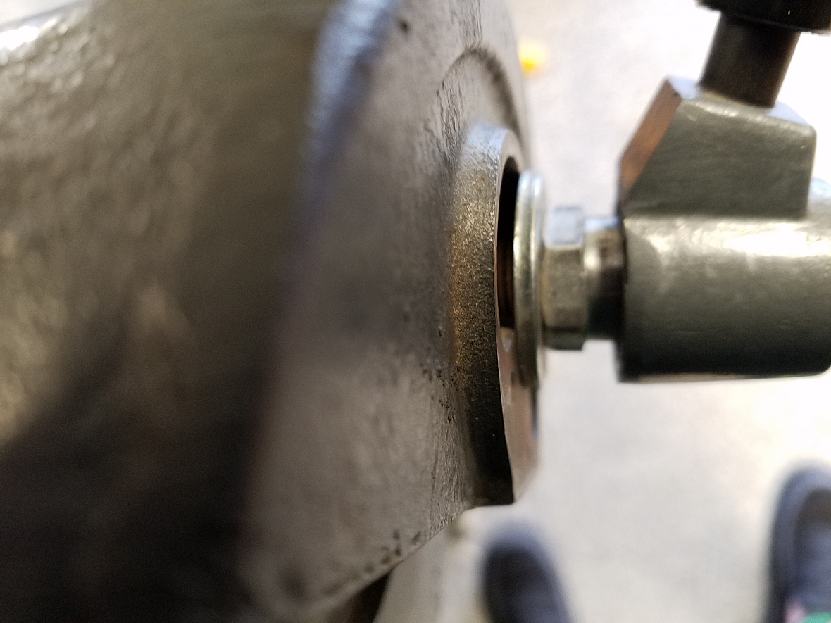

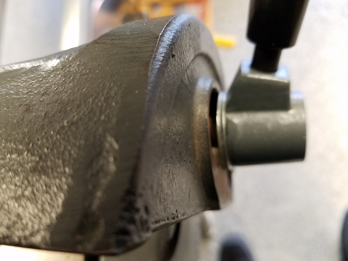

Re: The wisdom of the masses
You mention the fact that the far end of the fence moves back and forth (indicating that it is NOT locked) but you do not mention tilt. If you have been able to tilt and lock the fence, you have found lock. The other becomes available when you pull on the lock handle.
Lock Handle Pushed In (Tilt)
Lock Handle Pulled Out (Left/Right) Fence Position
With the handle as shown in the later image you should be able to lock the left/right movement of the fence. What you see in this image is the lock nut for fence tilt.
What you see in Dusty's two pix is the nut that locks the fence tilt angle. What you cannot see is the bolt that the handle engages when pulled out(as shown in the second pix). That bolt advances/retracts against a pin that presses against the rail and secures it laterally. If that pin is 'missing' it ain't gonna lock. The pin is simply a steel dowel.

JPG wrote:What you see in Dusty's two pix is the nut that locks the fence tilt angle. What you cannot see is the bolt that the handle engages when pulled out(as shown in the second pix). That bolt advances/retracts against a pin that presses against the rail and secures it laterally. If that pin is 'missing' it ain't gonna lock. The pin is simply a steel dowel.

Well how clever is that!
My pin was in there, just gunked pretty well, so after some scrubbing and a bit of bar keepers friend, it's shiny and slick again! I put a touch of graphite on there and squared it with the table! The more I learn the more impressed with the details I am.
A word of caution when securing the fence laterally(now that it works :cool: ). Do not do a gorilla impersonation when tightening the lateral clamp. The open slide back on the fence will open up with too much clamping force.
