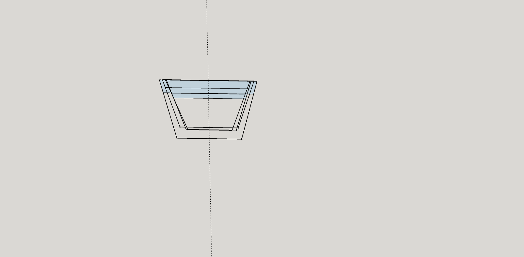

Someone in this thread stated: "Assuming you have the right belt"
This triggered by curiousity. (doesn't take much to do that)
I measured the four motor belts that I have for the Shopsmith. They were all purchased from Shopsmith but at different times. Two are marked with a Shopsmith part number. One is labeled Perelli and one is totally unidentied (no markings).
The one with no markings I purchased from Shopsmith to have as a spare. I suspect that this was during a time that Shopsmith experienced a quality control issue with a manufacturer. I understand from conversation here on the forum that that manufacturer has been dropped from the approved vendor list (just rumor and supposition).
My only point. A comparison of the physical profiles of these four belts.
Motor Belt Profiles
Motor Belt Profiles
Motor Belt Profiles.png (13.97 KiB) Viewed 16473 times
The horizontal line in each profile is the fiber line that has been mentioned. Location seems to be random.

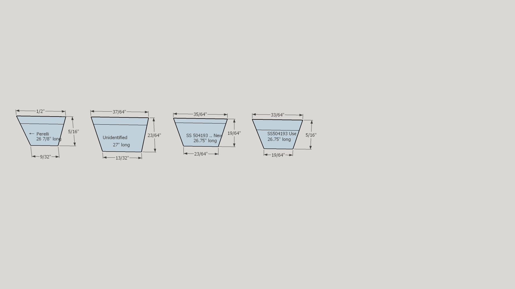

Posts: 34655
Re: V-belt replacement
I also am curious. What are the markings on the obviously larger profile belt and and what is it's width at the widest(top)?
ORRR what are the top width dimensions on those marked.(and what the marking is)
Can I correctly assume they are not all 'new'.
Interesting asymmetry.
Posts: 21372
JPG wrote:I also am curious. What are the markings on the obviously larger profile belt and and what is it's width at the widest(top)?
I think this will answer all your questions. The Perelli came out of the Shorty when it was being reconditioned. The unidentified is new and came from Shopsmith. One of the two with SS P/Ns is new. The other is like new but was in my go to machine. The OD of the unidentified is 1/8" shorter than the others which all measure 26 3/4".
Motor Belts
Motor Belts
Motor Belts.png (35.71 KiB) Viewed 16451 times

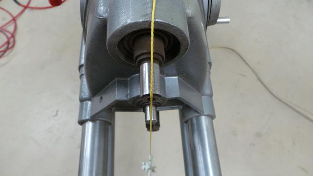

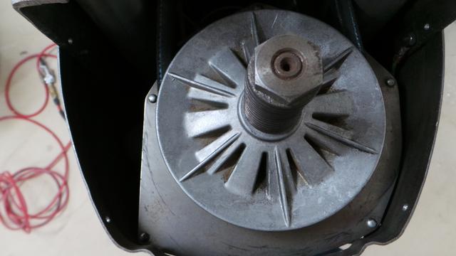

I've installed the new belt. I see what appears to be a problem. The belt rides against the waytube! It can be seen in Pic 3 best.Image
"The older I get..The better I was"
Posts: 21372
roneg wrote:https://s.amsu.ng/RJkoersxAqsN

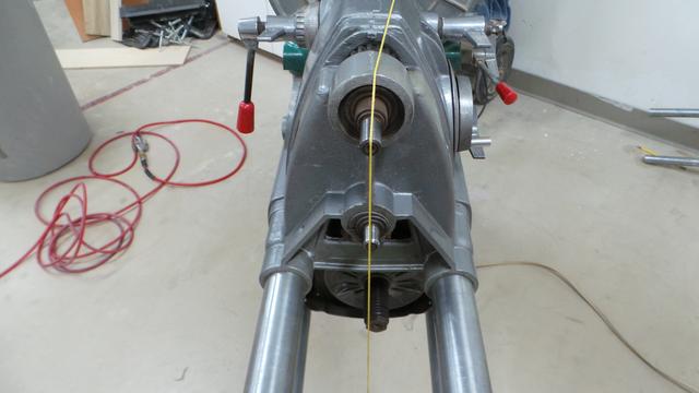

Yes, I can see your concern. It is hard to tell from photo images but it looks to me as though the motor hangs off to one side more that the other.
With the belt cover removed and the headstock in horizontal (saw) position, I would check to see that the three shafts (quill, idler, motor) are all three inline. Just drop a plumbline down from the center of the quill shaft. It should center on the motor shaft.
If you check the belt at midrange (speed) does it make a difference?
roneg
Posts: 101
Joined: Fri Mar 17, 2017 12:01 am
Post by roneg »
It's hard to get a good perspective on three shafts. But I was able to tell the motor is off slightly. Honestly..I don't know how everyone's doesn't get this way. From what I can tell the only solid mounting point is the this sheet-metal shroud? I can take a 1x1 , and lodge it on the left side of the wat tube , and the right side of the motor shaft and get the motor ,and shroud to move to the left 1/4 to 3/8 inches! There must be a way to adjust this, but I've yet to find a mention of it. Any good ideas? Also in the process of learning tug and push while clinching a flashlight in my mouth..I striped the gears on the speed-dial handle! So I'll be either ordering one from SS or using the guy on fleebay that rebuilds them. Any thoughts?ImageImageImageImageImage
