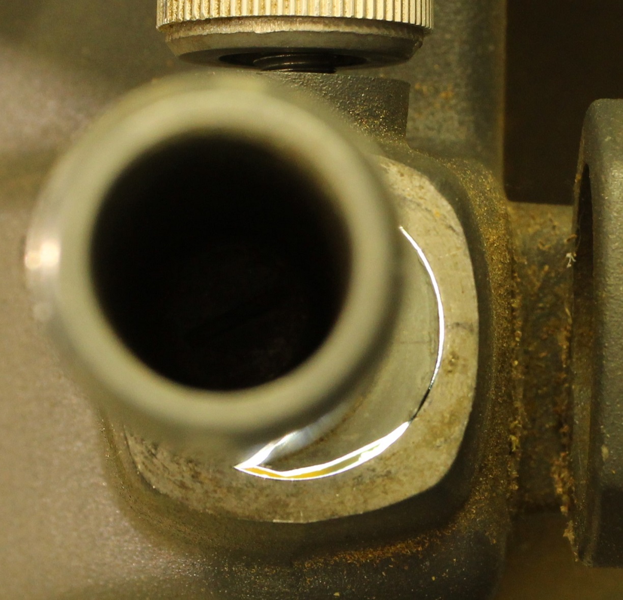

A summary of my assessment of my equipment: Mounting the eccentric tubes with no SPT revealed that equal clamp pressure did not result in equal stability. Front tube would rock, left to right, and continue to do so at very high clamp pressure. Anomalous clamping in the front mounting hole appears to be caused by a high spot at the front edge, essentially directly across from the SPT clamp engagement point. Behavior is analogous to clamping a pipe in a typical C-clamp. I suspect the high spot results from abnormal wear which results from improper SPT clamp adjustment, which in turn can result from the different clamp mount depths that are a feature of some headrests, including mine.
First photo is a standard eccentric for reference. It is rotated and back-lit for clarity to show normal clamping behavior. The engagement area is 180 degrees from the clamp.

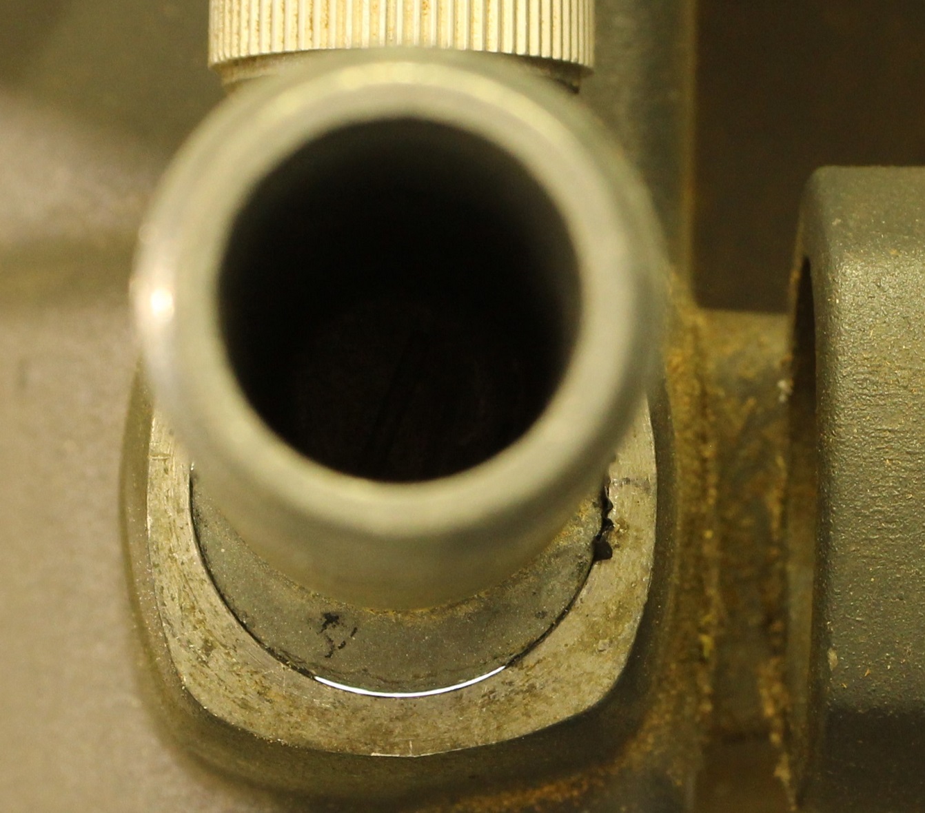

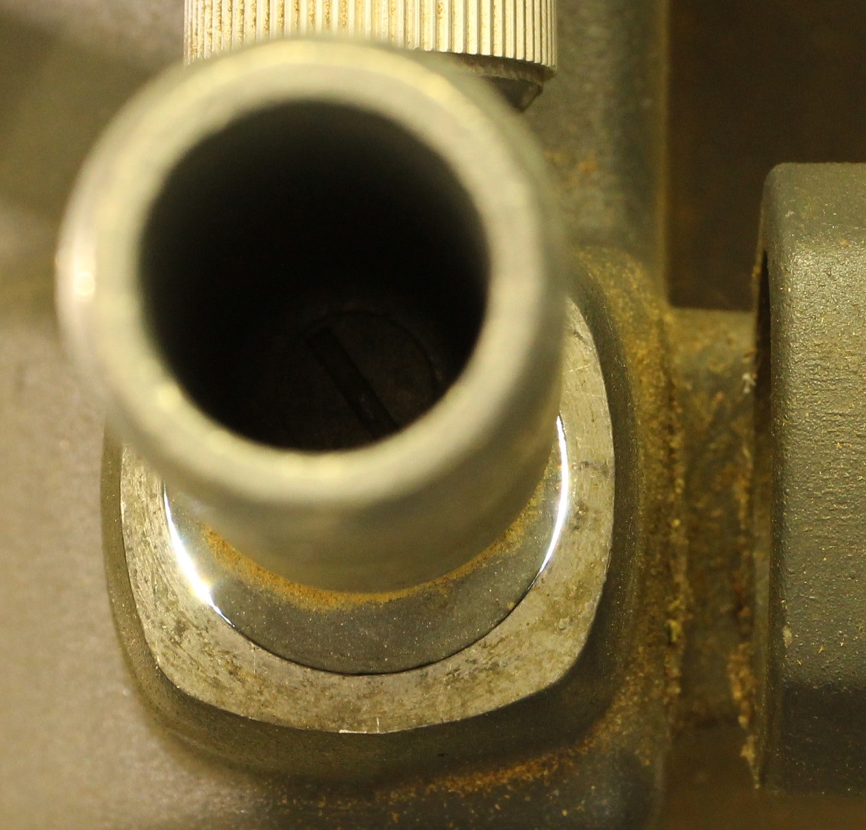

The second photo shows what I eventually determined was what I wanted to do. In order to get away from the mounting hole high spot, I wanted to eliminate the contact at 180 degrees and replace it with two contact points on either side. Through an iterative process I moved the contacts out farther than I originally planned, ending up with two contact points about 120 degrees from the clamp. There were two ways to move the contact point, adding material at the desired contacts or removing material from the undesired point. I removed material because adding it didn't occur to me. I don't endorse removing material. Adding material has several benefits over removing it. So I borrowed algales's suggestion of shims and blended it with my idea of using three 120 degree surfaces instead of two 180 degree surfaces. The shim stock I have wasn't suitable, the photo captures the intent using electrical tape in lieu of a good shim. Note the clearance 180 degrees from the clamp.
Removing material worked fine, but is somewhat crude. The main reason that I think the shim method would be better is that the shims will give the eccentric a radius very close to the radius of the mounting hole over the contact area. Either method will move the center of the mount to the front (removal) or rear (shim) and necessitate rotation of the eccentric to correct spacing of the SPT mount portion. The shim method would allow iteration if necessary, the removal method is unforgiving. I used a series of flats that I made with the disc sander (520 table was far superior to my old 500 table for this, no comparison) and radiused the last flat with a belt sander to blend it with the untouched portion of the tube. It is imperative that the flats are straight so that the new contact area is straight up and down in the mount. The third photo is my modified tube, note the clearance and new contact area, the other contact area is occluded by the SPT portion of the tube in the normal rotation.
I doubt that I could think of, or list, all of the cons of this approach. I'm only including it here to enhance people's understanding. Note, for example, that the eccentric is designed for +/- 90 degree rotation off nominal for +/- 1/4 inch horizontal alignment. With the modification done like this, I'd guess anything over 15 degrees, perhaps less, would significantly degrade performance. Its one redeeming quality is that it works, significantly improving stability in this one headrest. As I stated in a previous post, improvement in a good mount was negligible. Bottom line is I do not recommend this, even though it worked. If I tried again, I would find a way to make the shim method work.
