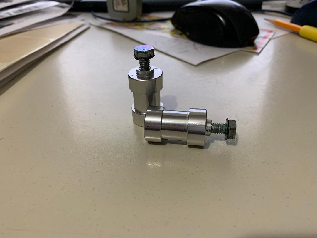

in case you got one of these and kept it.... and have some thoughts or needs for some 20mm parts and don't mind them being a loose fit in a 20mm hole and wanted some reason to save these two extra parts.... in case someone comes up with a use....

I was about to toss these in my recycling bin for metal bits when they felt familiar, like as in 20mm dogs. Tried them in a couple of holes on the MFT like drill press table and sure enough they are pretty close. Close enough that I think I will keep them, well at least for a while just encase.
