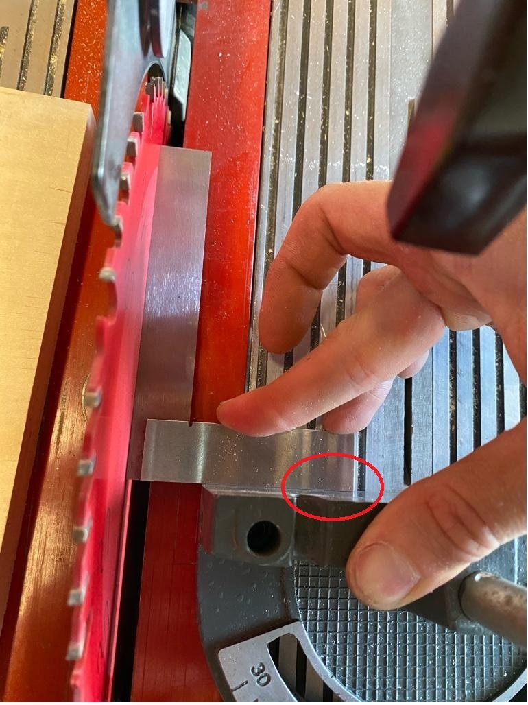

Have you checked your miter gauge with a larger square? I am including your picture below. It is hard to tell from a picture, but to my eyes it looks like you have the long edge of the square snug against the blade across its entire length. However, the short end of the square looks like it is contacting the outside edge of the miter gauge, but on the inside edge where I drew a red oval around it looks like there is a small gap which would explain why your crosscuts are off. It might be worth a second look at your miter gauge to check for square. Possibly use a larger square if you have one, or try flipping your square around so that the long end reaches across more of the miter gauge face. You could also use the square directly on the miter gauge to set the face square to the miter bar (rather than checking miter gauge<->sawblade). Just some thoughts...

I can't tell from these pictures but the one expanded image from RF Guy does seem to reveal a gap (out of square indicator).

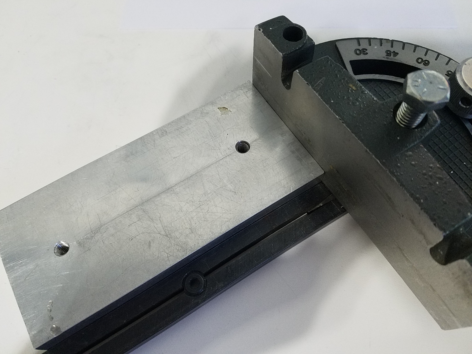

The attached image shows how I do "quick checks" of my miter gauge.
The aluminum block (one of several) was originally milled to be a setup block for a piece of precision equipment. It is as perfectly square as will ever be required for me. Anything similar that you have would work for this purpose.

My post disappeared. When I first looked at RF Guy's reposted pic I thought it was a gap also. But now it looks to be a reflection from the polished face of the miter gauge. The camera is a bit past vertical revealing the face. There is a VERY slight gap at the extreme right end of the square's handle but I would think that it insignificant.

wa2crk wrote:My post disappeared. When I first looked at RF Guy's reposted pic I thought it was a gap also. But now it looks to be a reflection from the polished face of the miter gauge. The camera is a bit past vertical revealing the face. There is a VERY slight gap at the extreme right end of the square's handle but I would think that it insignificant.
Bill V
I would not argue about that BUT a square with a leg that extends all the way across the face of the miter gauge would increase reliability of the measurement. Even my method is questionable.
