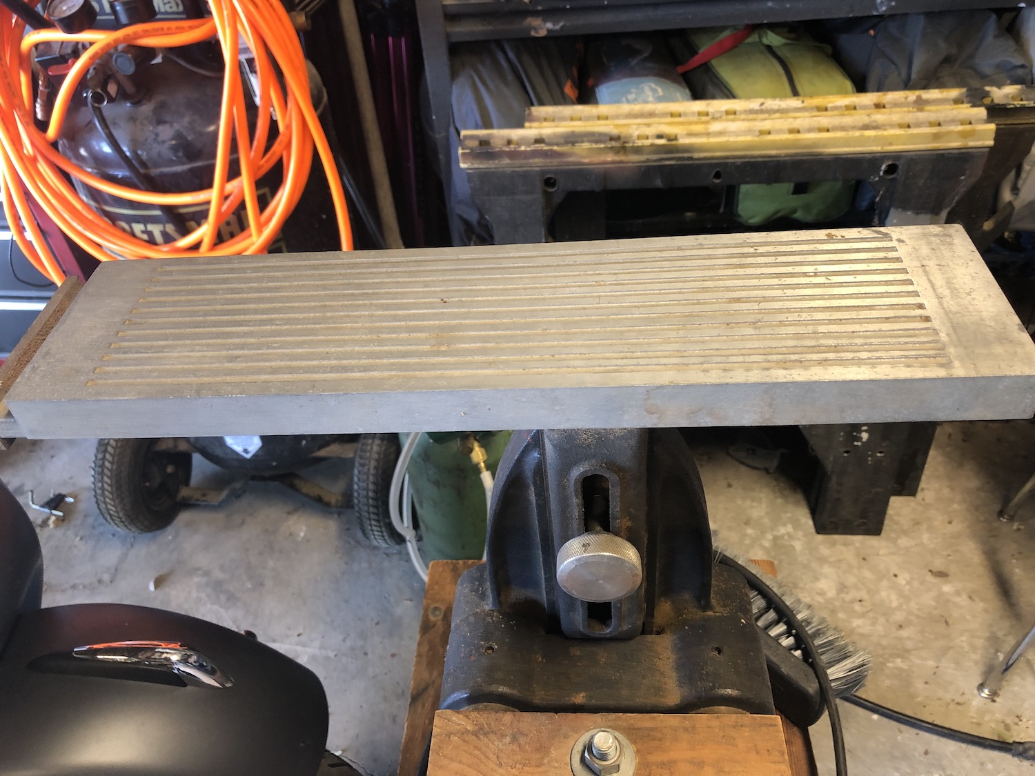

I purchased a 10er #81734 from the original owner yesterday. I'm trying to upload photos of it, but am havin' issues. The tubes on this one seem thick and the extension table is aluminum.
I don't have a standard saw blade arbor for it. Any suggestions?

JimJimJim wrote:I purchased a 10er #81734 from the original owner yesterday. I'm trying to upload photos of it, but am havin' issues. The tubes on this one seem thick and the extension table is aluminum.
First welcome to the forum. All of your questions will be answered here.
For pictures, see the "How to Post a Picture" topic at the top of this forum.

I've got it backwards..
extention table.jpg (393.14 KiB) Viewed 15906 times
end tubes.jpg (424.39 KiB) Viewed 15906 times
Thanks for the help.
Posts: 6585
Re: Shopsmith Model 10's What When and Where
Nice looking machine with a speed changer. Those are worth $150 by themselves. It should clean up very nicely. Search the forums, lots of pictures of refurbished Model 10's.

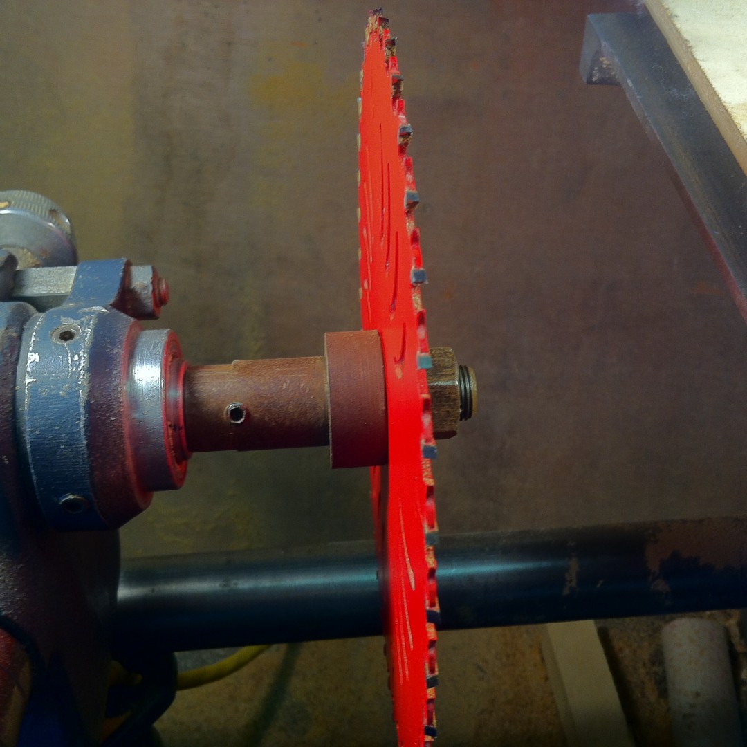

Can I use the dado arbor for one blade table saw work, or do I need a standard shorter arbor?
The one on the right is a 1/2" shaper adapter. The other is the dado saw arbor the machine came with.
There's all sorts of odds and ends I have no idea where they go or do.
Congratulations, and welcome aboard.
At that time there wasn't a dedicated saw arbor, there was just the 5/8" universal arbor. (and a 1/2" universal arbor)
The universal arbor came with three spacers, two thin and one thick, only two of which would be used at a time, (one thin and one thick for a saw blade, two thin for dado blades or thicker accessories.)

Sweet. That's what I have. Thank you very much.
