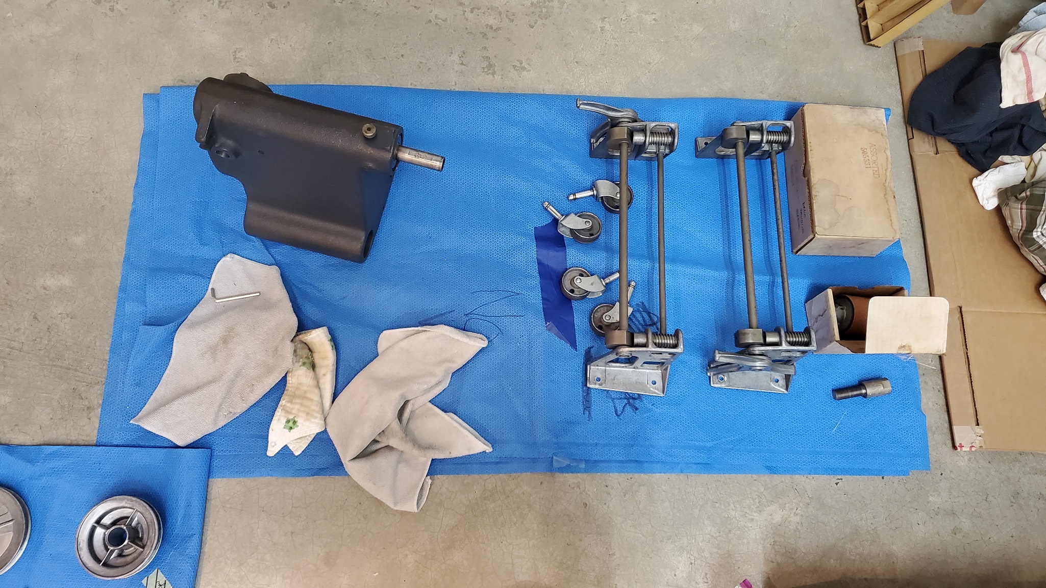

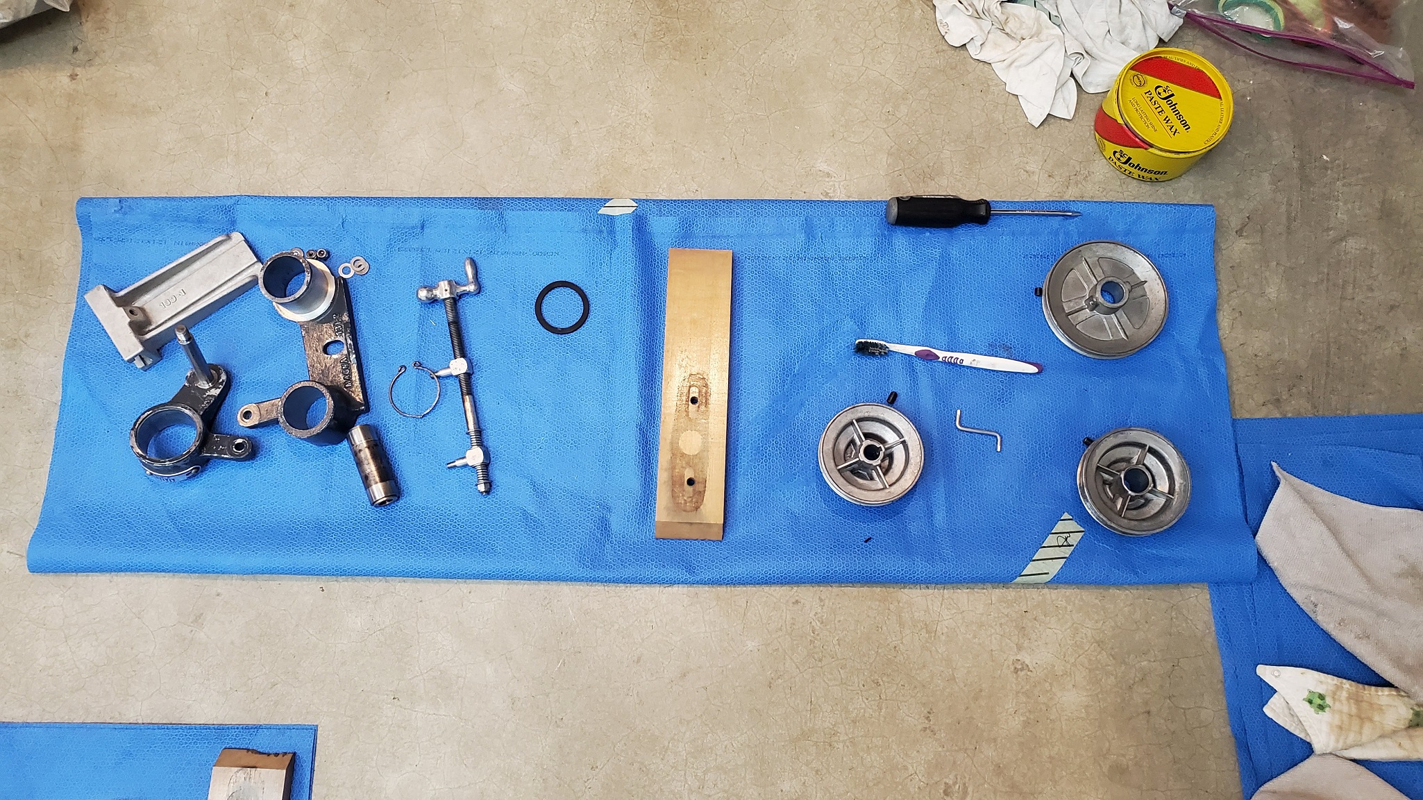

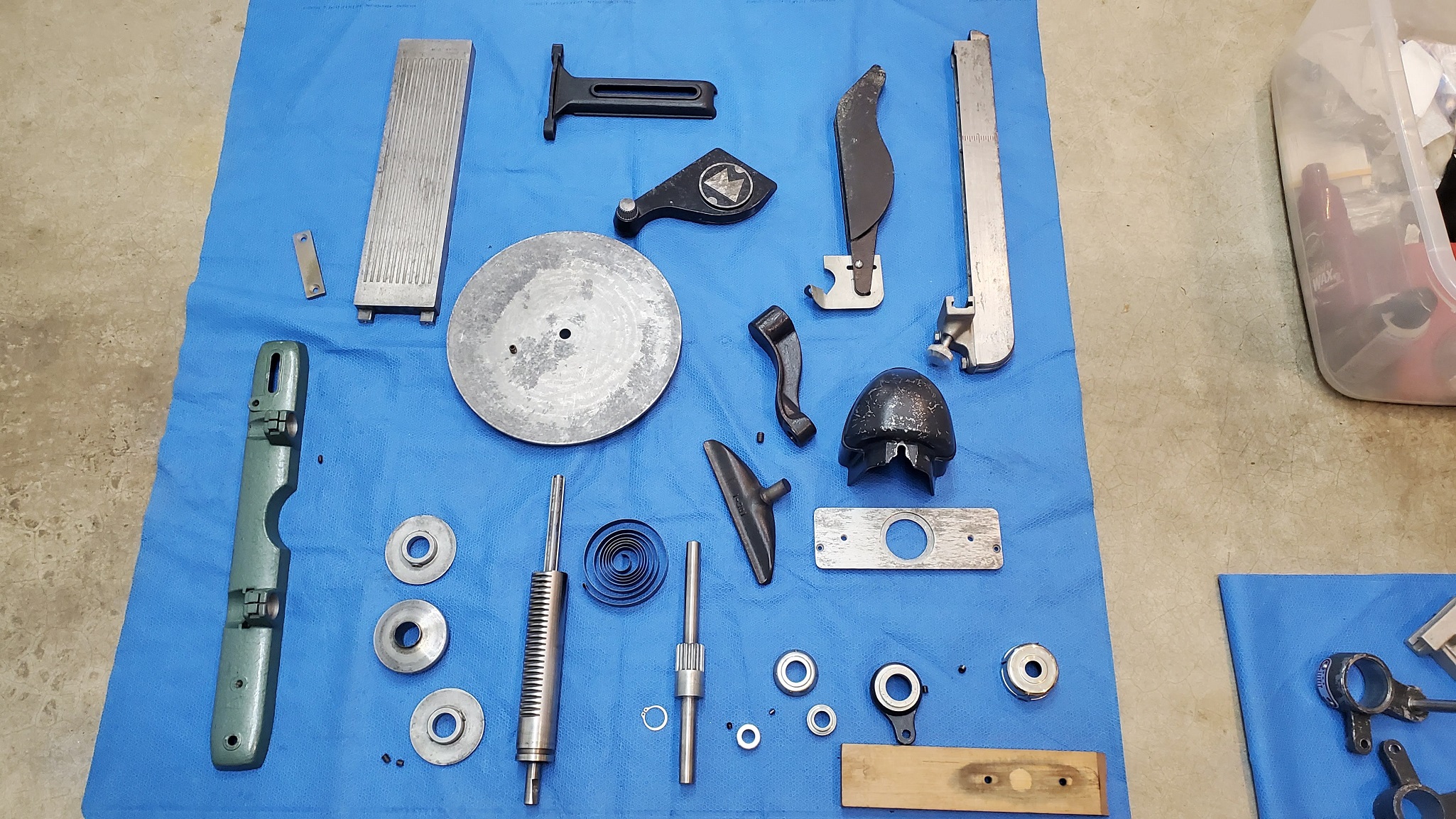

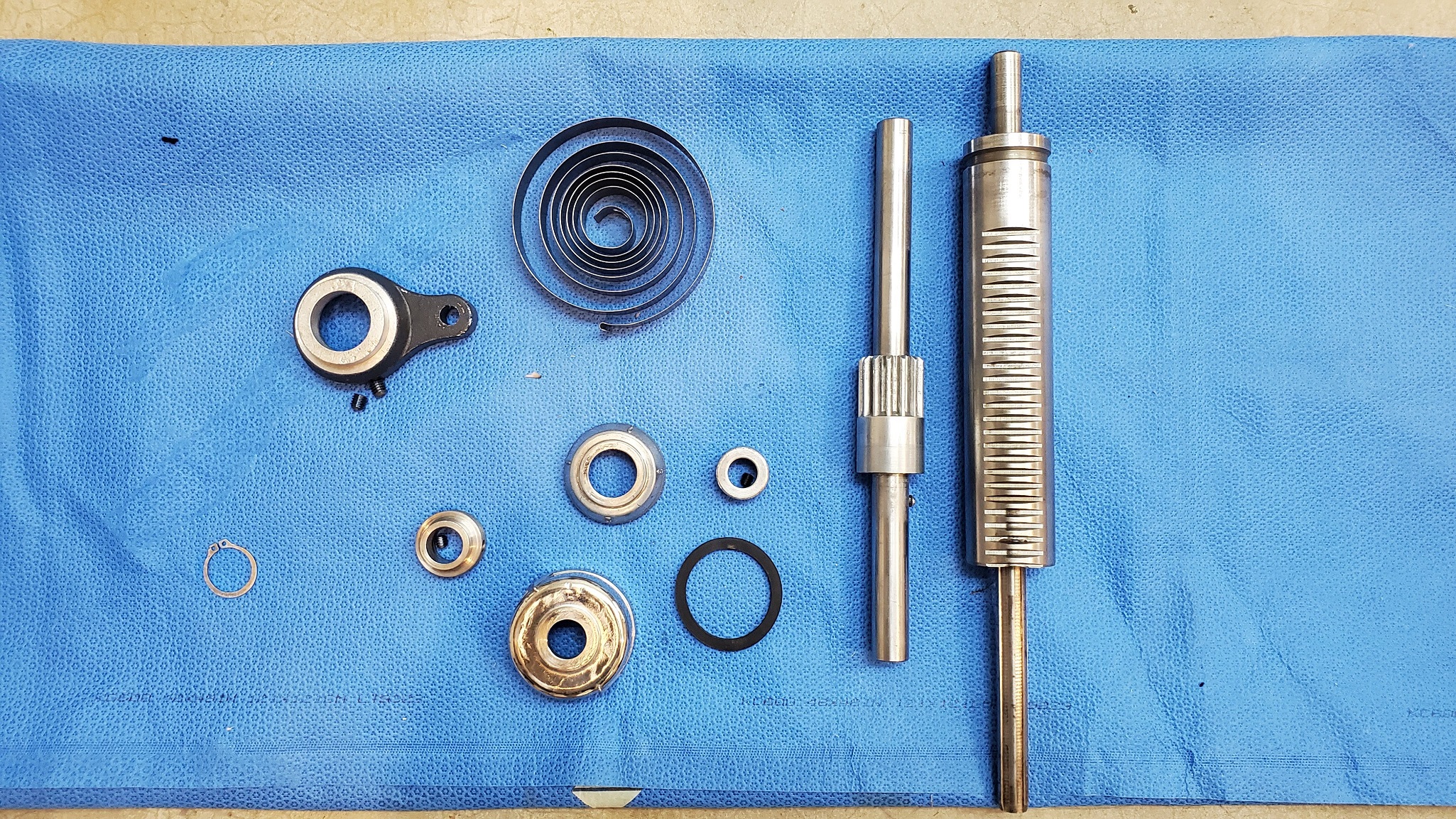

More progress photos -
- Cleaned/derusted/waxed and ready to assembly
- 20200618_222742.jpg (878.64 KiB) Viewed 9545 times
- 20200619_001655.jpg (931.59 KiB) Viewed 9545 times
- 20200619_001703.jpg (1.05 MiB) Viewed 9545 times
- I ended up having to take this apart thinking the bearing was bad, which ended up being a small piece of metal? stuck between the spindle and quill inside the gauge collar that was causing a occasional hissing sound.
- 20200618_222714.jpg (1.45 MiB) Viewed 9545 times
- 20200619_001709.jpg (941.41 KiB) Viewed 9545 times

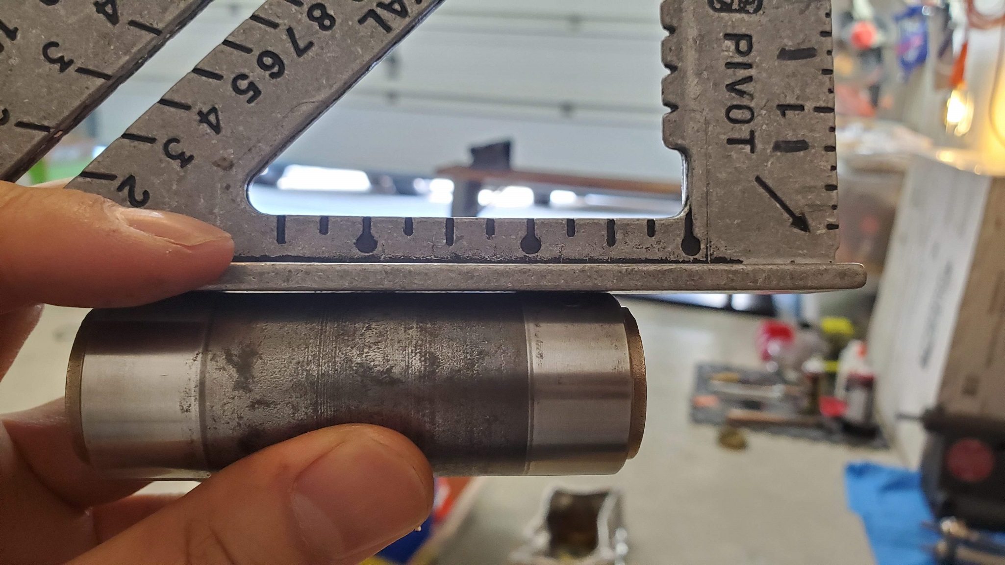

Re: Craigslist find = New project 10ER
Question 6: I'm concerned with the wear on the speed changer pulley shaft and thinking I may need to find a replacement. I put it against a flat edge and it looks like there is two low spots from the center pulley near the ends.
Q 6-1: Is this typical?
Q 6-2: Can and should I try to send this out?
Q 6-3: Should I start looking on Ebay for a replacement?
re the speed changer shaft, it is quite worn, someone in it's past did not believe in lubrication.
However, I would not give up on it just yet. The two outer sheaves are fixed and the center sheave should only slide back and forth, not be spinning on the shaft. I would try cleaning and polishing the shaft (and lubricating), and then see how it works.
Mine had some corrosion, I polished it using the lathe function.
https://www.shopsmith.com/ss_forum/view ... 76#p232776

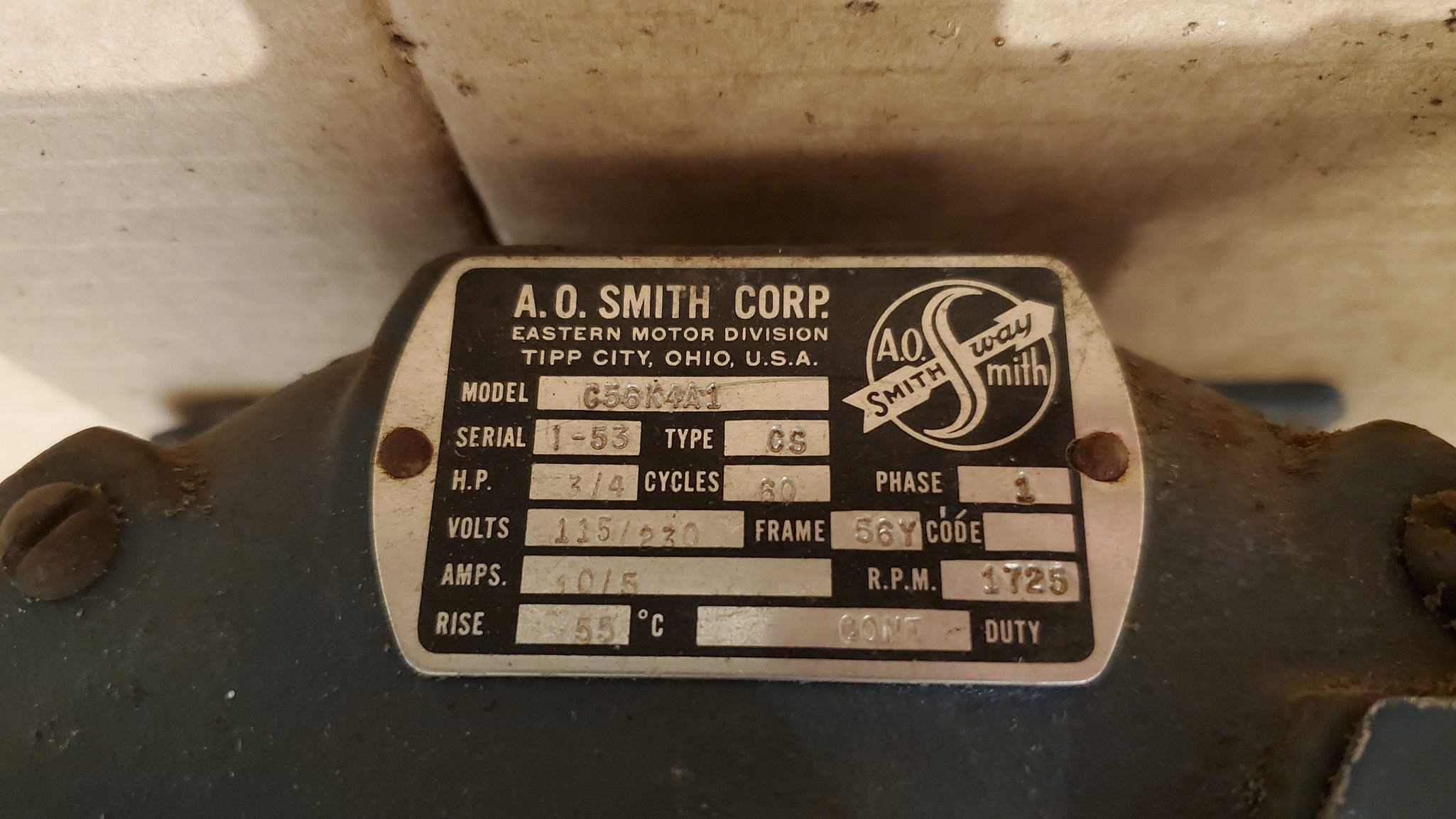

Update -
Got the motor rewired and put back together, but not getting any power - doubled checked my work and found the on/off switch is bad (no continuity between one of the path).
The switch is rated 12AMP-125V.
Question 7: is this the correct rating for my motor?
- 20200603_205517.jpg (671.86 KiB) Viewed 9272 times
- BuckeyeDennis
- Posts: 3800
- Location: Central Ohio
The amperage rating is OK, but it doesn't tell the whole story. You need a motor-rated switch, designed to withstand the high startup inrush current and inductive load of an induction motor. Specifically, you need switch that's rated for at least 3/4 hp. They're not hard to find -- most any good hardware store should have them.
