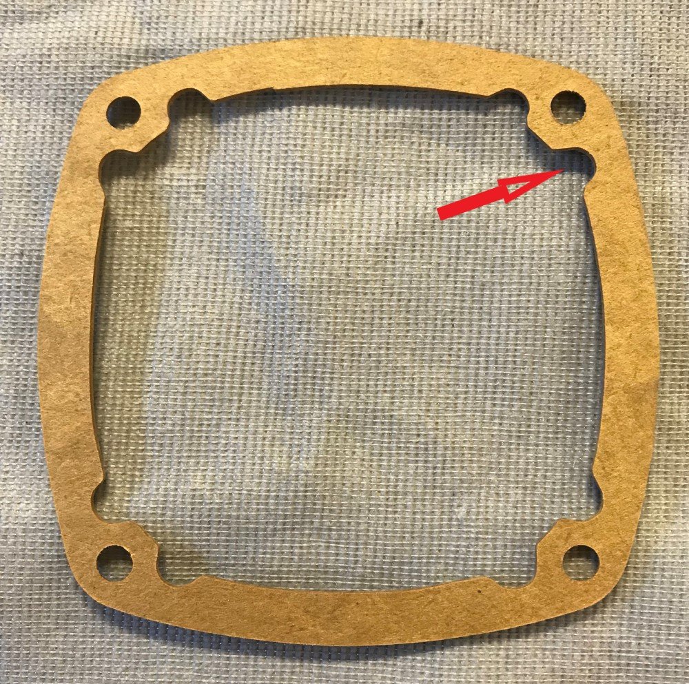

JPG asked

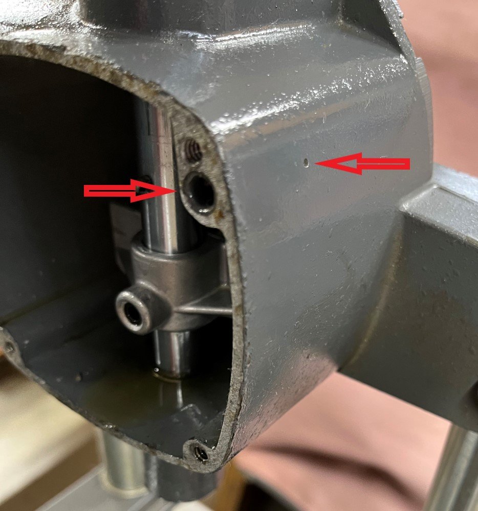

Did you block the weep/pressure relief teeny tiny hole?
This is important to watch for when making a replacement gasket for the Jigsaw. That small vent hole is on the upper right side of the housing when looking at it from the cover side. There is a hole in the housing below the upper right mounting screw hole for the vent. That must not be covered or blocked by a replacement gasket. The picture below shows an OEM Gasket and the arrow indicates the cutout spot to keep the vent hole open. The OEM Gasket can be installed in any position because that cutout exists in all 8 possible points needed.

The picture below shows the vent holes in the Jigsaw Housing.
