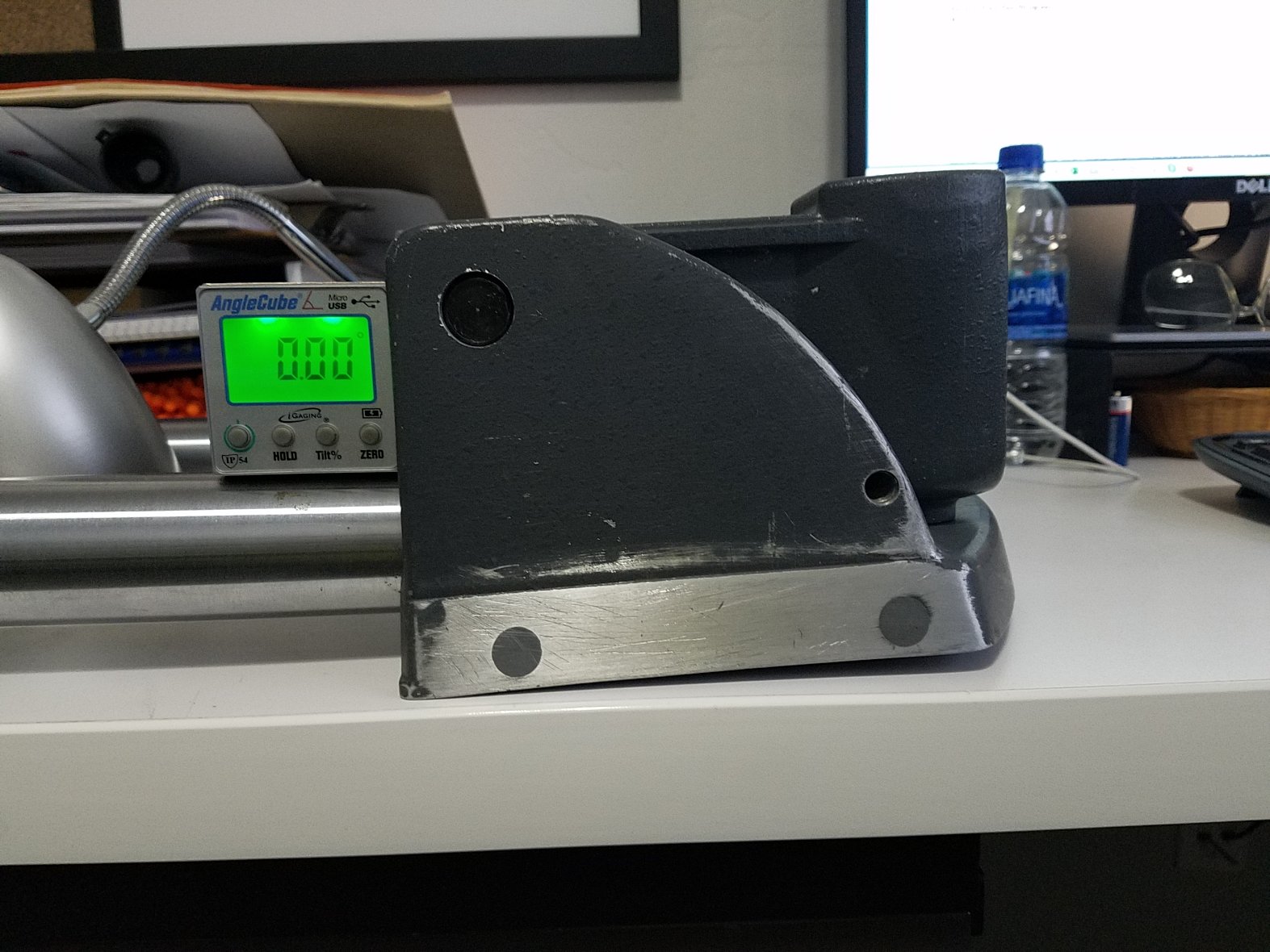

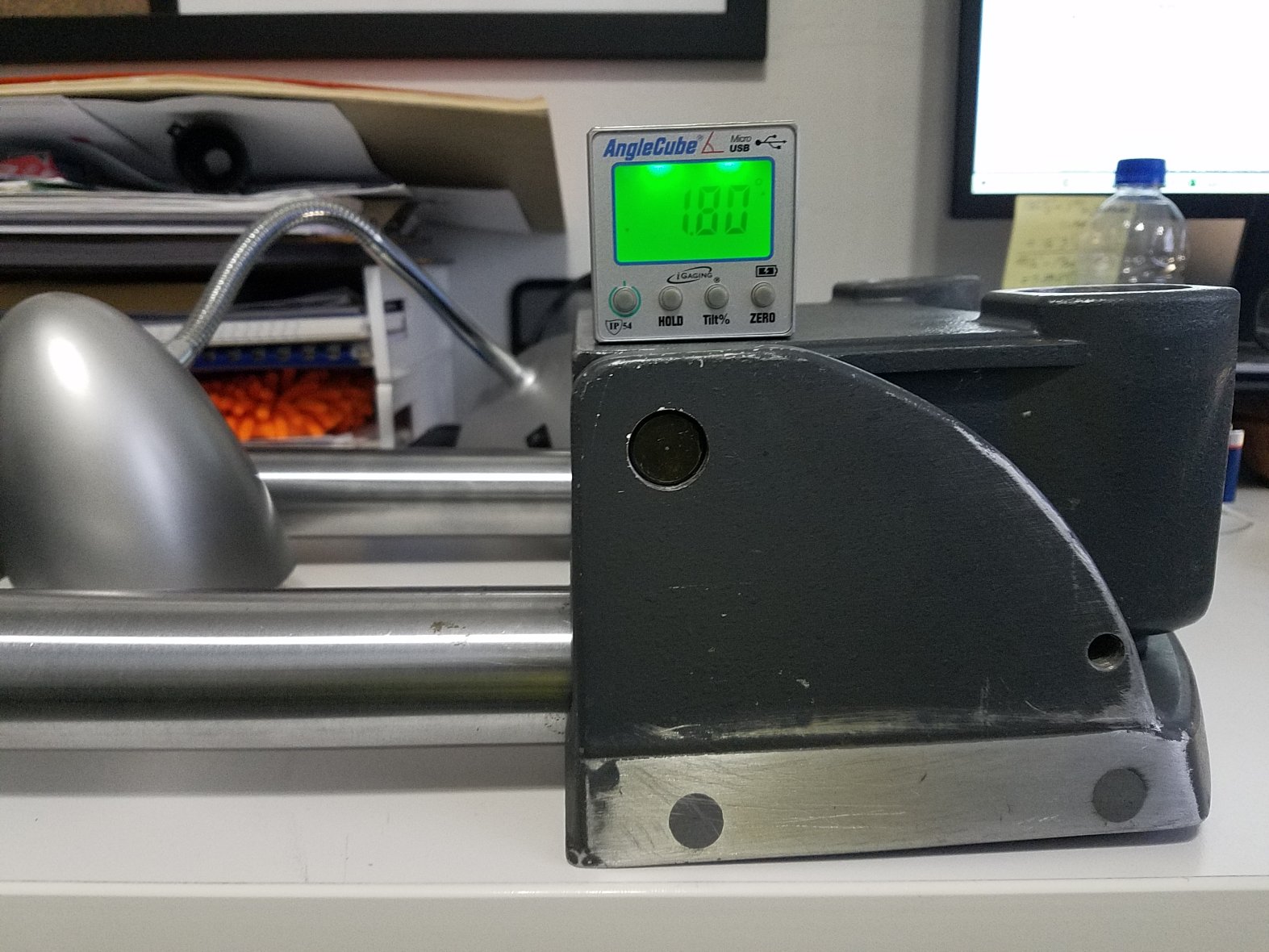

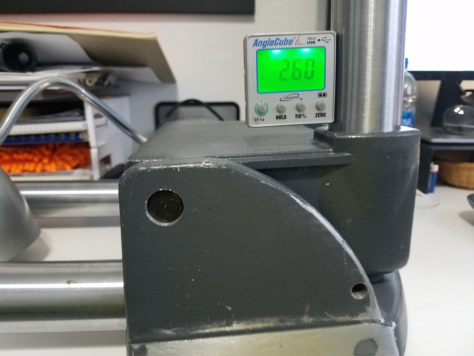

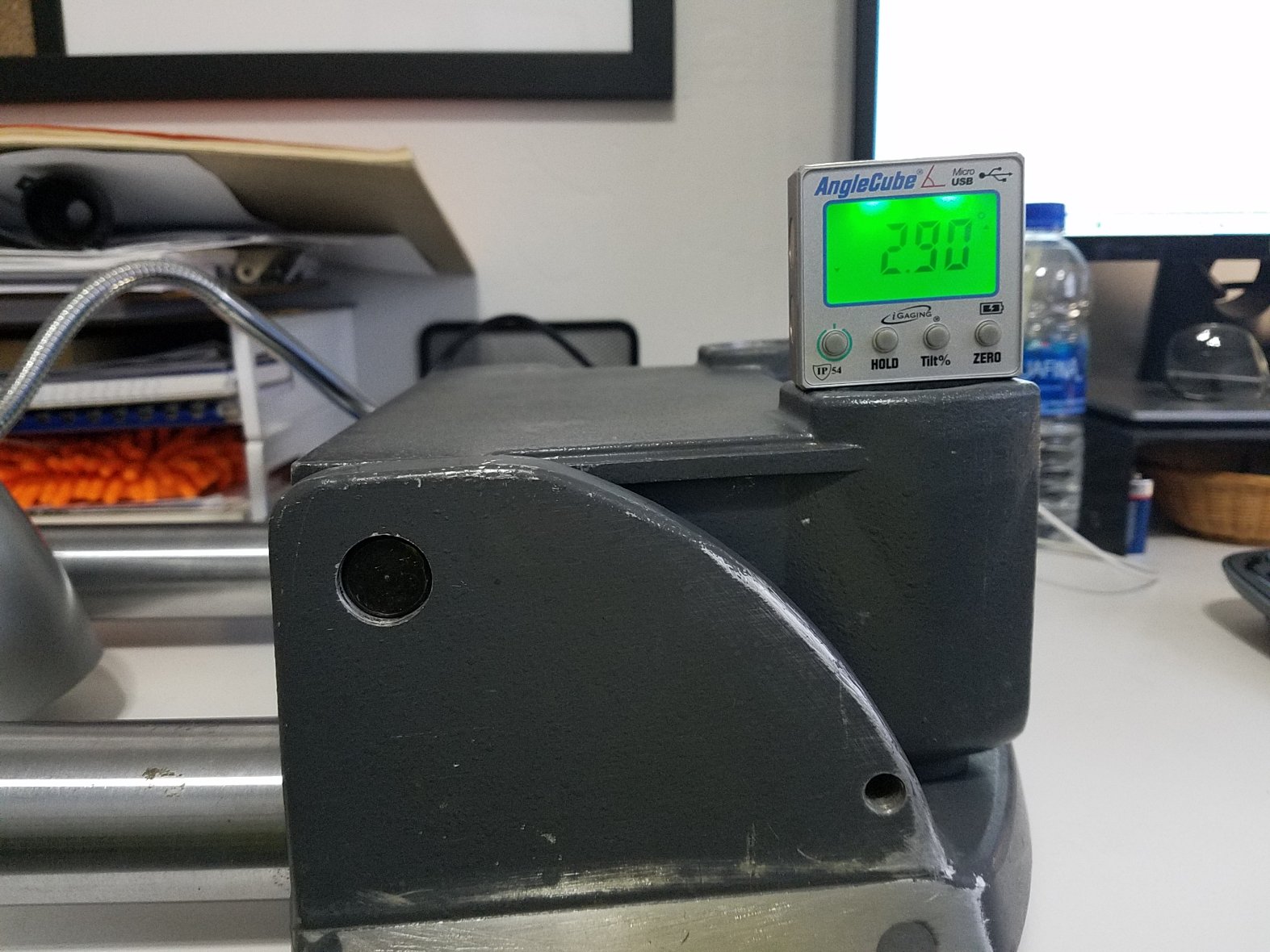

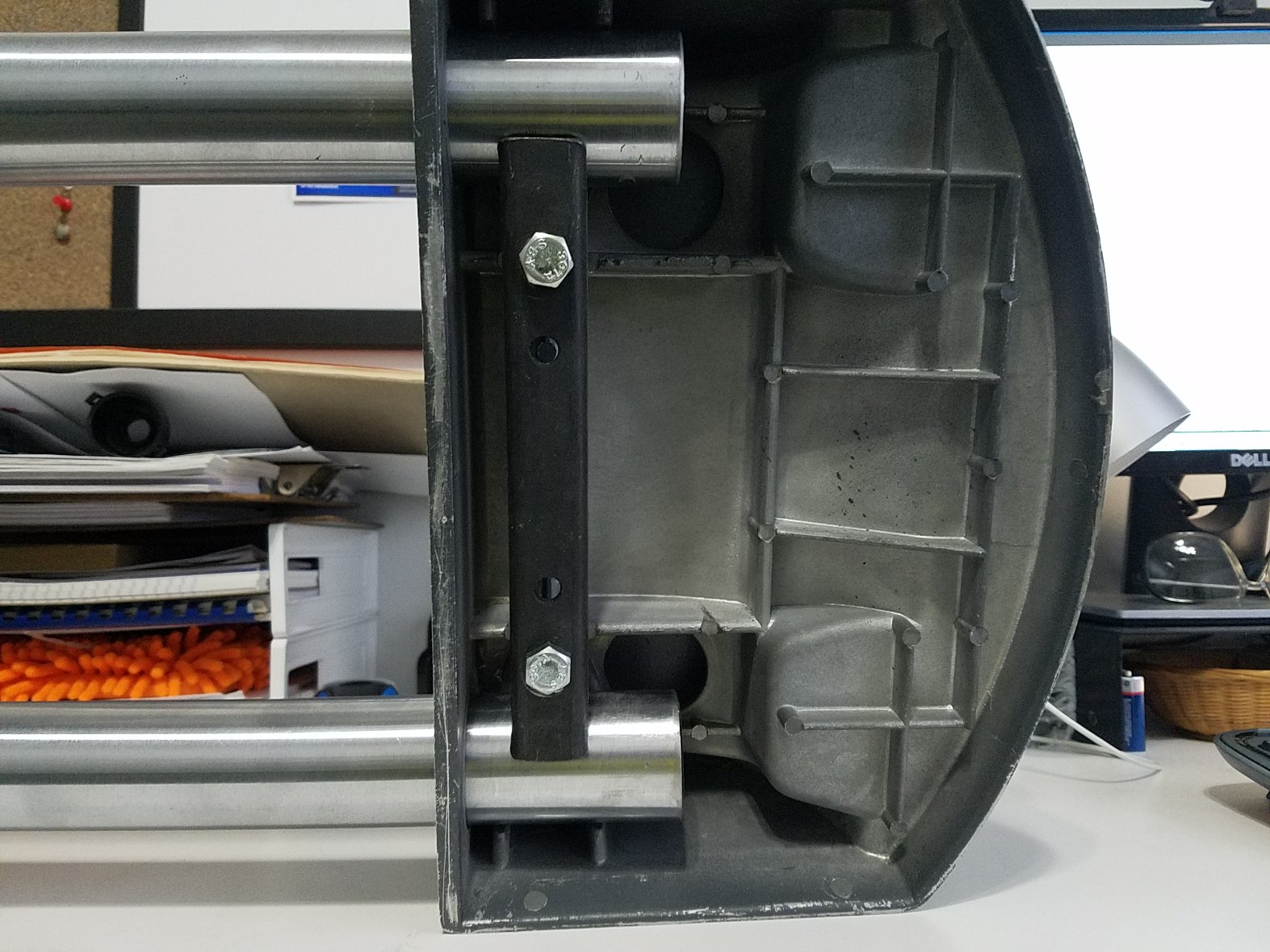

I bought into the idea that maybe, just maybe having the bench tubes inserted too far could cause the problem. The problem being that in vertical the tubes go 7° past vertical. I'm still sceptical so I mocked up my spare parts just to see what I might see.
Tubes over inserted
Tubes over inserted
Base no longer sets flat (level)
Tubes are not vertical
But tubes are not past vertical
Tubes are no where near 7° off vertical
