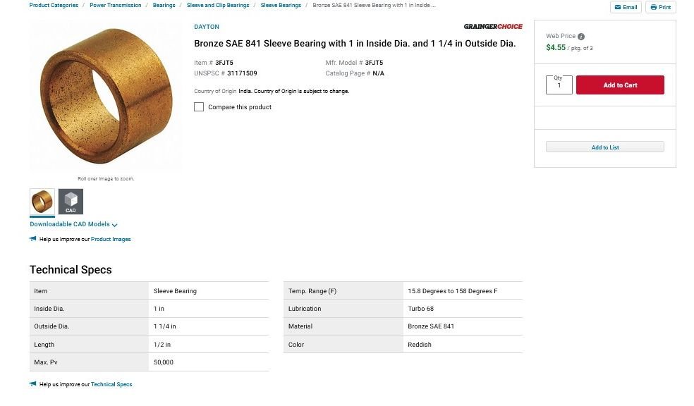

Well Dusty now we know why thee are seeking a 1" version of the micro adjuster. A hopefully better method of adjusting than tapping with a blunt object.
I like the idea.

DUSTY....
1 to 5.4 bushing.jpg (57.96 KiB) Viewed 6011 times
