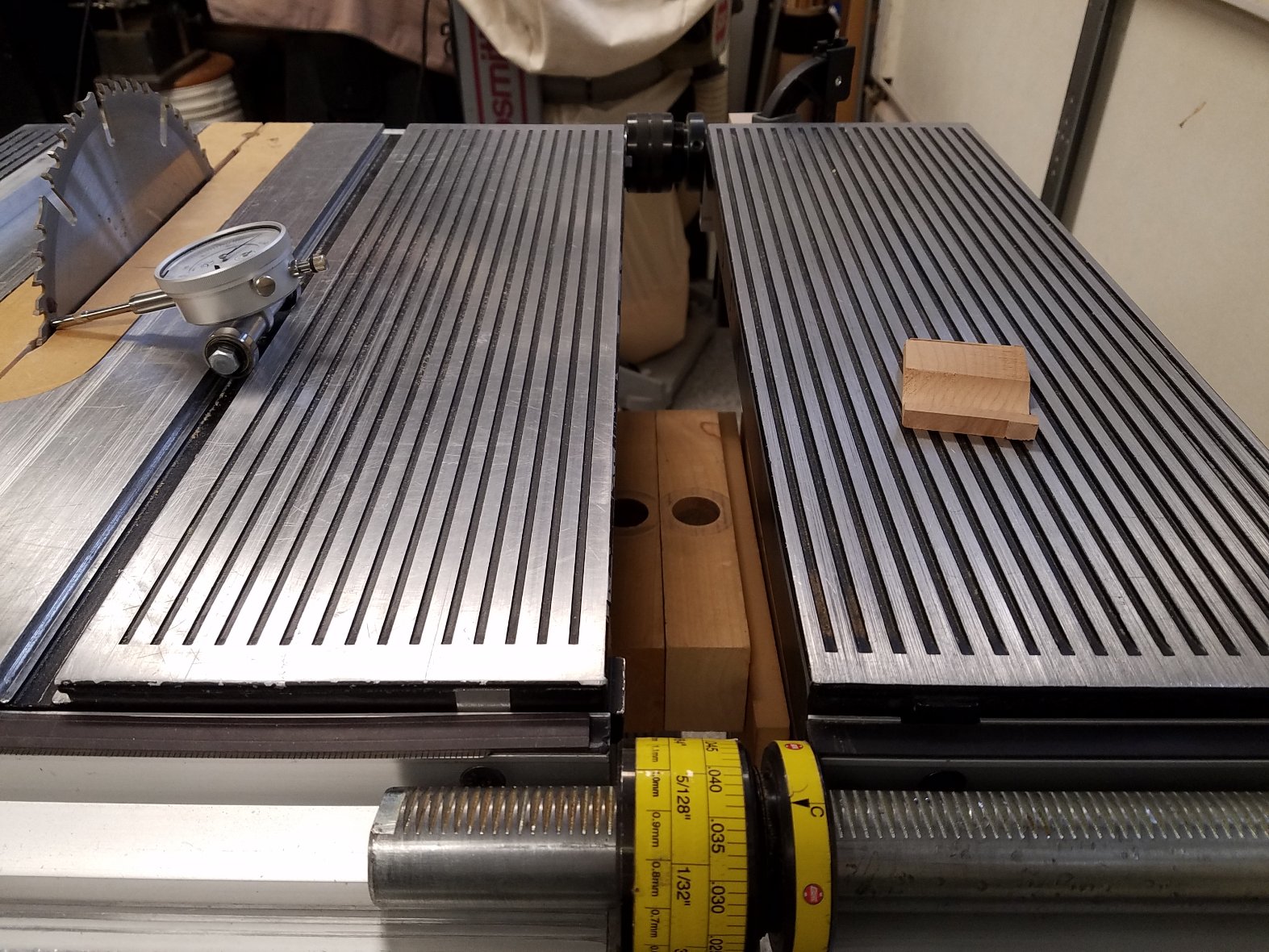

'll bet that this will work a lot better if I insert a pivot point between the Extension Table and the Main Table right inline with the spindle.
Theory being that the direction one side moves when the other is pushed/pulled will be predicable. Right now the Main Table moves in response to a stop collar adjustment but where.
Needs a Pivot Point
Needs a Pivot Point

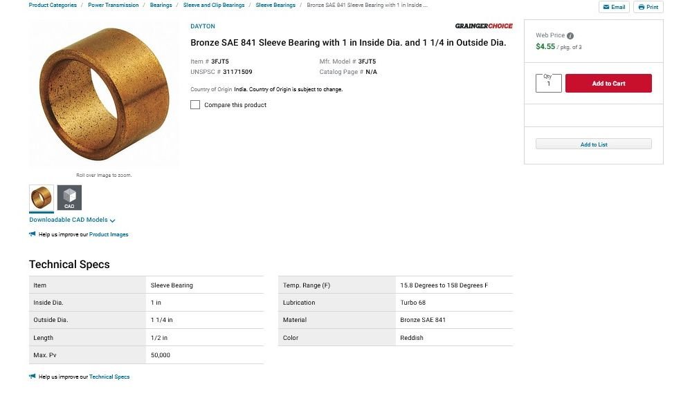

DUSTY....
1 to 5.4 bushing.jpg (57.96 KiB) Viewed 4967 times
Re: A view on alignment of the shopsmith.
Posted: Fri Jan 22, 2021 1:09 pm
by JPG
dusty wrote: Thu Jan 21, 2021 12:16 pm 'll bet that this will work a lot better if I insert a pivot point between the Extension Table and the Main Table right inline with the spindle.
A 'pivot' between the two tables would work better IF the collars were 'pulling'.
Since they 'push' a pivot needs to be on the other side of the main table.
If ya leave one bolt 'snug' it can be the pivot point.
Ideally the pivot location would be mid point rather than the quill (EQUAL/opposite direction).

It worked well! End of Story
Loosened all four trunnion bolts.
Push Main Table Hard Right.
Installed Pivot Point.
Checked For Parallelism With Blade.
Tweeked the Infeed Stop Collar.
Secure Trunnions/Main Table.
Rechecked for Parallelism.
Done.
That's My Story and I'm Sticking To It.

Where / how did you create the pivot point?
Posted: Sat Jan 23, 2021 8:41 am
by dusty
A c-clamp attach to the extension table in-line (between the two tables) with the spindle.
