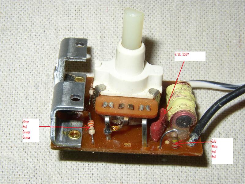

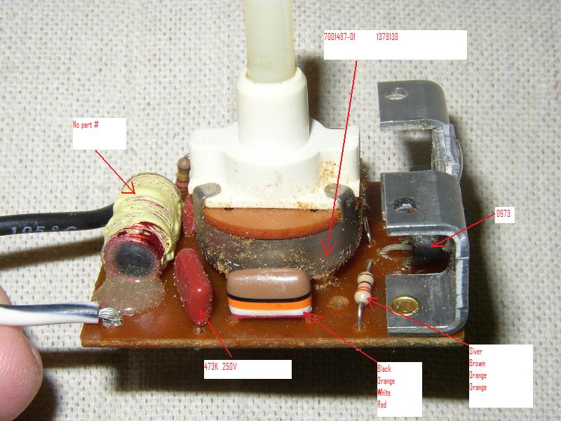

[ATTACH]2361[/ATTACH]
[ATTACH]2362[/ATTACH]I've annotated all of the parts as best I can. There are no hidden parts that I can find. What you see is what we have.

The "diode" is the four terminal block seen in the photo 026 (right above the power cord on the left). The DC from the rectifier is fed to the circuit board which basically contains a high voltage transistor (mystery part 0973) and potentiometer which controls the voltage fed to the "base" (control terminal of the transistor) so that the output voltage is controlled (somewhat). The whole circuit on the board is in series with one of the leads to the DC motor. Things probably fried when the DC motor stalled.

Yup, very observant of you John. I was engrossed with the circuit board while knowing there had to be a rectifier somewhere.
Therefore, the circuit board is nothing more than a bit of a filter and a means of varying the DC to the motor.
Yes, I think you have a keeper as long as you are willing to put in the effort to repair/replace the board.
