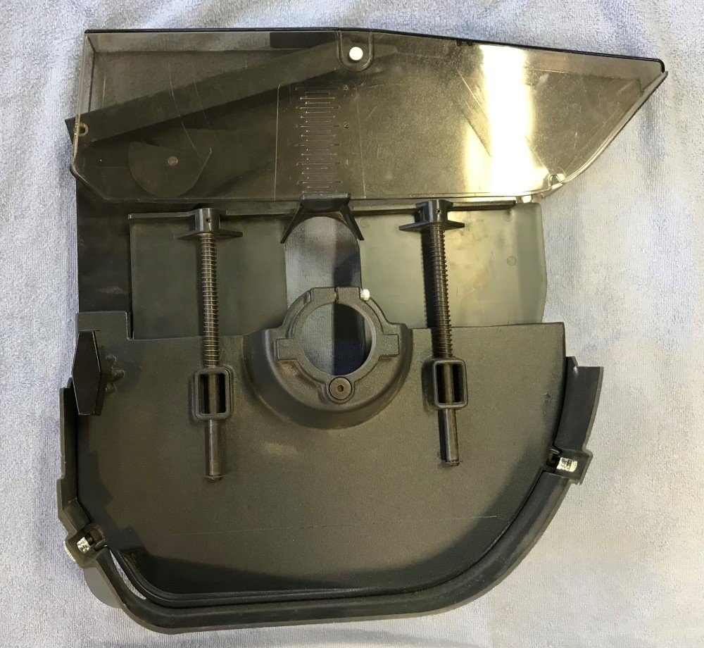

I have talked a little bit about the Saw Blade Guard Systems of the different models of the Mark 5/V before. Often in posts there are questions about which Saw Blade Guard the poster should get. For the Mark V 505, 510, 520 and Mark 7 that is an easy answer. There has been only one Saw Blade Guard System made for those models. So, what about the Mark 5 and Mark V 500. There have been several guards and an improvement made for them over the years. When it was introduced the Mark 5 did not come with a Saw Blade Guard but was an optional accessory the owner could buy. Now keep in mind the Mark 5 originally used a 9” saw blade and the original guard fit that size but not the later 10” blades.

The Saw Blade Guard to come next for the Mark V was part number 505875 made from sometime in the early 1980's until November 1987. It replaced P/Ns 505627 & 505628 on Mark V’s with Serial Numbers below 222396. It is a multi-part system with the upper guard mounting to the rear table tube and lower guard parts to quill and table trunnion. It had only a single 1-1/4" dust port. Made of plastic this was the first guard to have a clear upper guard allowing the user to see the blade. All the earlier guards were cast aluminum with other metal parts.

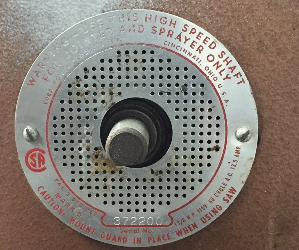

edma194
Posts: 2205
Re: Shopsmith Mark 5 What When and Where
Post by edma194 »
chapmanruss wrote: Wed Jun 30, 2021 2:00 pm One change to the Mark 5 I have always wondered about occurred in 1961 and I listed it in my post on March 27, 2021. It read
1961 Gilmer Drive changed to Poly V Drive. Serial numbers above 371347 are Poly V and 371347 and
below are Gilmer Drive. Units with a “C” at the end of their Serial number during this time require a special Quill. *2
I'm considering a Goldie with serial number 372579, I assume it will have a Poly-V belt. This would have been made in late 1961 or early in 1962 according to references. There are mentions of some Goldies made with 1 1/8HP motors but no clear indication of dates or associated serial numbers. This one is kind of far away and I'm not likely to get up and examine it anytime soon but I might be more inclined to make the trip if it had the larger motor.
Is there any record of serial numbers for the last of those Goldies and if some of them did have the 1 1/8 motor?
Ed from Rhode Island
Posts: 4523
The Mark 5 Goldie S/N 372579 was made in August 1961 according to the chart. The August and September starting numbers are actual and not estimates. It should have the Poly V Drive. As for the motor they changed to the 1-1/8 HP Motor by June 1961. Check the Vent/Serial Number cover plate on the belt cover. The original motor size is one of the items listed on it. That is if the motor has not been replaced. See the lower right side on the plate below.

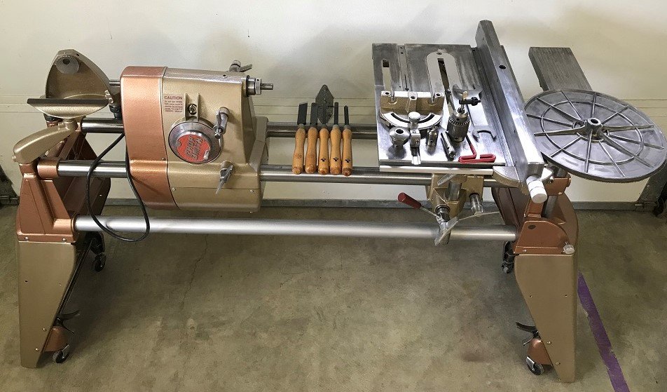

Posts: 4523
I have restored 1 Goldie and it came out beautiful. It was made in October 1960 but at some point the motor had been changed to the 1-1/8 HP motor. From time to time I wish I had kept it but I cannot keep all of the restorations I have done. Just not enough room.
_
IMG_0273 r.jpg (119.88 KiB) Viewed 9739 times
edma194
Posts: 2205
Post by edma194 »
That is gorgeous Russ.
