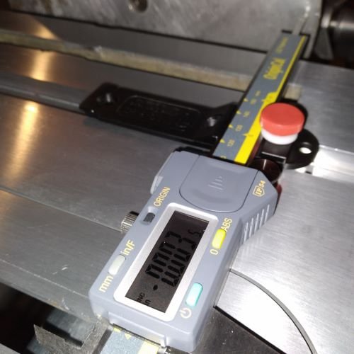

If this was of concern to me, I would be more interested in how the measurements react whenun locking and relocking the carriage while using a dial indicator. I would expect considerable movement but do anticipate that the precision would be retained.JPG wrote: ↑Thu Apr 15, 2021 12:23 pmFWIW ANY measurement should be done with all 'locks' locked.miken wrote: ↑Thu Apr 15, 2021 11:17 am. . .
For me, the device shows me the limitations of my saw more than anything. Once I move the table, or even unlock the trunnion, the measurement changes. I just did a test and locking the trunnion changes the measurement 0.005", unlocking it again brings the measurement back to 0.001", not to zero. Not enough to matter to me, but I can tweak the table for more precision when/if needed now.
Hope this helps, Mike -
I am curious if measuring with it locked then unlocking and relocking the trunion in that sequence also results in that 0.001 deviation between before and after.

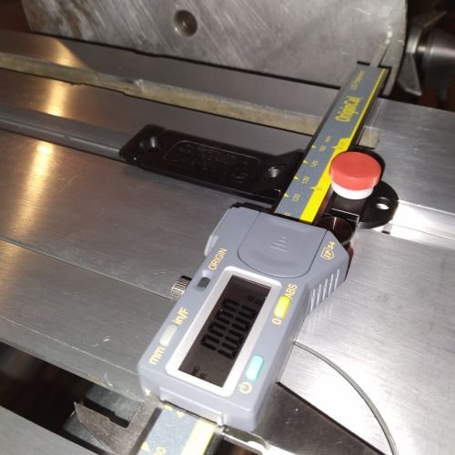

Yes, I believe you are both correct, and the precision does actually seem to be retained after locking and unlocking. The first pic below is it setup, trunnion locked, and the caliper zeroed out (pics not rotated this time
Mike -
