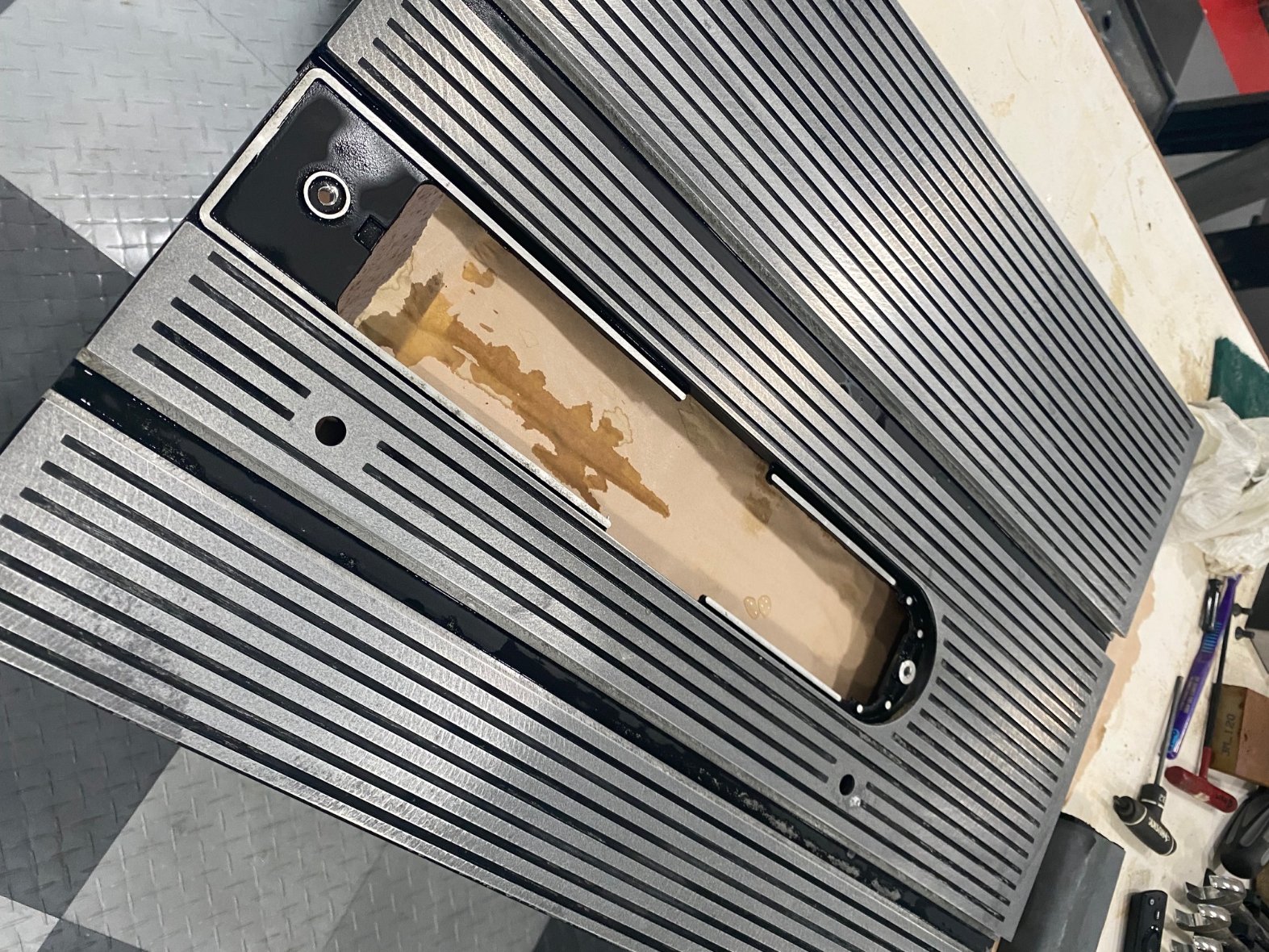

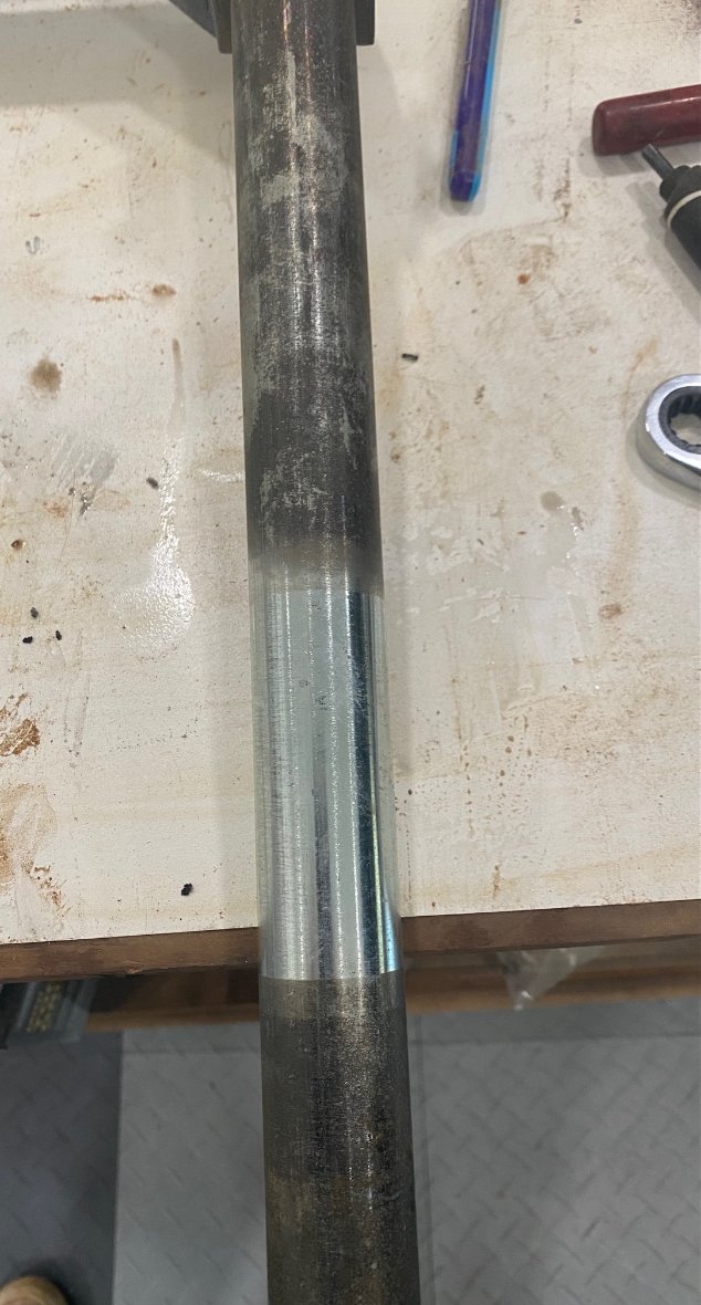

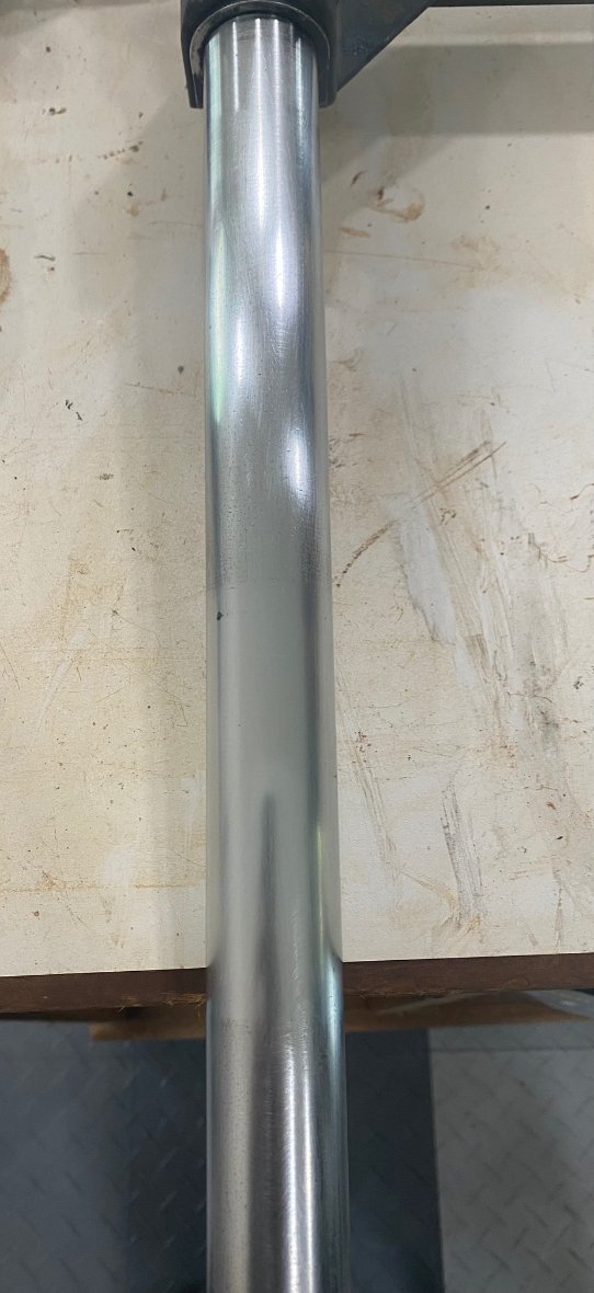

Working on the table base today, here the progress on the tubes, one before, one after
table tube 1.jpg (127.76 KiB) Viewed 889 times
table tube 2.jpg (88.76 KiB) Viewed 889 times

Some 1000 grit wet sandpaper and the table cleaned up nicely. Straight edge shows its still flat.
Posts: 4226
Re: Refurbishing a MkV 510
I am looking forward to the finished tool. So far it is looking great.

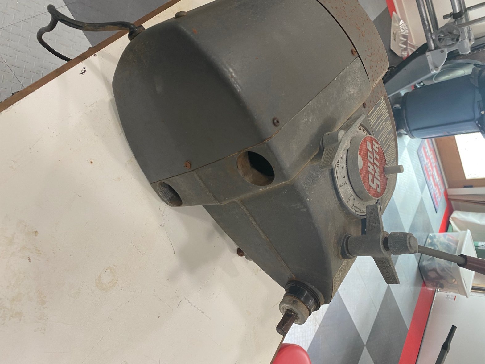

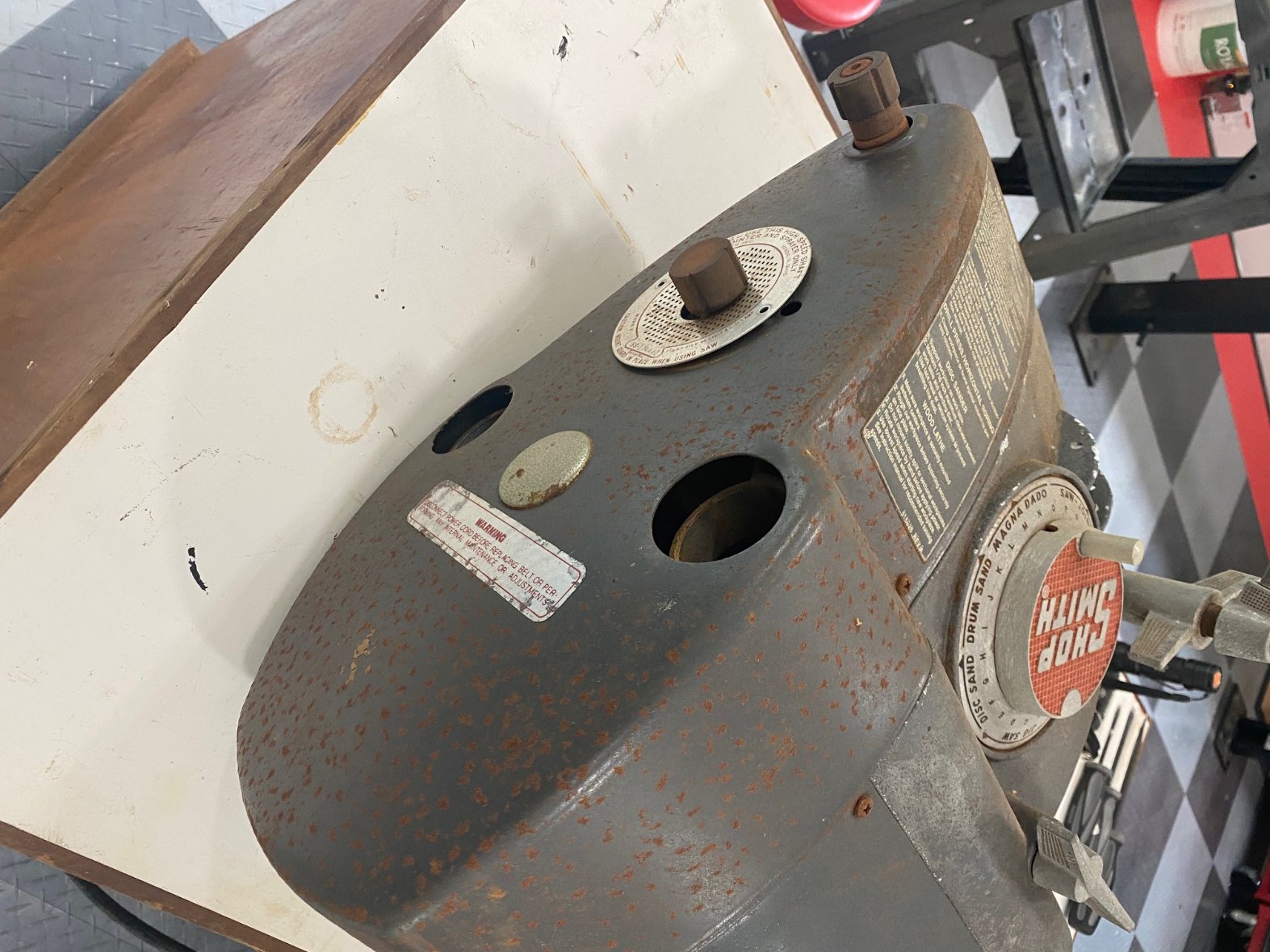

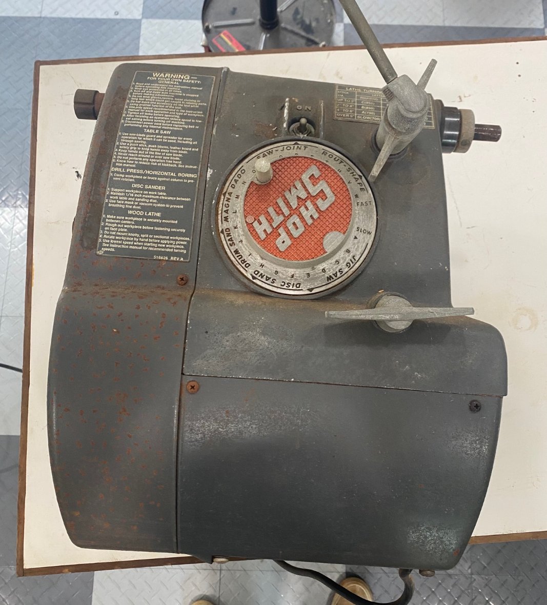

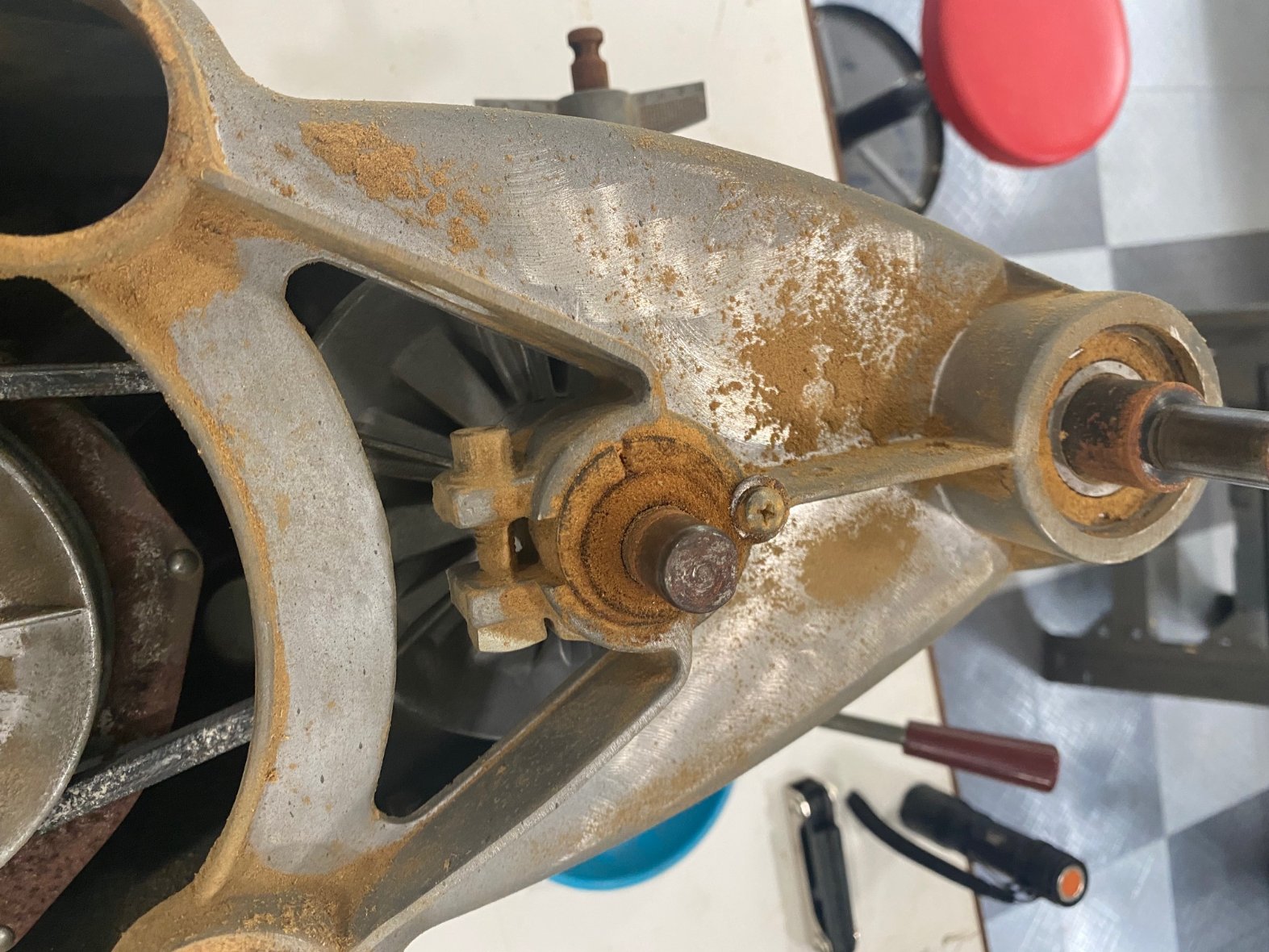

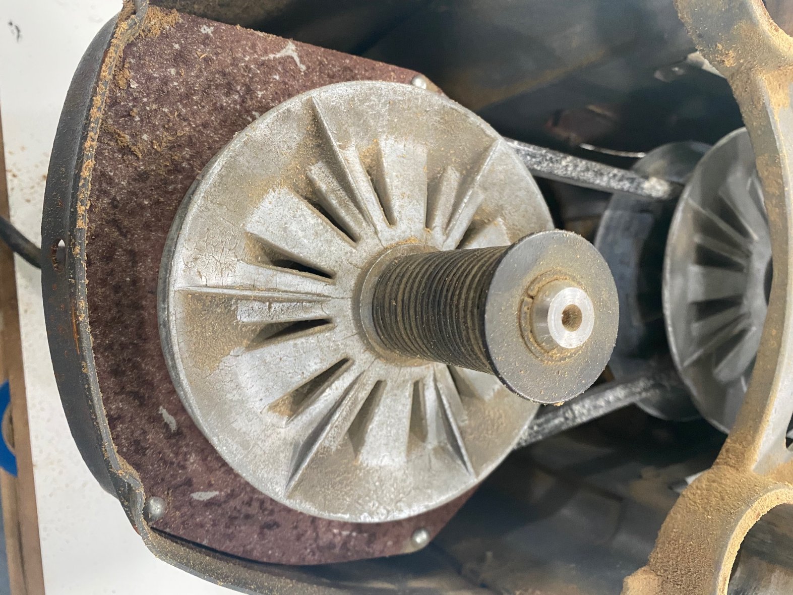

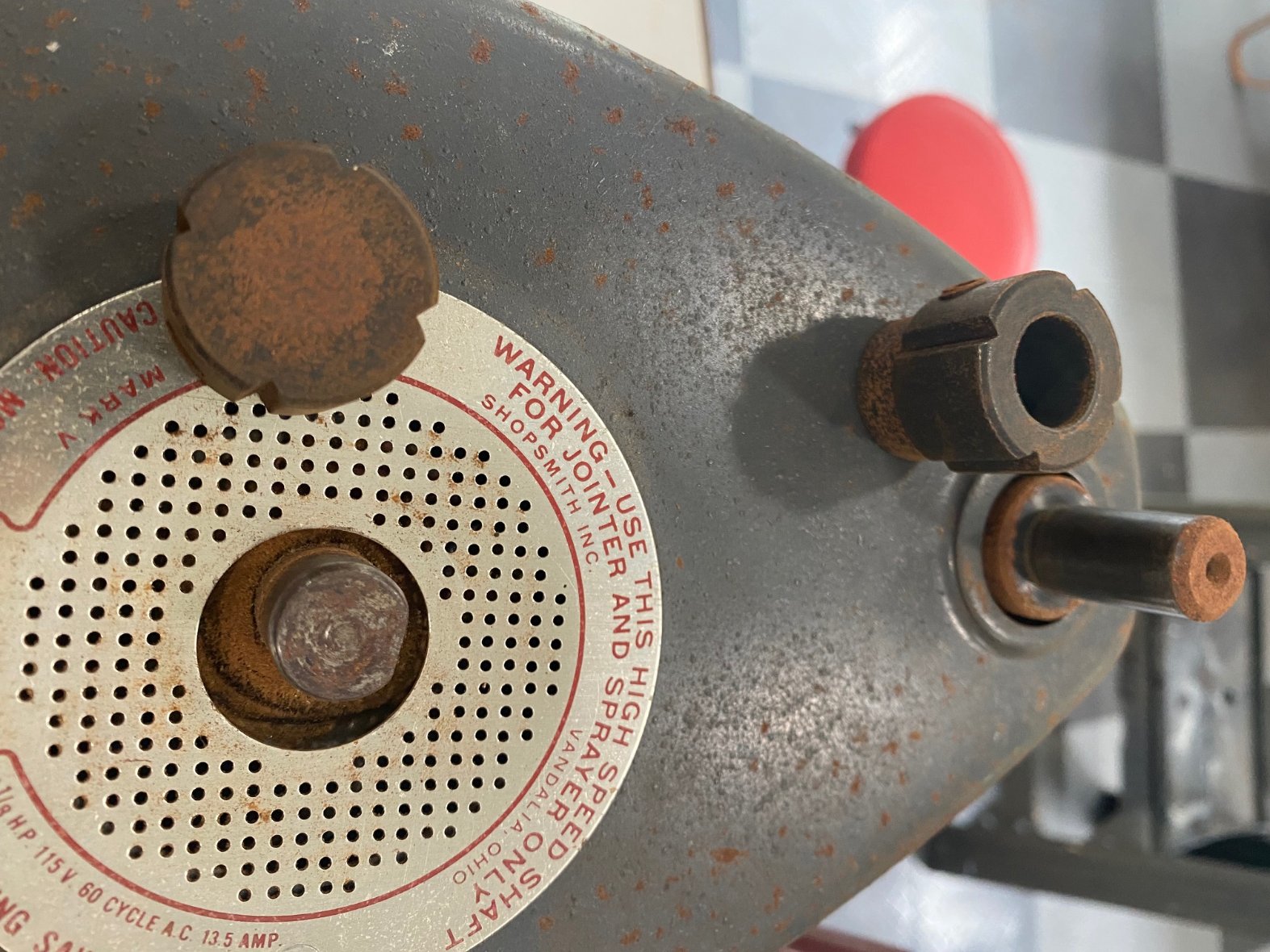

I took the plunge today, started in on the headstock, here are the initial photos. The motor does turn on, but I only let it go a second out of concern for those belts. Please speak out if you see anything I need to look into.

Posts: 35457
Other than oxidation and saw dust the only thing I see missing is the two screws and wide tinnerman nuts that secure the vent plate.
Examination of the speed control is needed.
I think it will clean up nicely! That rusted motor fan shroud will be a challenge. Evaporust/rags may be the answer.

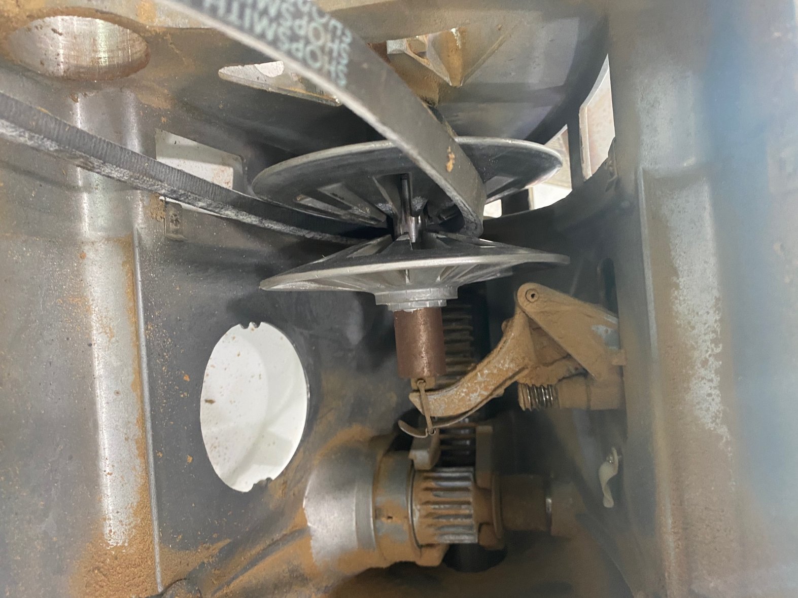

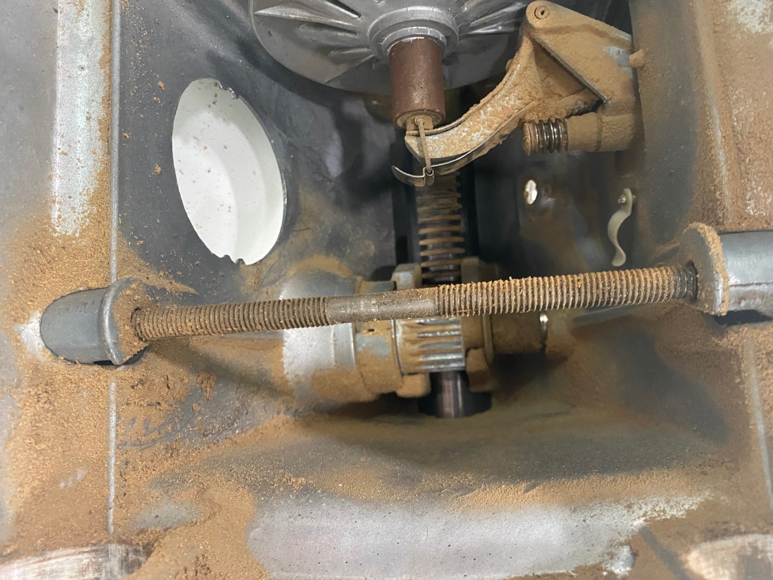

And what's inside.
Headstock 7.jpg (354.94 KiB) Viewed 837 times
Headstock 8.jpg (264.4 KiB) Viewed 837 times

JPG wrote: Thu Sep 16, 2021 3:43 pm Other than oxidation and saw dust the only thing I see missing is the two screws and wide tinnerman nuts that secure the vent plate.
Thanks, I have them. Found the nuts in the motor housing
Posts: 35457
Well that explains the shiny(?) stuff on the edges of the motor belt.(migrated from idler pulley sheaves).
Insides also look like great progress will be attainable.
I think you gots a good un.
