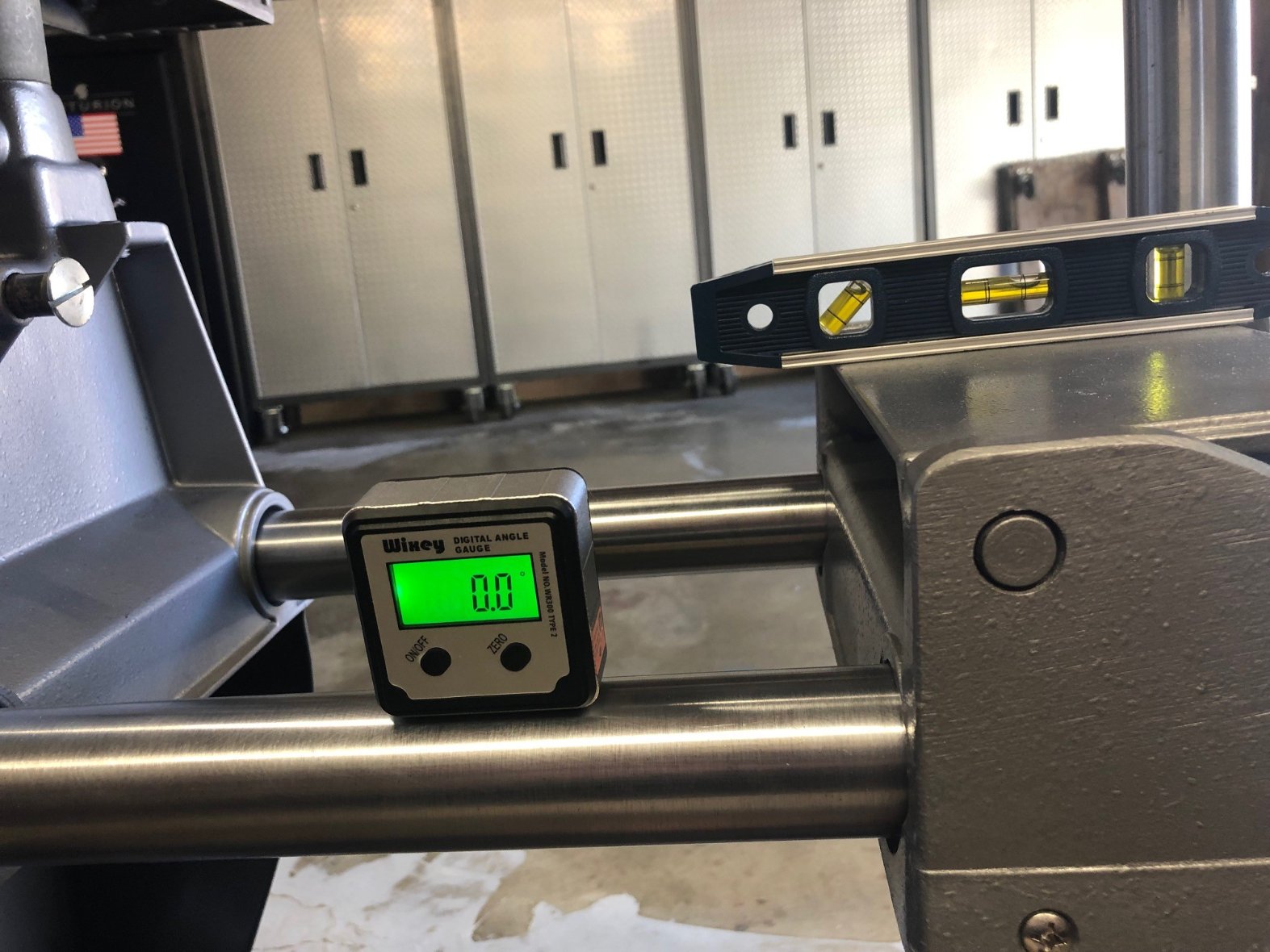

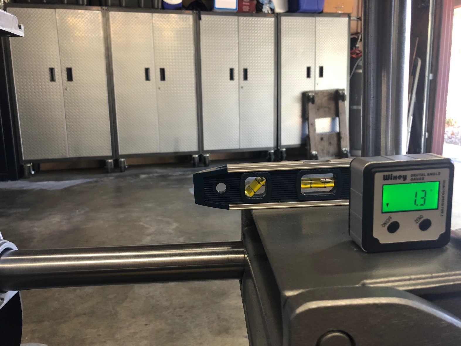

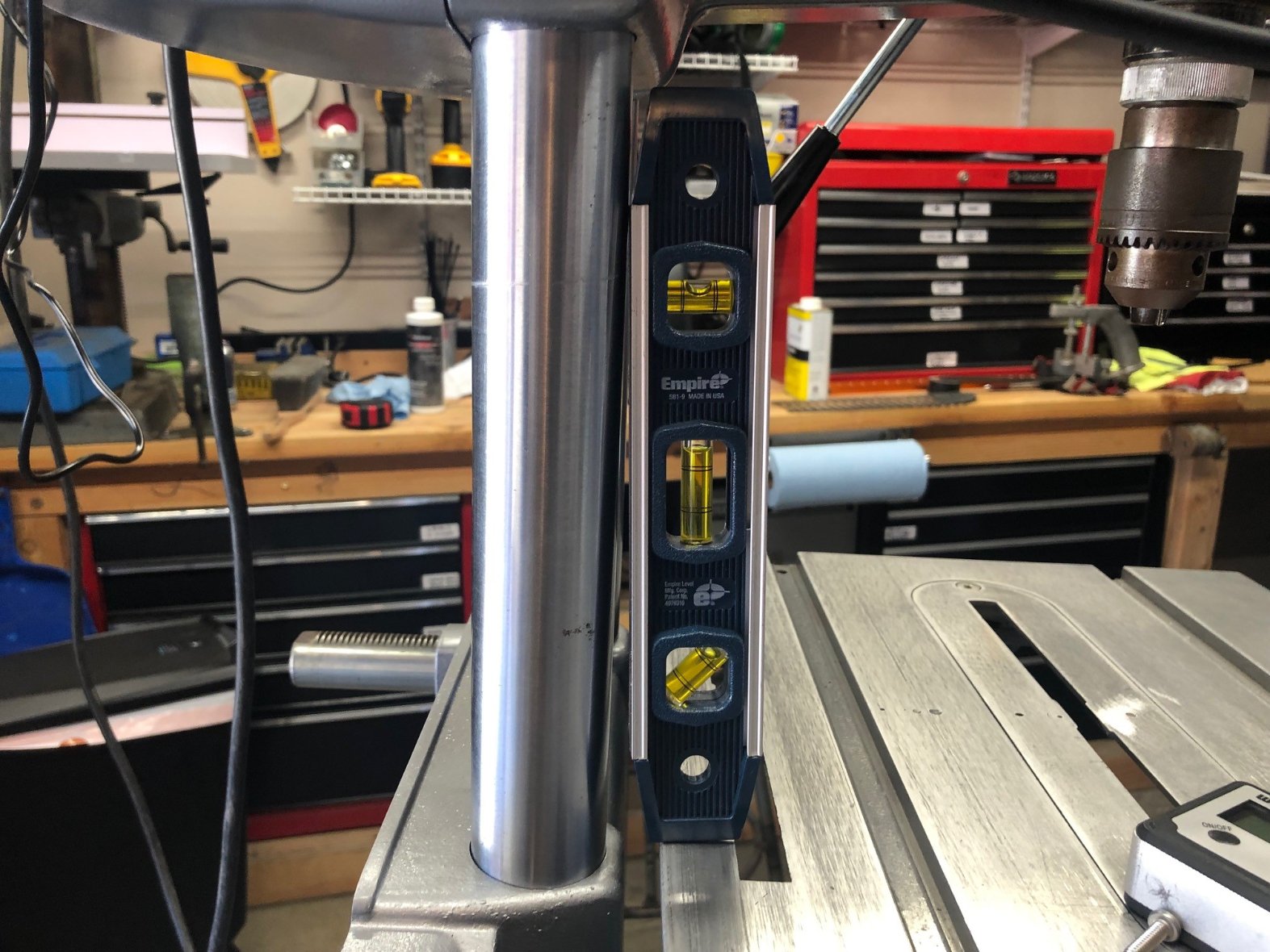

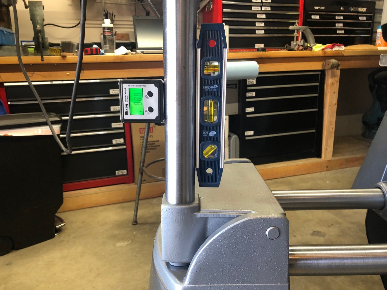

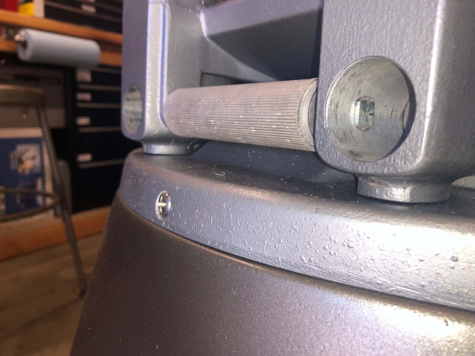

Dusty, John and others here are some additional pics but it's pretty simple I think. The way tubes are 88.7 degrees from bench tubes, not quite a right angle. The why may be by design or operator error in reassembly. Either way, I will be disassembling, reassembling, shimming, grinding or whatever it takes to get it to 90 degrees. It works spectacular right now and is the best, most versatile press I have ever owned. I cant have it 1.3 degrees off, its just my dumb nature I guess.
I will also drill the lock set hole deeper to set lock in a more "permanent locked" position. This is as it should be for me. That's my story and I'm sticking to it.
Thank you one and all for the kind words and assistance which are greatly appreciated

Weird. I'm sure others have pointed out that the design is for it to go slightly beyond vertical.
