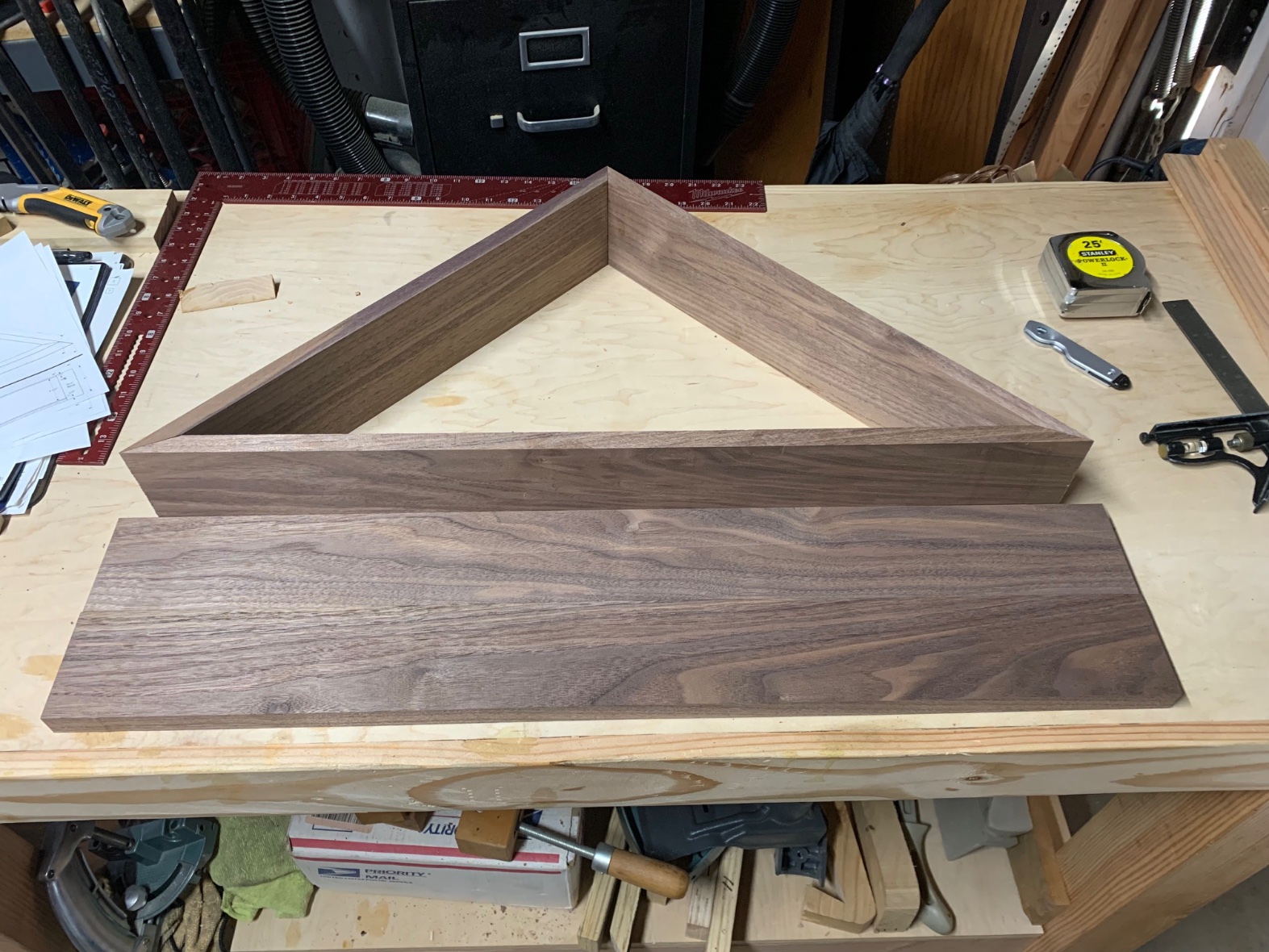

I really appreciate all the suggestions and experience shared here. Early on I decided to go with the design shown in the video found on the Woodworkers Guild of America’s site (link found in my first post, I believe). Although they did not include an actual plan or drawing, I used their methods to draw out my own using the dimensions of the flag that will go in this case. Even though I made my own drawing, including all dimensions, I stupidly forgot that I had the side dimensions and tried their method of cutting the 22.5 deg miters and then laying out the wood to determine the length of the side boards. The problem is holding the parts adequately to mark the upper length of those boards, so when I was making my prototype, I ended up with the gap seen in my last photos. For my cuts on the walnut I used the dimensions from my drawing, and added a little bit. They came out exactly how I had hoped. They are just a bit long, so a little sanding on the conical disk will help me do the final fit. It is coming together after.
Lower angle to better see the wood grain
High angle to see fit

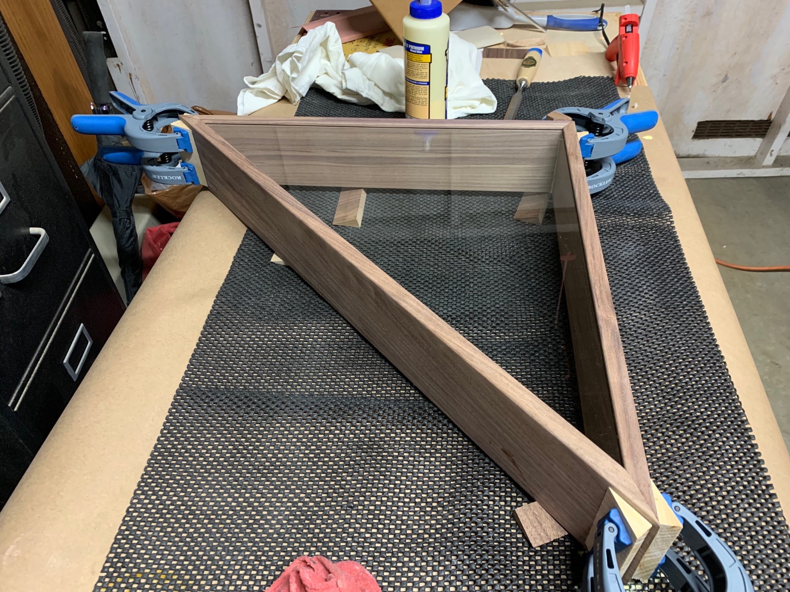

More progress… it’s glued, so I am now committed!
Waiting for the glue to cure, hoping my miter flaws aren’t too distracting when I’m done.
