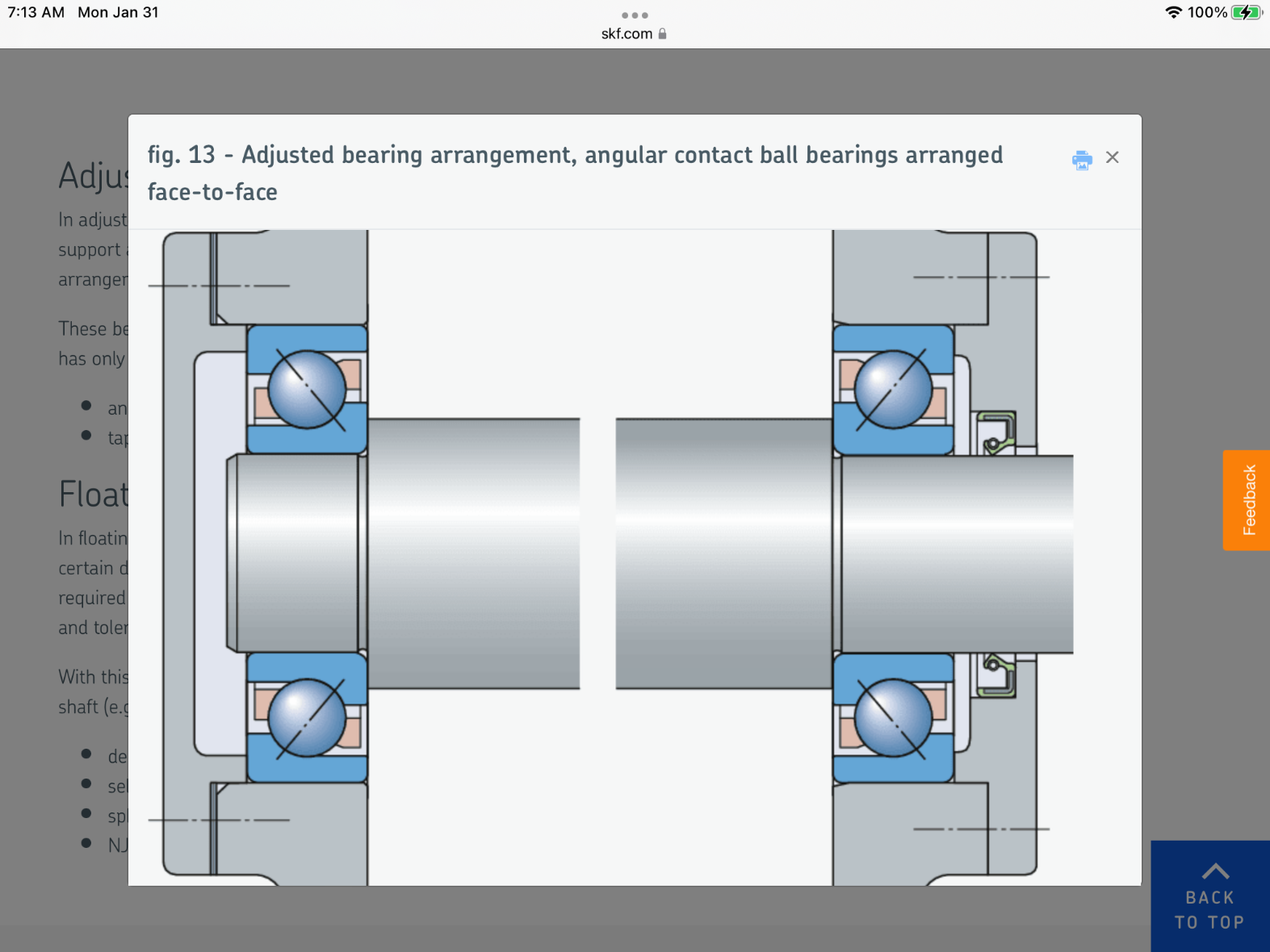

I have decided I've found a flaw in the design of the eccentric for the idler shaft. The bearings specified are being controlled laterally by the torque of the nut on the threaded end of the shaft. A ball bearing, or split race set of bearings like used here with the spacer collar is not the right type of bearing for axial pressure to align. It would be better to have the arrangement as is found on all tractor wheel hubs, with an inner and outer tapered roller(Timkin style) where the pressure from the pinch nut is applied to the thrust faces of the tapered bearings. I'm considering changing the type of spacer in between the two bearings from standing off the outer race, to a smaller dia spacer that would maintain distance of the pair of inner races on the outside and inside bearing pair.
Or, alternately I could use both spacers providing that they were the same thickness so there would be no side/axial load on the bearing balls, just torque from the end nut compressing the first inner race, the inner spacer, the second inner race, and finally up against the snap ring adjacent to the tapered sheave. These bearings are designed for radial loads, and they are going to do a fine job of that with the tension from the two belts, but the axial load from the nut torque is designed to deform the bearing race on either the inner or outer or both of each bearing.
If I were a real mech engineer, I would have the eccentric stepped for the tapered outer race, and convert over to tapered Timkin set. I might even thread in a zerk fitting where the set screw goes, and maintain it with grease every 500 hours. For future consideration. It wouldn't take much of a step in the eccentric to make a tapered bearing race work there.

I don’t know any specifics about the bearings in question, but tapered roller bearings aren’t the only type that are designed for axial thrust loads. You may have angular-contact ball bearings, which are indeed designed for that application. And IIRC, even (non-offset) deep-groove ball bearings can be used for light axial loads. This isn’t the sort of thing that I’d expect Shopsmith engineers to get wrong.

Yes, I'm aware of angular thrust bearings. That would be a third choice after tapered Timkin rollers. Based on what I found in my idler shaft, the bearings in there were destroyed mostly due to axial loads imparted by the torque on the end nut. If that type of arrangement were decided on and they use deep groove ball bearings, they should have a very light limit on the retaining nut. Sadly, It appears Shopsmith(Magna) decided that the bearing was 'good enough', or maybe that the idler bearing job was beyond the service level of owners.

My 'opinion' of the purpose of the nut is to eliminate end play only. I do not think it is intended to apply pressure against the bearings. The inner 'stop' for the bearings is a c-clip. Since the anti-rotation washer is present I think my opinion is verified(the nut is NOT intended to be torqued past taking up the end play.

That would be the sensible method. Only a few inch-pounds of torque, and apply the anti-rotation tabs on the captive washer. I'm going to use the old inner race bearing as the shim between bearings to maintain any axial torque on the inner races of the new bearing against the C-clip. This will insure that little or no torque is applied across the bearing races or balls.
