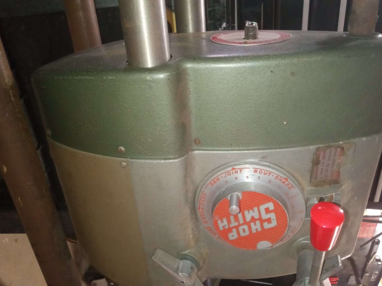

1955 Mark 5 Greene "A"
Needs Un-Gilmer'd and some love.

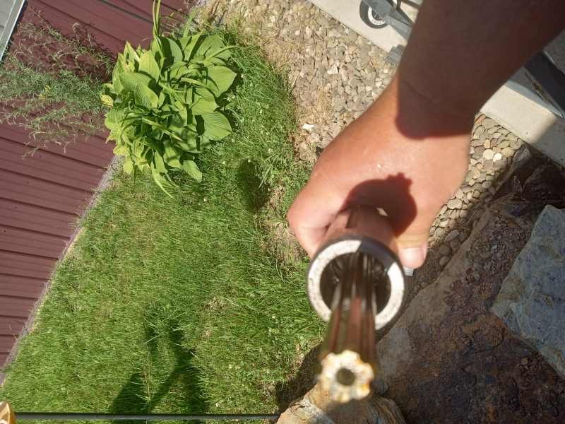

I have pulled my Quill from its holder (sounds personal) and determined I have in fact a update one with 2 twin bearings, happy about that. It is clean but dry, in need of Wax.
I have watched many video's that show pulling the end cover to do oil and cleaning around the shafts and every one I have seen had 2 Philips screw. Oh not mine, it has 9.
