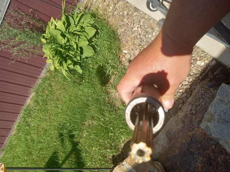

I have pulled my Quill from its holder (sounds personal) and determined I have in fact a update one with 2 twin bearings, happy about that. It is clean but dry, in need of Wax.

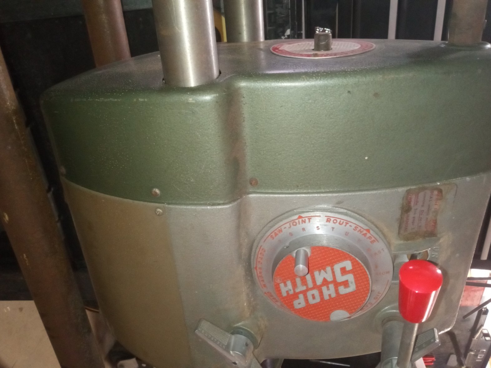

I have watched many video's that show pulling the end cover to do oil and cleaning around the shafts and every one I have seen had 2 Philips screw. Oh not mine, it has 9. :o My Greene has a gold bottom and sort of a grey top, with a greene end cover.
