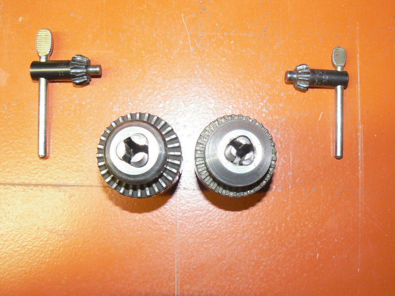

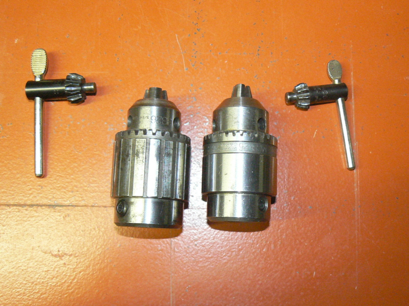

Here is a 3326(on the left) and a multicraft(on the right).
[ATTACH]3193[/ATTACH]
The keys are a [k32] for the 3326 and a [kk] for the multicraft. The k32 has a 1/4" pilot and the multicraft has a 9/32" pilot. It is interesting to notice the 3326 has a 3/8x16 set screw BUT with a 5/32" allen wrench hole. The multicraft came with a goldie purchased new in 1963. The 3326 was purchased for $0.50 at a garage sale(it WAS badly rusted and reluctant to adjust). Notice also the different 'gearing' on the keys and chucks.
The following pix are different views of the same two chucks/keys.
[ATTACH]3195[/ATTACH]
[ATTACH]3194[/ATTACH]
[ATTACH]3196[/ATTACH]

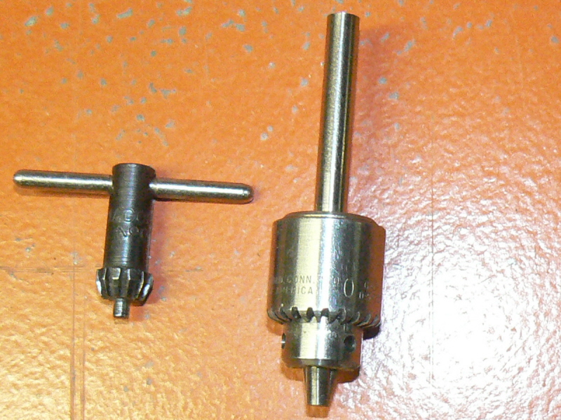

Just as a side interest for SMALL bits, the following pix is of a jacobs model 0 which has an adjustment range of 0.0 to 5/32". The rear shaft is 1/4".
[ATTACH]3197[/ATTACH]

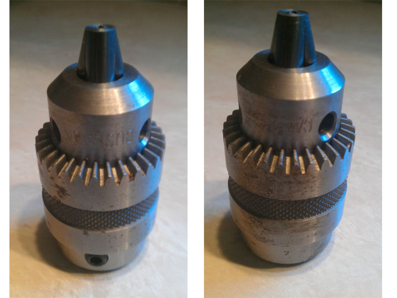

I have what appears to be the same chuck that Tim posted pictures of. Mine is bored all the way through and has same appointments and dimensions, but it lacks the shopsmith logo. Jacobs said that Tim's chuck is not a Jacobs, and I assume mine is not as well. The part above the cogs (in the last picture standing upright) is taller than a Jacobs chuck.
My Shopsmith is a Mark V of about 28 years old that I have fully cleaned, painted, oiled. It works beautifully... but my chuck is keyless. Tim, if you are still around, did you find a key?

My 83 500 came with a Cushman Chuck #C13LS (capacity 2 - 13mm or 5/64 - 1/2") I suspect yours is they same as mine. I haven't used mine since I bought it a few weeks ago, it has some surface rust in a few spots need to give it an evaporust bath and clean it up. It is solid and you cannot see through it like some of the other chucks. Wonder when they started changing chucks or did they offer both types when the machine was purchased?
